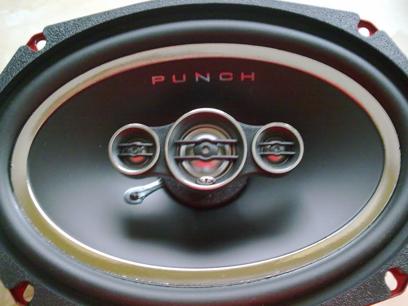

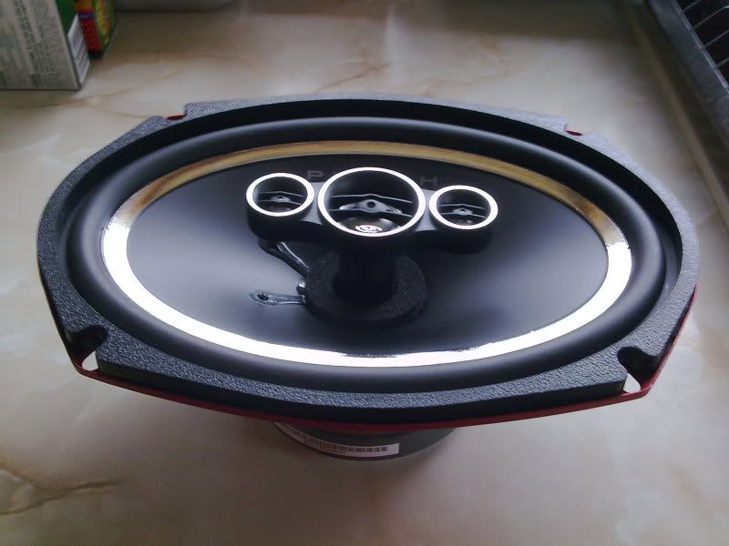

glanza179 Posted November 23, 2009 Author Posted November 23, 2009 well as i had no sounds in the car due to standard speakers all going pop lol i treated myself today to a set of rockford punch 6x9s in the rear shelf and replaced the front 4" speakers with matching rockford punch speakers alsoJim Quote
Craig_N Posted November 23, 2009 Posted November 23, 2009 Car is just awesome seen it a JAE My speakers have just gone pop aswell are the standard 4'' speakers in the dash hard to replaceCraig Quote
glanza179 Posted November 23, 2009 Author Posted November 23, 2009 no mate real easy.there are 2 10mm bolts at the bottom of the trim panel, then on the passenger side 3 screws at the top of the glove box, on the driveds side there are 2 screws at the topJim Quote

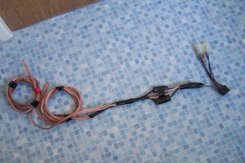

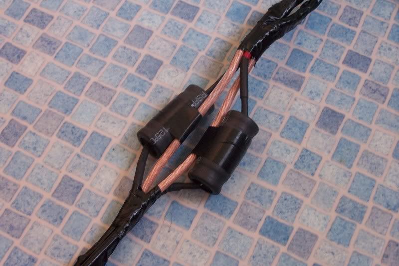

glanza179 Posted December 5, 2009 Author Posted December 5, 2009 been doing a bit more wiring today went to a local ice specialist and got some bass blockers, i also had a spare toyota to ISO adaptor harness so did a little harness alterationspeakers sound great now Jim Quote
Nanglebadger Posted December 5, 2009 Posted December 5, 2009 i have no idea what i'm looking at, but i applaud your DIY skillzzzzzzzz!Phil. Quote
glanza179 Posted December 6, 2009 Author Posted December 6, 2009 thanks Mr Badgeryour looking at a stereo adaptor harness with the front speakers re wired with bass blockers to stop distortion at higher volumesJim Quote

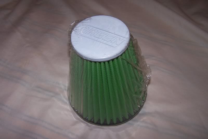

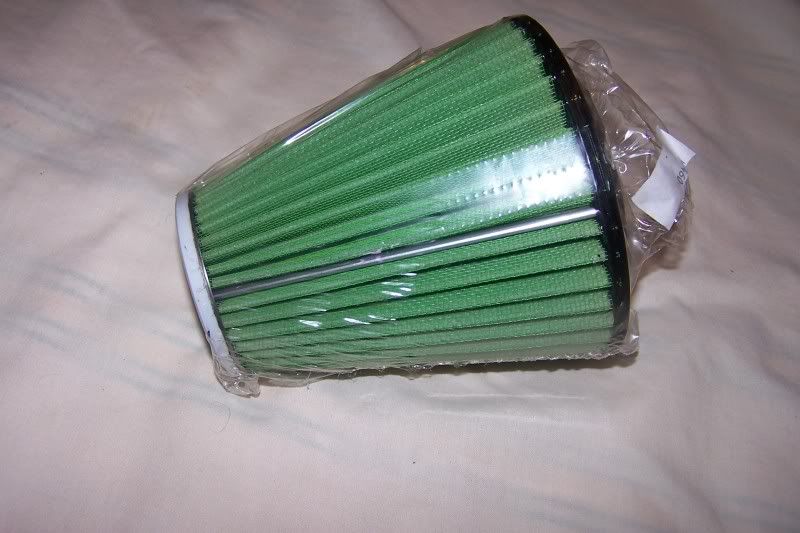

glanza179 Posted December 10, 2009 Author Posted December 10, 2009 well only took 3 months but my new filter finally showed up, shame come the new year it may become obsolete Jim Quote
