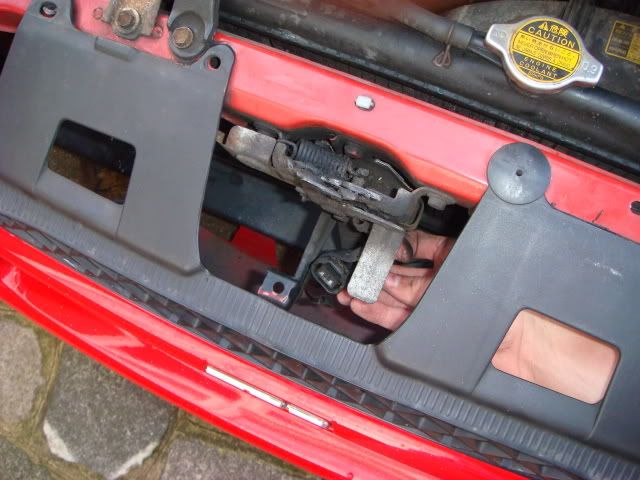

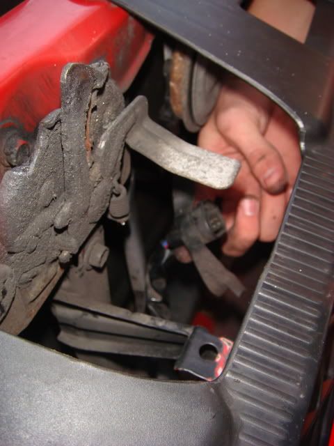

shaneyb Posted December 14, 2009 Author Posted December 14, 2009 Just checked the fuse and it looks fine.Does anyone know where this is meant to go? Its coming out from the horn. Quote
DavidAshton Posted December 14, 2009 Posted December 14, 2009 Its a plug for something else that im guessing was an optional extra, air con or fogs maybe, either way its always been unplugged and has nothing to do with the horn. Quote
shaneyb Posted December 14, 2009 Author Posted December 14, 2009 Hmm, Mot is in 6 weeks. Its not a good look. I thought I was onto something with that plug haha. Quote
