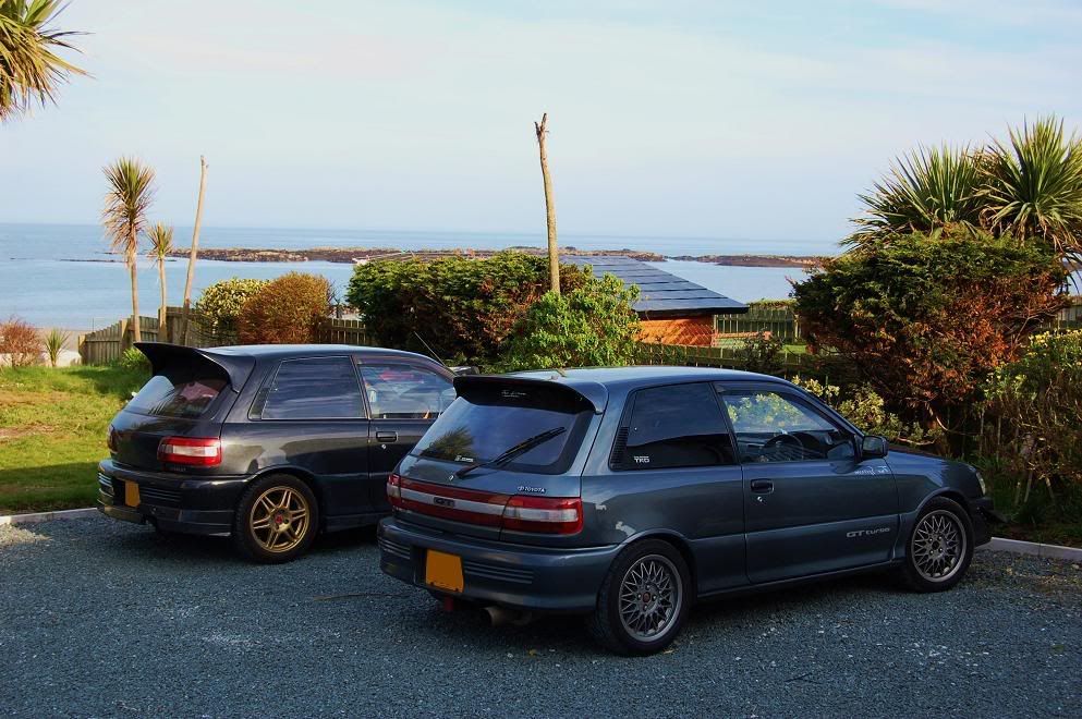

Keri-WMS Posted November 29, 2010 Posted November 29, 2010 I think the 15" E30 BBS is an ET 24 or 25, so you might run out of arch room? Starlets are about ET 35 normally?Here's a 15" BBS/E30 WMS kit (280mm) gratuitous shot: Quote
Turkish91 Posted November 30, 2010 Author Posted November 30, 2010 Definitely from a Beemer Turk, I leave the centre caps off as they don't suit the look at all.Haven't seen them on any EP91's except Phil's in the above pic and that was only temporary. I've used them on two of my GTs so far :Because they are a common wheel they can be found for cheaper money too. JayThey look awesome man, definitely gonna be looking for a set after payday! You've just made my mind up with them pics! And yeah the centres wouldnt be staying on!!!I think the 15" E30 BBS is an ET 24 or 25, so you might run out of arch room? Starlets are about ET 35 normally?Here's a 15" BBS/E30 WMS kit (280mm) gratuitous shot:So what are you saying Im gonna need some spacers? I dont understand offsets that much tbh! Quote
Keri-WMS Posted November 30, 2010 Posted November 30, 2010 So what are you saying Im gonna need some spacers? I dont understand offsets that much tbh!Nope, the other way round - you need "anti-spacers"! The E30 wheels will stick out about 10mm further than Starlet offset ones as far as I know. Might be ok?Also E30 BBS's have flat spokes, where Jaystar's ones are curved back a bit. Probably by 10mm! Quote

Keri-WMS Posted November 30, 2010 Posted November 30, 2010 lol - right lets get really geeky, the "15 inch E30 BBS" has three versions:1 - Cast by BBS2 - Cast by Alu3 - Cast by FPSThey are all "the same" as far as BMW and 99% of people are concerned, but there are differences to the back of the spokes and the logo under the cap etc! Quote
Turkish91 Posted November 30, 2010 Author Posted November 30, 2010 LOL geeek! So the general consensus is then that they will fit, although may have issues with them sticking out the arch a bit too far?A mate of mine is currently photoshopping them onto my car too Quote
