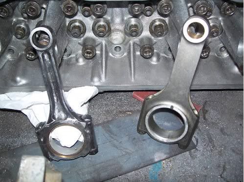

jonog Posted December 6, 2010 Author Posted December 6, 2010 Hi once again onto the subject of the TRD cup engine here are some photos what do you all think? Quote

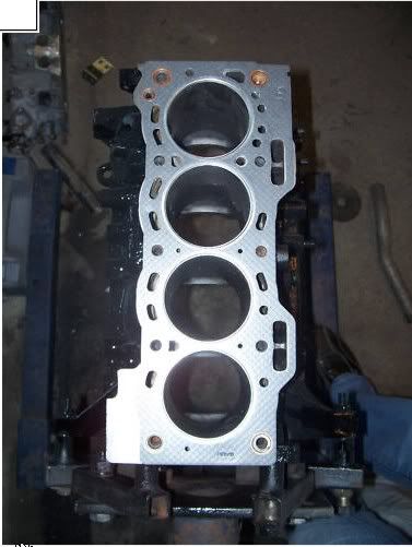

jonog Posted December 6, 2010 Author Posted December 6, 2010 Here are a few more pics as you can see the engine needs some work to put back together but on fuel injection and the right compression, about 13:1, it should eligibly be good for 173bhp including the remap. Don`t forget this is the TRD cup engine used back in the 80`s for racing and rallying. Quote
ste91 Posted December 6, 2010 Posted December 6, 2010 are you forging it too ??Just look at the pics of those pistons and rods above...13:1 is pretty high compression! What's this engine supposed to rev to? Quote
jonog Posted December 6, 2010 Author Posted December 6, 2010 Hi l am sorry not to reply sooner but the owner has not said to what it will rev to but has said that the crankshaft is a hollow item, the rods are H-pattern specially machined for this engine and the block has been likewise modified.The pistons are machined 2EE without rings at the moment and the block has been planed by 2mm thus bringing about the high compression ratio with the right head. Quote
whiteglanzav Posted December 6, 2010 Posted December 6, 2010 Just look at the pics of those pistons and rods above...13:1 is pretty high compression! What's this engine supposed to rev to?there are 2 different rods and those pistons dont specifically look forged Quote
jonog Posted December 6, 2010 Author Posted December 6, 2010 Yes well spotted they are merely for comparison! and l did not say that the pistons were forged, that would be a nice addition.Can anyone shed some light on this engine as regards figures from TRD or better still maybe a brochure from the era listing the mods made. Quote
