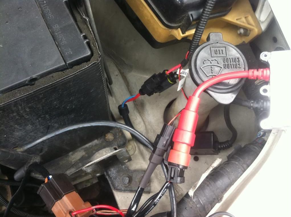

nazzurro19 Posted May 27, 2011 Posted May 27, 2011 if you mean the white clip which connects into the car headlight loom there is only one on mine also and mine works perfectly get a pic of what ya struggling with buddy mine went live to battery earthed it to under the washerjet bottle and then earthed the other side near the battery tray , then clipped the one white clip into my car head loom , tucked the other one from the other headlight away and wallah Quote

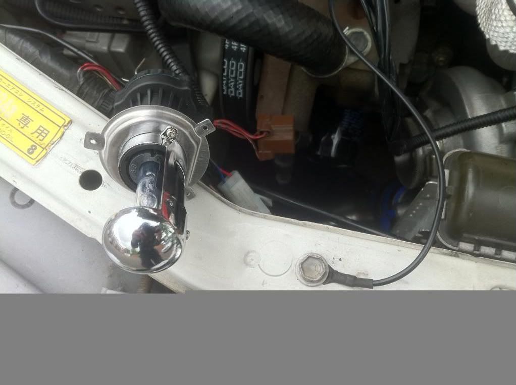

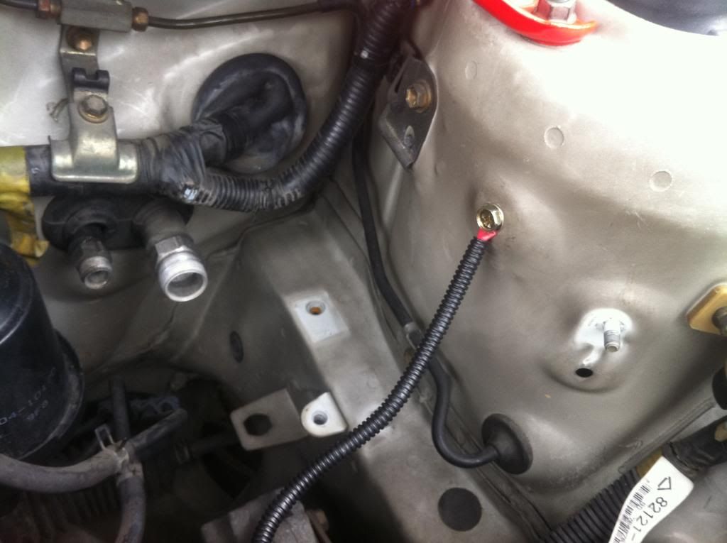

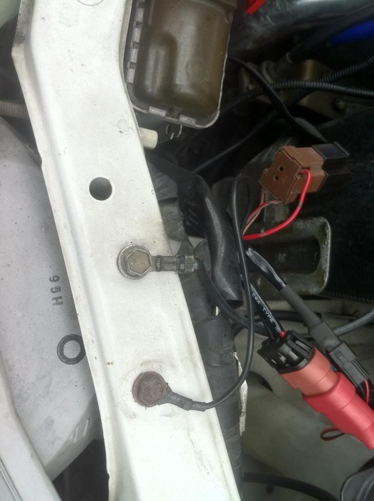

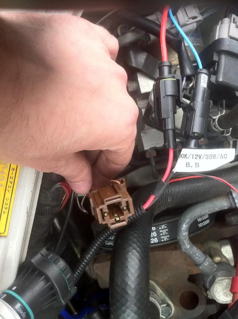

iamlegend Posted May 27, 2011 Author Posted May 27, 2011 heres hows its set up ......am i missing somthing?only thing i can think is the kit been faulty as i kno these HIDs can be dodgy at times...earth:main powerother earthother earthconnected upcar loom left open since no hid loom to go in Quote
TrisK Posted May 27, 2011 Posted May 27, 2011 that one with the red on the end, that you have bolted to the strut tower, is meant to go to the positive on the battery? Quote

iamlegend Posted May 27, 2011 Author Posted May 27, 2011 right we have one hid working but not the other and yes i have connected that power up earth to the battery but whys the other one not working now lol ffs... Quote
iamlegend Posted May 27, 2011 Author Posted May 27, 2011 weyheeyyy we have lift off! about bloody time ahahhahahait was the earths ! now the only thing did people put the rubber casing back on as it seems like theres no way of it going to fit back on the hid is mucho fatter! wouldnt mind it back on tbh!trisk yea it doesnt work in the dash when have full beams on! do these act as full beams as well or what? Quote
hill_bill10 Posted May 27, 2011 Posted May 27, 2011 which side of the car is your little black box fitted? from what i remember about them one headlight simply takes a signal from the other one, so if you have fitted it to the wrong headlight the other wont get a signal, try swapping sides and see if that works Quote

hill_bill10 Posted May 27, 2011 Posted May 27, 2011 ignore everything i just said, had another look at your pics and its in the right side, fail on my side, still a bit hungover from last night haha my bad Quote
