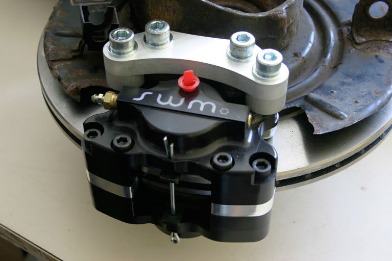

Keri-WMS Posted May 3, 2012 Posted May 3, 2012 it would most likely be on the outside of the caliper no where near any load bearing parts.....On WMS 4 pot or OEM 2-pots?The 262.5mm PDF I put up uses the same T20 caliper that all our Starlet kits so far use.However the WMS 2-pot (T10) one I mentioned for the 254mm proposed WMS kit is an opposed 2-piston, not a 2-piston slider like Toyota use. Our T10 caliper is like this: Quote

Keri-WMS Posted May 3, 2012 Posted May 3, 2012 True - the big advantage of the T10 are the lugs are closer togeither, so there's room to squeeze them onto the OEM disc and into smaller wheels. Sadly half the pistons doesn't mean they cost half as much to make! Quote
