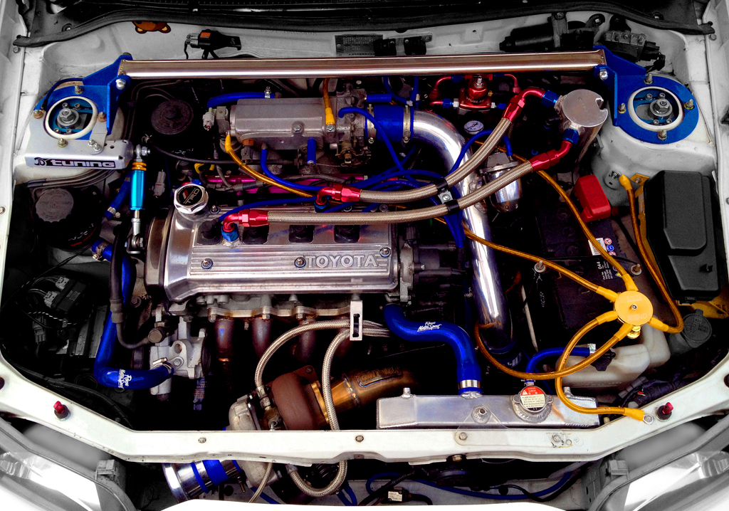

grum-glanza Posted May 22, 2012 Posted May 22, 2012 over the last few weeks i have been getting packages and today was the last package to arive my manifold and downpipe people say a picture speaks a thousand words so herefirst to come was my new turbothen my back housing for the turbo .64 t31then my wastegateand last but not least my manifold and downpipe Quote

grum-glanza Posted May 22, 2012 Author Posted May 22, 2012 (edited) You lucky shit, the same turbo i'm going for near enough, although i'm going for the next one down, the 60r. Although i'm going to be running the tial V-band stainles turbine housing.You go for the wepr kit?Looks posh mate! You won't be dissapointed.this a wepr godzilla kit? looks smart...going onto a 4e?ya its the wepr godzilla extreme kit well just the manifold and downpipe i thought the garrett gtx turbo would be a better turbo, its on a 5e i have ran into a small problem i realy hope someone might have an ideaits not even close to fitting Edited May 22, 2012 by grum-glanza Quote
mattyD Posted May 22, 2012 Posted May 22, 2012 did you get the kit made for a 5e? i know the measurements of the block etc are slightly different Quote
grum-glanza Posted May 22, 2012 Author Posted May 22, 2012 em.... no i didnt its only one inch of a difference in the blocks the manifold is fine and the turbo sits fine its just the downpipe catches the rad and i dont no what to do Quote
grum-glanza Posted May 22, 2012 Author Posted May 22, 2012 its a custom triple core brass and copper rad all the messurments were taking from a 1 liter starlet rad which i was running for awhile Quote
Ryan-11 Posted May 22, 2012 Posted May 22, 2012 (edited) that could well be why it doesnt fit, i think they may be made to suit a civic radiator, maybe worth giving Sacha a PMNice choice in turbo by the way ;) Edited May 22, 2012 by Ryan-11 Quote
mattyD Posted May 22, 2012 Posted May 22, 2012 what he said ^^ maybe try a triple core civic rad mate Quote
scottyb Posted May 22, 2012 Posted May 22, 2012 pretty sure ive seen some of these big top mount kits with part of the bar cut out to make space for the turbo, so you may have to cut it back a bit to make space? Quote
Socks Posted May 23, 2012 Posted May 23, 2012 This is why my GT30 was angled a bit. To allow clearance for a 3" downpipe which clears the Rad!Tbh tho, looking at where your radiator sits in relation to the front light support bar, a Civic Rad wont fix your problem, as the downpipe (further down) goes alot further out! My guess is you will have to mount a radiater in front of the light support bracket! Quote
Ricky@Race-Tech Posted May 23, 2012 Posted May 23, 2012 I'd get intouch with Wepr, It looks like they have made an error, which does happen at times. I'm sure they will sort you out if you return it. Quote
ryan lang Posted May 23, 2012 Posted May 23, 2012 the difference in the 4e and 5e blocks is 1cm in height Quote
grum-glanza Posted May 23, 2012 Author Posted May 23, 2012 i got on to sacha he says use the civic rad but just looking at the pic of socks bay it wont work either his rad is coming out just as far as mine is now i think i need mine angled but i cant do that either because the turbo wont go under the top bar this is turning into a nightmare for me Quote
00joeindastarb0 Posted May 23, 2012 Posted May 23, 2012 Your rad does seem further over to the drivers side than Socks but it doesnt look to be the issue. Quote
grum-glanza Posted May 23, 2012 Author Posted May 23, 2012 i think i may have a plan right im thinking of geting a rad made up to go under the top crash bar basicly where you bolt the rad, my rad will be under there behind the front mount and in front of the engine bay, stuck in the middle it looks like a twin core would fit there Quote
00joeindastarb0 Posted May 23, 2012 Posted May 23, 2012 Why alter your rad location for what just might be a fabrication error Quote
morgey Posted May 23, 2012 Posted May 23, 2012 Tbh looking at what youve got space wise. the under slam panel rad looks like the best option and will look cool at the same time.Altho a slightly angled turbo wud work on a 4e I guess that lil extra height of the 5e has kinda shot u in the foot so to speak regarding spacing between turbo n slam panel. Quote
Ricky@Race-Tech Posted May 24, 2012 Posted May 24, 2012 Tbh looking at what youve got space wise. the under slam panel rad looks like the best option and will look cool at the same time.Altho a slightly angled turbo wud work on a 4e I guess that lil extra height of the 5e has kinda shot u in the foot so to speak regarding spacing between turbo n slam panel.It would mean different runners but you could do it. Quote
