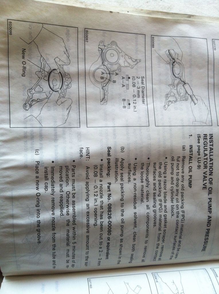

Taggy Posted June 14, 2012 Posted June 14, 2012 I have just come to the realisation that I havent put instant gasket on the rear of my new oil pump when i fitted it, looking at my old one i can see it had gasket on it. Is it going to leak like a sive if i dont take it off and put some on the back of it? Quote
turbo Grant Posted June 14, 2012 Posted June 14, 2012 I would say it will leak. Think there is 2 types one with an o-ring and one that is stuck on Quote
Russleh Posted June 14, 2012 Posted June 14, 2012 i thought the type without the oring was for the block that has the o-ring in it. But as a precaution i went round the outside edge of the whole thing when doing mine. Quote
TrisK Posted June 14, 2012 Posted June 14, 2012 I have just come to the realisation that I havent put instant gasket on the rear of my new oil pump when i fitted it, looking at my old one i can see it had gasket on it. Is it going to leak like a sive if i dont take it off and put some on the back of it?i know its a bastard, and will be time consumingbut you wil actually cry if your forged 5e grinds to a halt due to lack of oil Quote
Taggy Posted June 15, 2012 Author Posted June 15, 2012 I still cant believe i missed this, i gotta take the whole bloody timing side off again now arghhh! Quote
bucketep91 Posted June 15, 2012 Posted June 15, 2012 Could have been worse mate, u might have forgotton all about it and done some damage. Quote
Taggy Posted June 15, 2012 Author Posted June 15, 2012 well at least i didnt fit it into the car and then realise i had dont that!! Quote
glanzagee Posted June 15, 2012 Posted June 15, 2012 May help you don't just put sealant on thickness matters Quote
