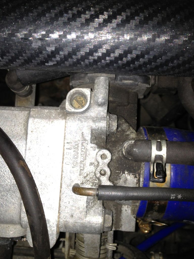

Jordk Posted February 9, 2013 Author Posted February 9, 2013 Is it this rusty screw at top of picture here? Quote
Jordk Posted February 9, 2013 Author Posted February 9, 2013 Awesome shall have a play and see. If not the throttle body will be coming off Quote
