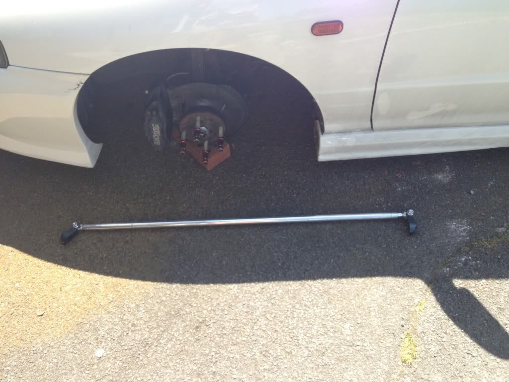

Hawwy Posted July 11, 2013 Posted July 11, 2013 Minor mods to fit it. I have one mate works greatWhat mods to fit it out of interest
russ78 Posted July 11, 2013 Posted July 11, 2013 (edited) redrilling the holes bigger and longer seatbelt bolts by all accounts buddy Edited July 11, 2013 by russ78
Banbury Glanza Posted July 11, 2013 Posted July 11, 2013 Bigger holes drilled adjusting bolts on the brace need cutting down and screwing right down and the seat belt plastics need cutting. Standard seatbelt bolts fit fine
Ep'd Posted July 11, 2013 Author Posted July 11, 2013 (edited) Adjusting bolts on the brace need cutting down in what way? Yh I've ordered one you legend! Edited July 11, 2013 by Ep'd
MARC MOSS Posted July 11, 2013 Posted July 11, 2013 Genuine cusco £65 plus postageIf your interested ping me a pm or txt on 07834183624
Banbury Glanza Posted July 11, 2013 Posted July 11, 2013 As in take them out and cut them down so they screw right in with out the nuts on them
Ep'd Posted July 13, 2013 Author Posted July 13, 2013 As in take them out and cut them down so they screw right in with out the nuts on themOk mate
