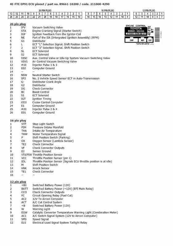

Glanza-Ben Posted September 10, 2013 Posted September 10, 2013 I've fitted a blitz sbc id in my car and need to wire the power metre into the speed sensor what wire is it on a ep91 Glanza v ecu cheers Quote
Glanza-Ben Posted September 10, 2013 Author Posted September 10, 2013 I'm thinking its connector 3 pin 11 if some one can confirm that it would be great Quote
morgey Posted September 10, 2013 Posted September 10, 2013 I wanna say the purple one.Its labled spd on the diagrams Quote
Rob H@RCH Engineering Posted September 10, 2013 Posted September 10, 2013 It's purple on the N/A I know that for sure! Quote
akyakapotter Posted September 11, 2013 Posted September 11, 2013 (edited) There you go Ben 12pin plug pin11 by the looks of it so yeah your right Edited September 11, 2013 by akyakapotter Quote
Glanza-Ben Posted September 11, 2013 Author Posted September 11, 2013 There you go Ben 12pin plug pin11 by the looks of it so yeah your right Ideal thanks mate Quote
