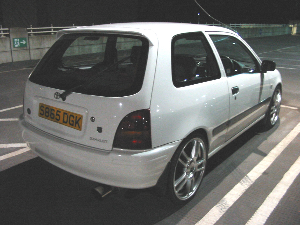

TRD_Starlet_08 Posted December 12, 2005 Posted December 12, 2005 Where do i start then i know you need to make it light as possible but where do i start knowing my luck ill rip the bloody car to bits ?? it needs a rally diet and im stuck if anyone could help my fat lil starlet please? Quote
Ivan Posted December 12, 2005 Posted December 12, 2005 hey,can we just confirm that you are after a rally "look" or do you want the perks of a rally car? i can tell you know which one is much cheaper but you may aswell stop pretending and do the real thing.Firstly you will need to strip the interior, get rid of the back seats, get a roll cage, harness and a set of 2 fixed non reclining bucket seats. Then i would relocate the battery to the boot to help out with weight distribution. You would want to probably remove all the wiring throughout the car that isnt needed (and there is alot of it). Under the car you would go through all the bushes, and replace them. Get a set of good shocks/springs or coilovers, sway bars, and what not.Get rid of those wheels, get some lightweight 16" rims or 15" rims.If you want to go the full monty then get some graphics all over the car, and get the spoilers on the front and rear (and sideskirts).Realistically, its not going to be a rally car just cause it looks like one and 9 times out of 10 its cheaper to buy a ready made rally car that someone is selling than to build it from scratch.I hope i answered your question...otherwise ill blame the lack of sleep (",)Ivan Quote
