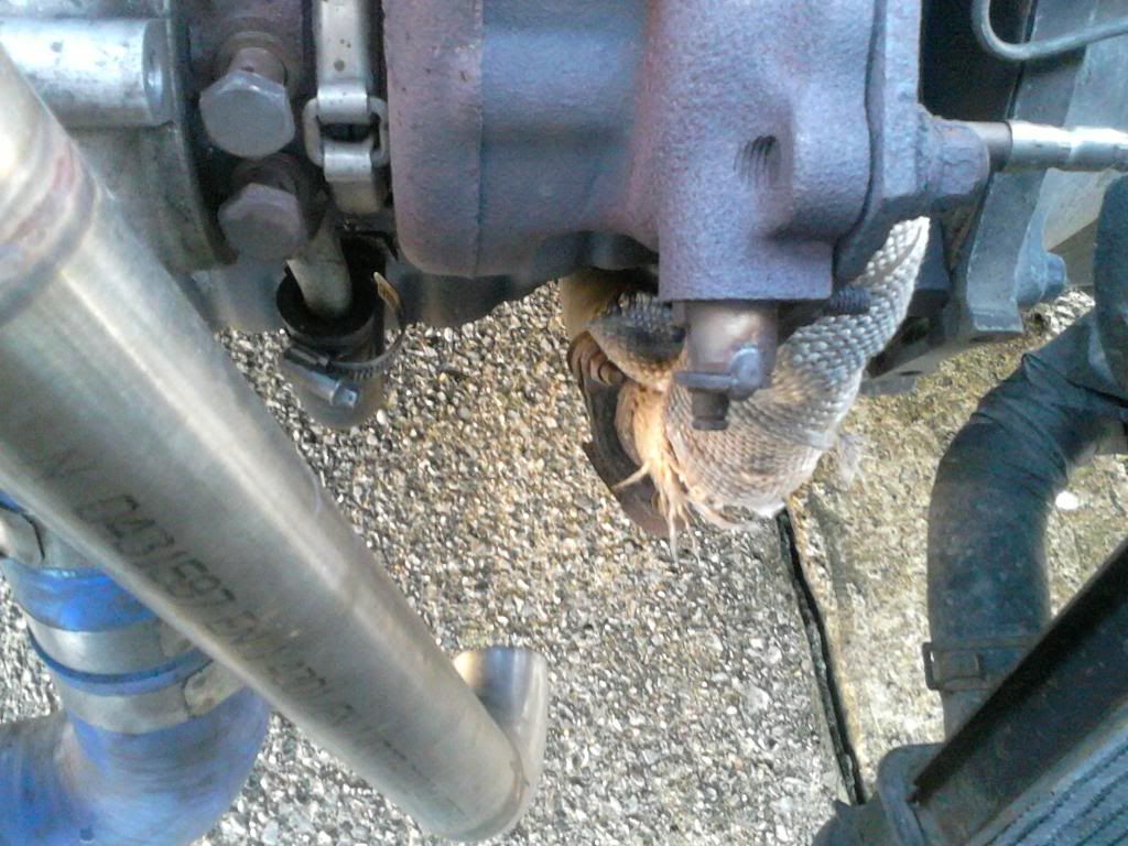

Ollieh17 Posted January 13, 2014 Author Posted January 13, 2014 Did a search and didn't find much information on this. I understand I have to weld the internal wastegate in order to use the external one.Ideally i'd like to use a different method which meant i could resort back to stock setup. Seen in another thread you can buy special brackets like an actuator to hold it shut? Or could I just weld the wastegate control arm in place which would make the weld easier to break than the actual penny welded Quote
Zeldoz Posted January 13, 2014 Posted January 13, 2014 Did a search and didn't find much information on this. I understand I have to weld the internal wastegate in order to use the external one.Ideally i'd like to use a different method which meant i could resort back to stock setup. Seen in another thread you can buy special brackets like an actuator to hold it shut? Or could I just weld the wastegate control arm in place which would make the weld easier to break than the actual penny welded On my TD04 i believe the arms been welded to hold the gate. I have heard of a bracket like you mentioned! Quote
Ollieh17 Posted January 13, 2014 Author Posted January 13, 2014 got a pic of how its been welded? Quote
Zeldoz Posted January 13, 2014 Posted January 13, 2014 Check my thread, you may be able to see from when i took pictures before fitting it? Quote
TurboTobz Posted January 13, 2014 Posted January 13, 2014 If yoy wanna revert get the bracket can easily be sorced on google Quote
Ollieh17 Posted January 13, 2014 Author Posted January 13, 2014 might be more effort to use a bracket than just welding and replacing the turbo after. As with the wepr kit the turbo has to be rotated Quote
triple j Posted January 13, 2014 Posted January 13, 2014 What I did was put a tak weld on the waste gate arm where the actuator arm sits on, get someone to hold it in the shut position and put a nice tak on between the moving parts, then when u want to go actuator all u need to do is run the hacksaw through the weld, if u want I will show a picture of mine, it's tidy and works well no need for a bracket. Quote
triple j Posted January 13, 2014 Posted January 13, 2014 http://i1229.photobucket.com/albums/ee475/pixievan/Mobile%20Uploads/DSC_0007_zpspe8uuu7g.jpg Quote
