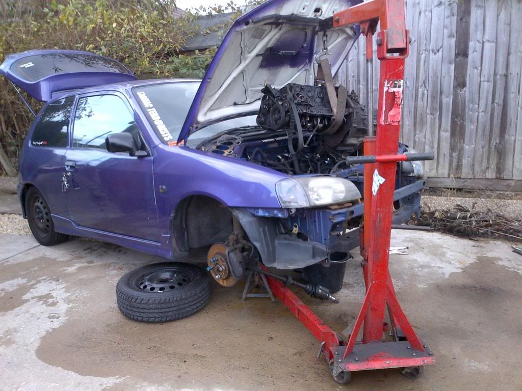

Cheers guys! Wasn't too taken on colour at first but has really grown on me I just need to sort the bodywork out. In the middle of painting The engine bay at the moment I'll get some more pics up later :)

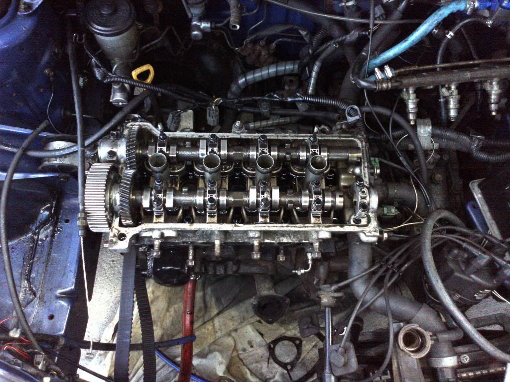

Started the tear down

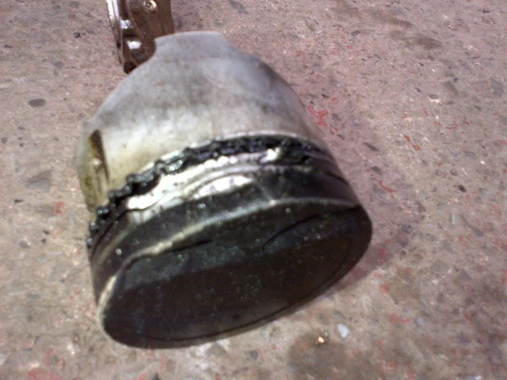

Think this was the cause!!

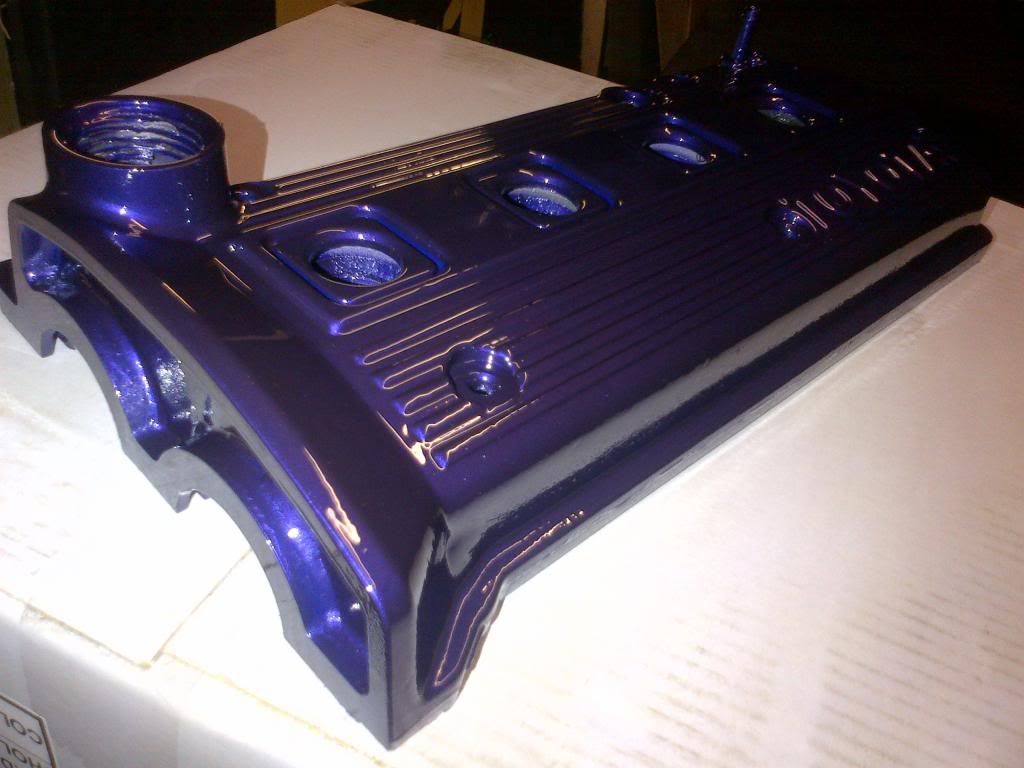

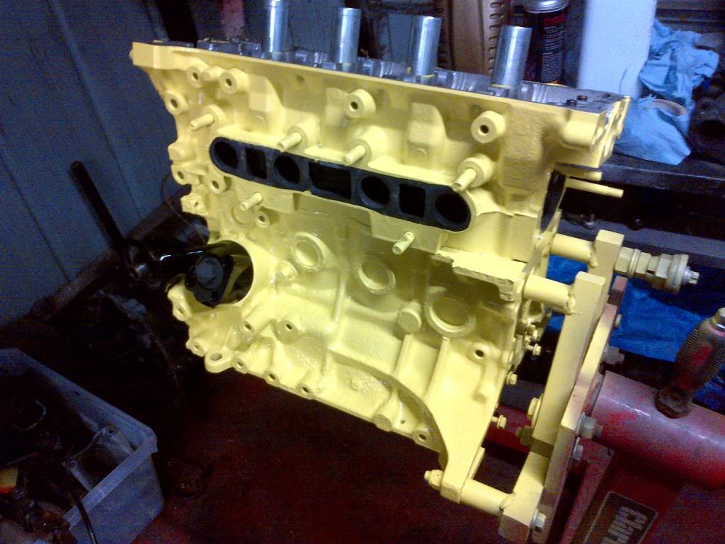

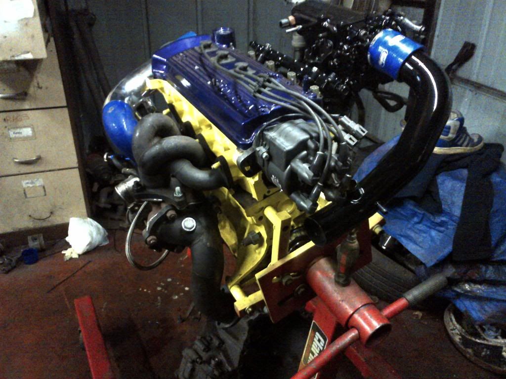

So stripped her down, got some pistons,rods, mains, bige ends thrust washers had the crank re-ground, all new seals, rings, athena head gasket, head bolts, head skimmed and pressure tested. Then began painting some parts up :)

I do like the colour although its a custom colour the previous owner had done and cannot seem to get a paint match anyhwere to touch up :( the engine bay is painted but its a slightly different colour now :/ and have just got the engine in ready for finishing touches and my loom when it arrives :D will update pics later
