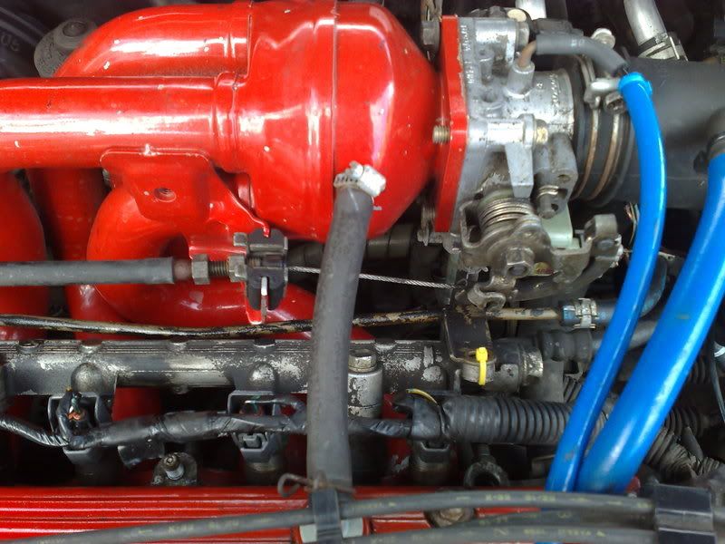

nic1.3 Posted December 3, 2007 Share Posted December 3, 2007 since this is in relation to rev'sive been told that you can adjust the idle revs (when it isn't running wit the automatic choke) by a adjusting a screw on the throttle body..... is this true???and could someone point me where to look for this screw because i can't find it Quote Link to post Share on other sites
Tintin_SR Posted December 3, 2007 Share Posted December 3, 2007 since this is in relation to rev'sive been told that you can adjust the idle revs (when it isn't running wit the automatic choke) by a adjusting a screw on the throttle body..... is this true???and could someone point me where to look for this screw because i can't find ityer mun thats right you can do this hmmm don't have pics al go tack sum just for you !! Quote Link to post Share on other sites

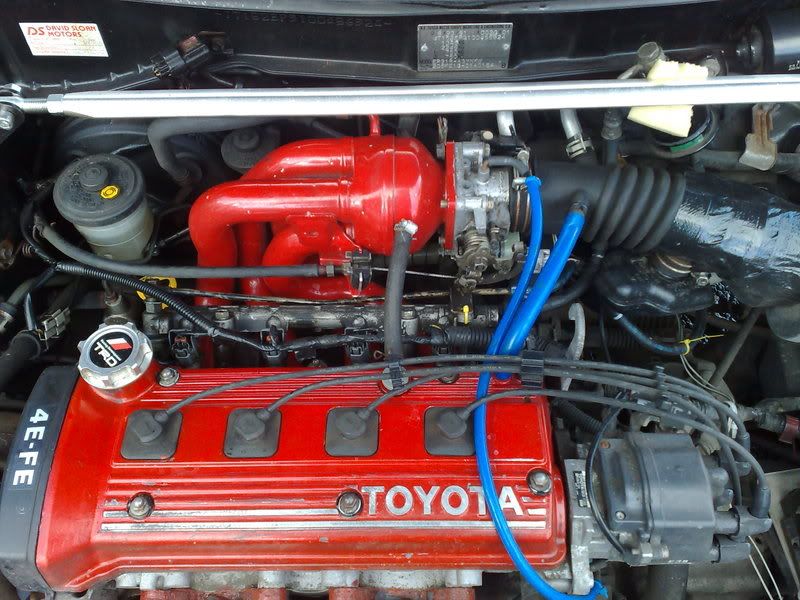

Tintin_SR Posted December 3, 2007 Share Posted December 3, 2007 OK am back, now i don't no how much you no so al just go right back to the simple stuff!OK at the top of the pic you have the inlet manifold (thats the red think at the top) then running to the right you will find the induction kit/ are filter! The bit that you want is the silver bit in-between them thats the throttle body OK coming in from the side now you can see the manifold and the throttle body.in a bit now you can see the side of the throttle body and the bit that you want and in a bit more thats the boy you want think its am 8mm by the look of it but mite be wrong! all you want to do it to titan it to mack the idle speed higer or loosing it to reduce idle speed, i did this when i was letting sum one drive my car that was a bit crap at driving! if you losing it it makes it v hard ti stall and you can drive it in the idle with no power on and it wont cut out at all will build up speed to! hope this helped PS can you tell that i had the day off and was rely Bord!!!! Quote Link to post Share on other sites
nic1.3 Posted December 3, 2007 Share Posted December 3, 2007 is that it ahh man i know bout that screw, and i had 2 go and ask a stupid question to confirm it.cheers man actually very helpfulhhmmm i've heard of blacktop engines but neva a red top very nice mite suit mine Quote Link to post Share on other sites
