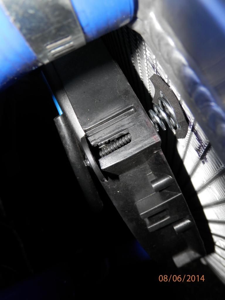

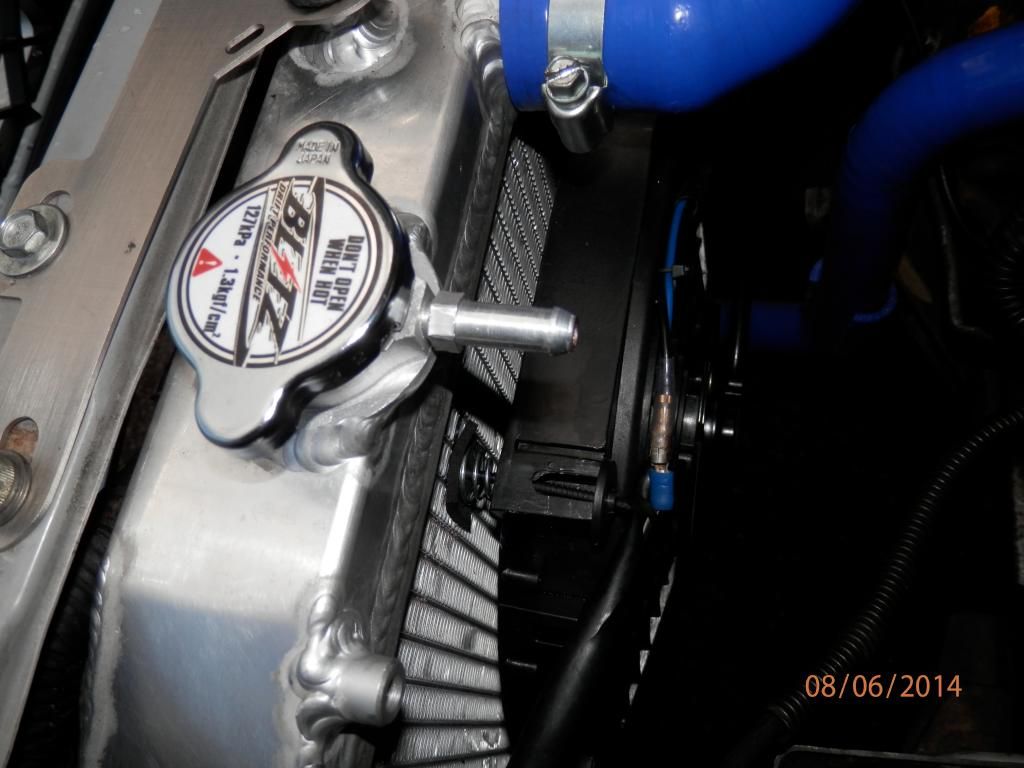

steve1093 Posted June 8, 2014 Posted June 8, 2014 Does anyone have a picture of how the fan fits to a half size radiator? Cheers Quote

JamesD89 Posted June 8, 2014 Posted June 8, 2014 You run the rods through the rad fins into the retainer clips mate Quote
steve1093 Posted June 8, 2014 Author Posted June 8, 2014 You run the rods through the rad fins into the retainer clips mateJust can't get my head around it without seeing it, it's been a long weekend... haha Quote
Ep911-20v Posted August 30, 2014 Posted August 30, 2014 Should use a shroud or the only part of the radiator getting cooled by the fan is the part the fan is mounted too So instead of 100% of the core being cooled your only cooling 60-50% Quote
