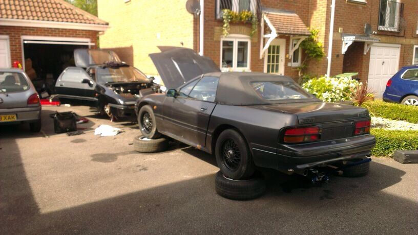

MARC MOSS Posted June 18, 2014 Author Posted June 18, 2014 Nope we had an na and a turbo II. Stripped the complete turbo engine, full drivetrain loom the whole lot and fitted it into the na in three days I'm thinking maf as well to be honest Quote
MARC MOSS Posted June 18, 2014 Author Posted June 18, 2014 The fc vert was the turbo donor and was fucking rotten. The other was a na mint shell with dead rotor tips... It made sense to do a complete swap! Wait till you see this fucker at jae. I sourced some amazing and rare volks for the owner as well.. It's going to be sick and it's so close to completion Quote
