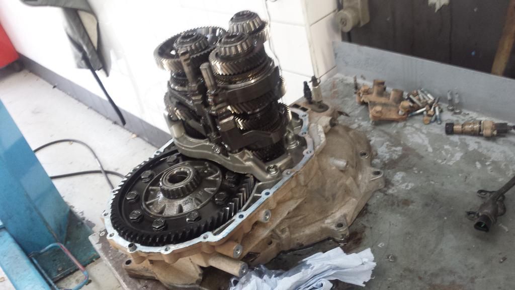

daniel_g Posted November 12, 2014 Posted November 12, 2014 You dont need to totally strip it down to inspect it. The state of the oil and the amount of shite on the magnet will tell you a lot. Once the 5th assy is off the main cover will come off and you can pull out the gears, diff etc.I do a fair few gearboxes in work and they can look a bit daunting the first few times. Last one i did was a 4wd 6 speed Hyundai box, they are all more or less the same you get the idea. Quote
mikey4410 Posted November 12, 2014 Author Posted November 12, 2014 thanks so much for the info and piccys. just want to open it and inspect .not dismantlte the gears if can be helped. Quote

morgey Posted November 13, 2014 Posted November 13, 2014 Done a few with my mate, use taggys guide and you can see the majority but theres always the chance that the cones on the synchro could be the issue. I just rebuilt my 6 speed box (major 2nd gear crunch) and had the assembled gearsets checked over by someone who does it as his profession and he advised on some new selector hubs (1st/2nd and 3/4th) as the teeth were slightly worn and could be causing the issue but didnt think that would be the sole cause of the crunchSo I decided to do the advised bits and the synchros whilst it was apart, good thing i did becuase 2nd gear synchro looked like this...There was no way you could tell that this had happened, with out stripping it down there were no signs of damage other than when driven. Luckily my mate has the gear to do this stuff at his work and i even went in and helped out so i didnt have to pay. But J R Dains (local place to me) charge £250 to strip down inspect and rebuild a box then you have parts ontop of that. Quote
