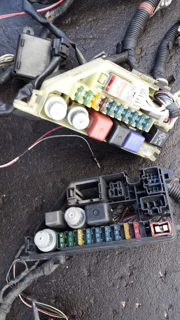

daniel_g Posted November 20, 2014 Posted November 20, 2014 The clocks unit has different plugs.Also the MK1 fusebox is different.Top MK2/3 bottom is a MK1 Quote
Adam-Gt- Posted November 20, 2014 Author Posted November 20, 2014 Sounds like a right pain in the arse I'll see what I can do with the exsisting loom It's the knock sensor wire that's been cut of which is my main concern Quote

daniel_g Posted November 20, 2014 Posted November 20, 2014 Yeah repairing it is a lot easier than swapping the whole loom, especially if its only a MK1 loom you have to hand.You can unplug the two white plugs from the fusebox, along with the large red & black fuses just under them, this splits the ancillary loom away and you can fix it on bench easier or replace this section if its too badly fucked. Quote
