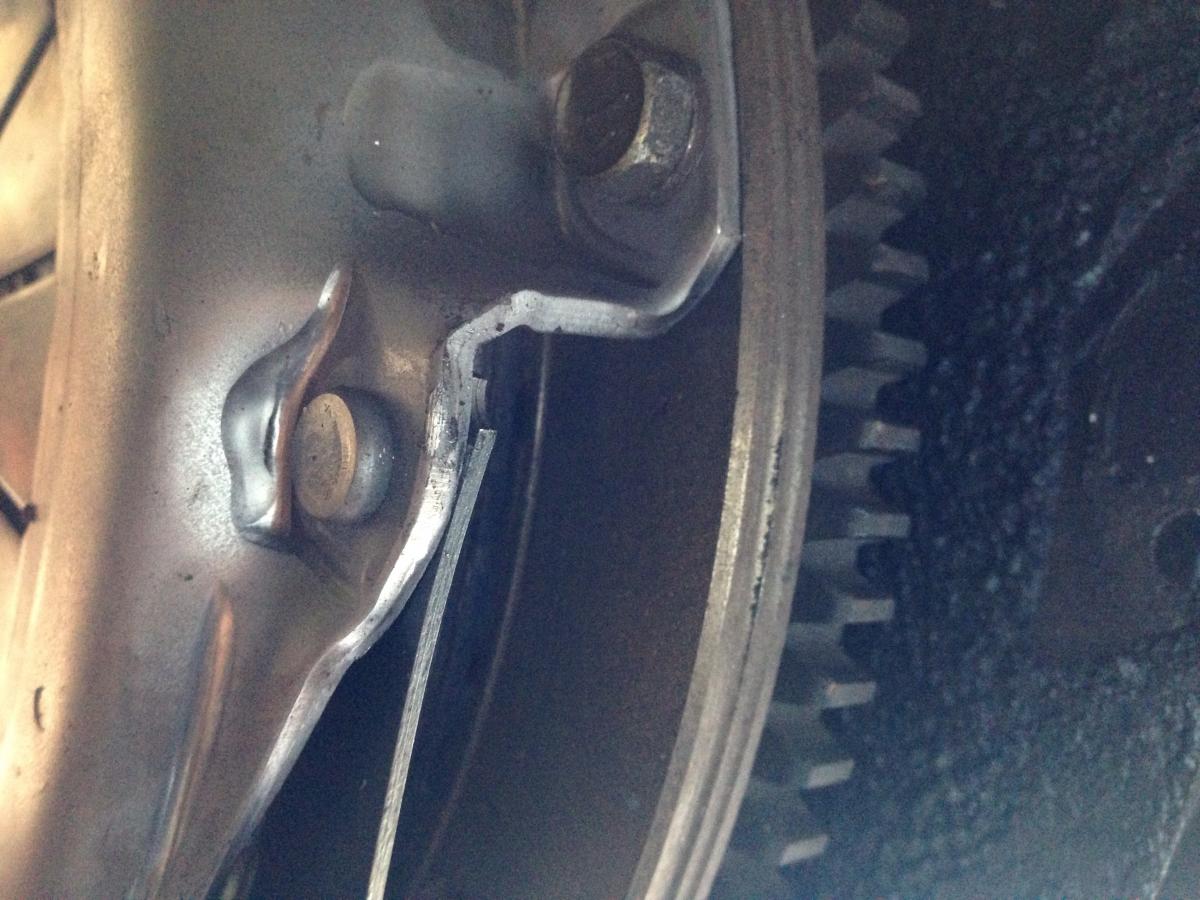

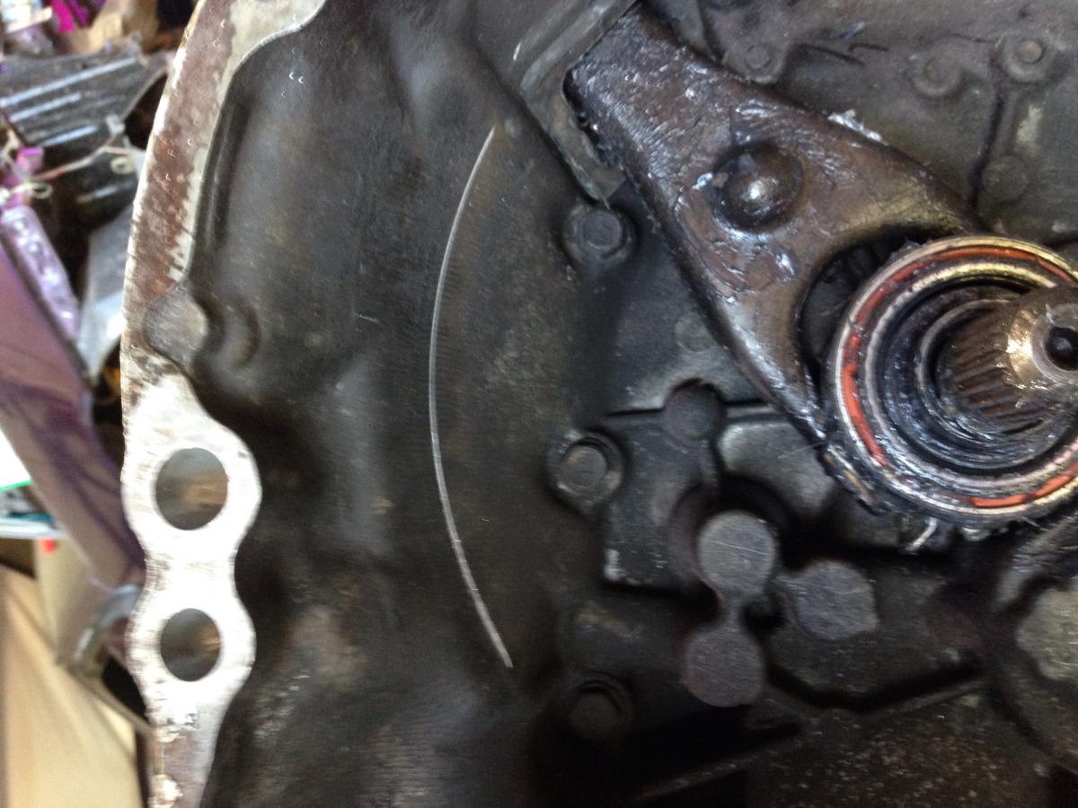

funny onion Posted June 14, 2015 Author Posted June 14, 2015 Yeah the clutch I bought fit the flywheel and engaged/disengaged fine but it was a few mm proud and was just catching the bell housing. I have photos I'll stick them up later. So rather than just swap the clutch (luckily I have spared of pretty much everything haha) I decided I might as well pull the 6 speed out of my knackered Glanza and put that on at the same time. I always wanted a 6 speed for it anyways. It's all back together now, modded shifter fitted etc. all interior back together and literally just need to fit the pins for the aerocatches on my bonnet and it's good to go down the road. Brakes are all bled up. Hopefully I'll get it out in daylight maybe today and get some decent pics! Quote
