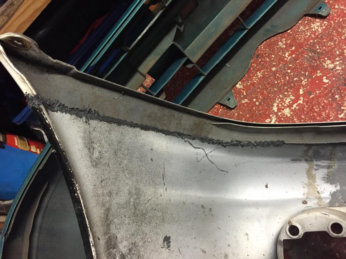

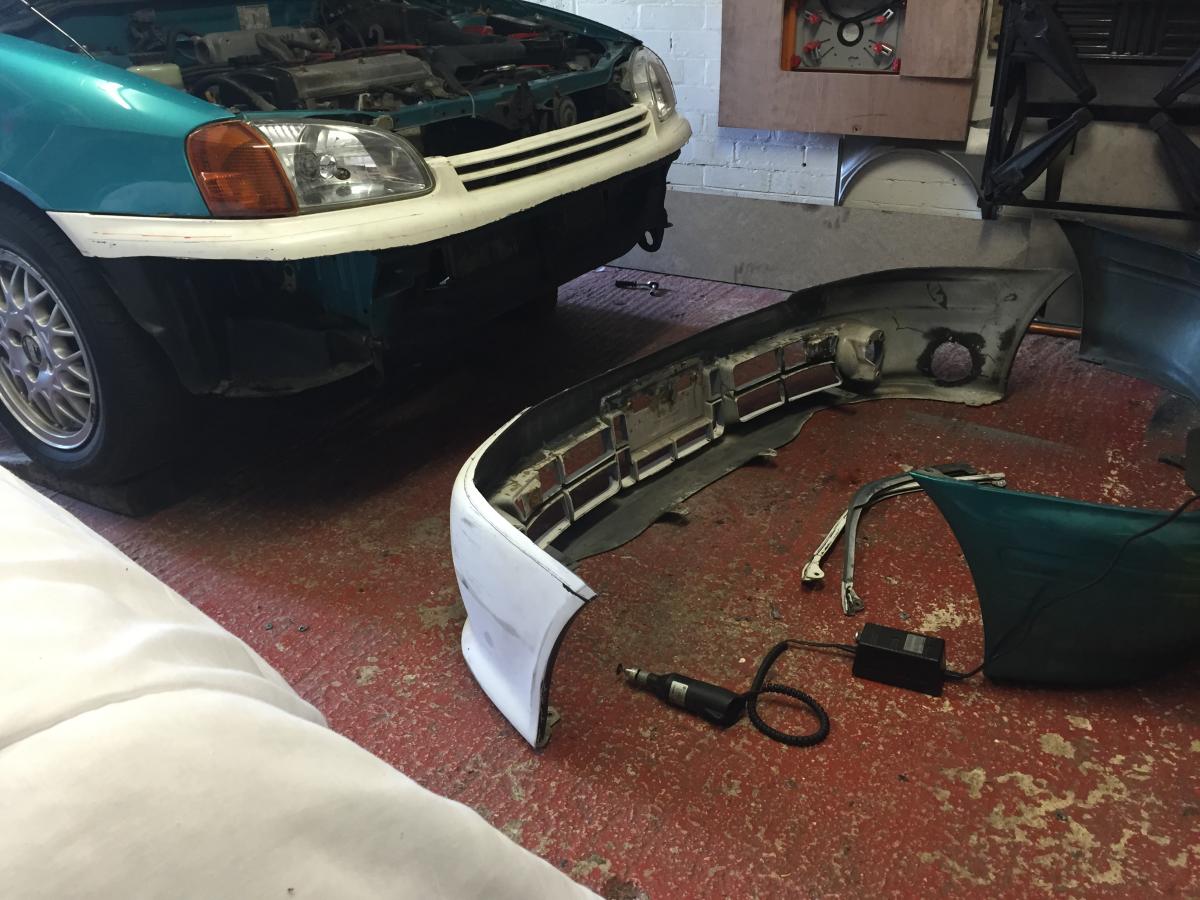

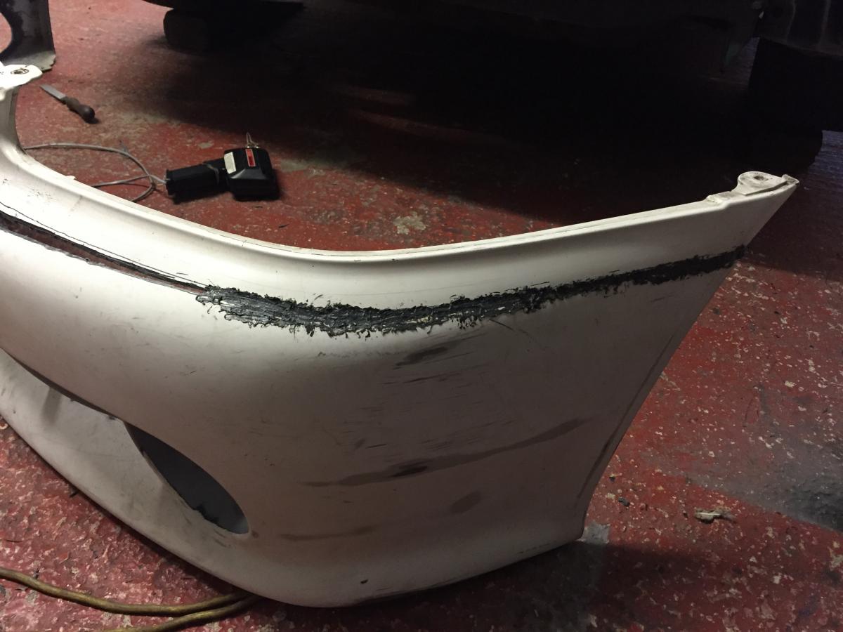

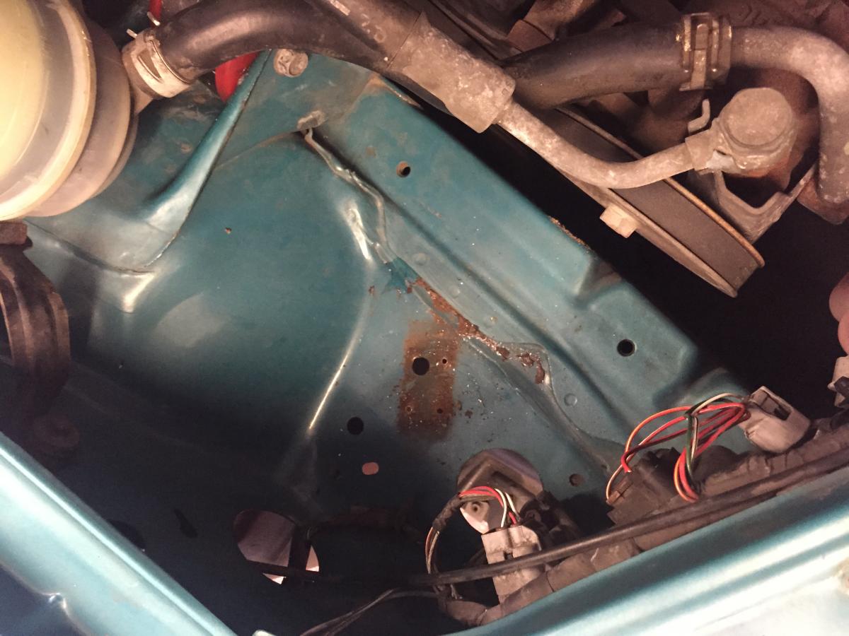

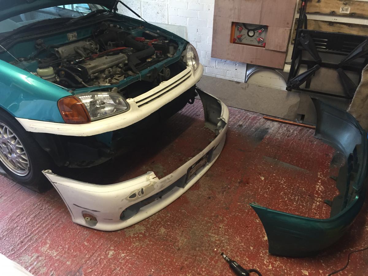

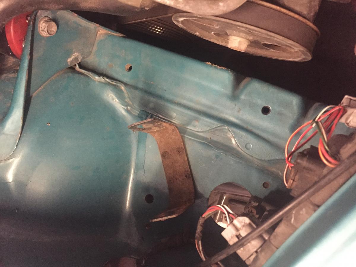

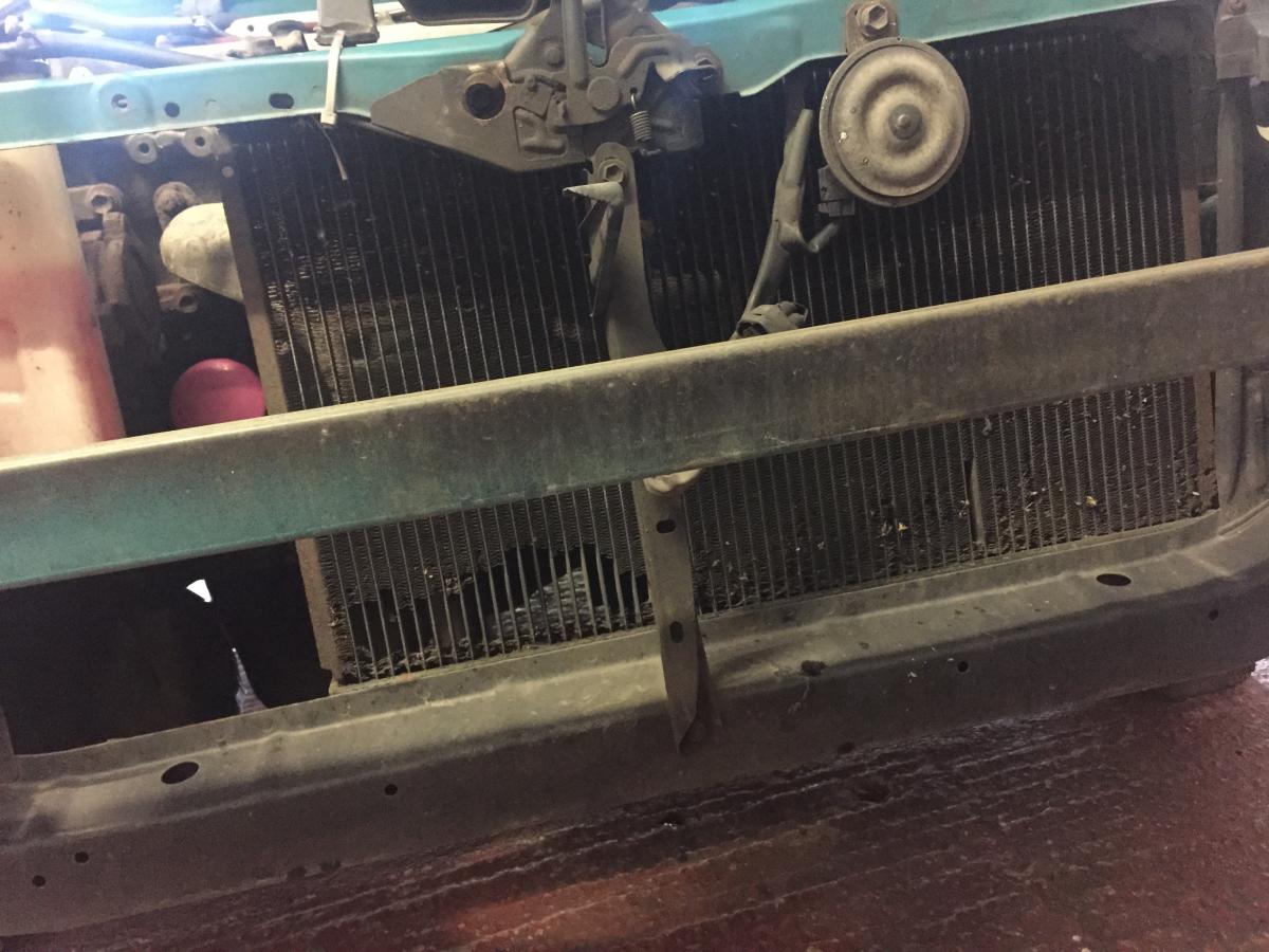

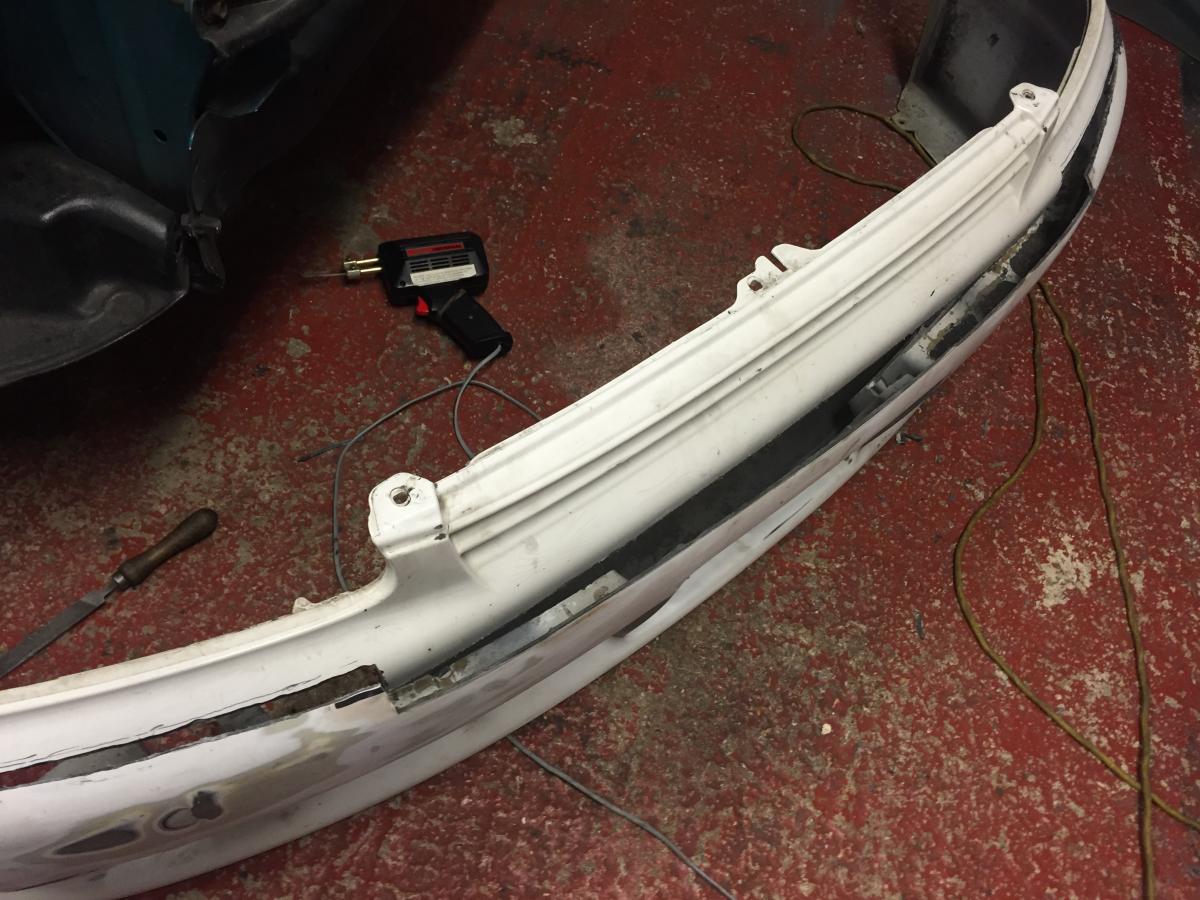

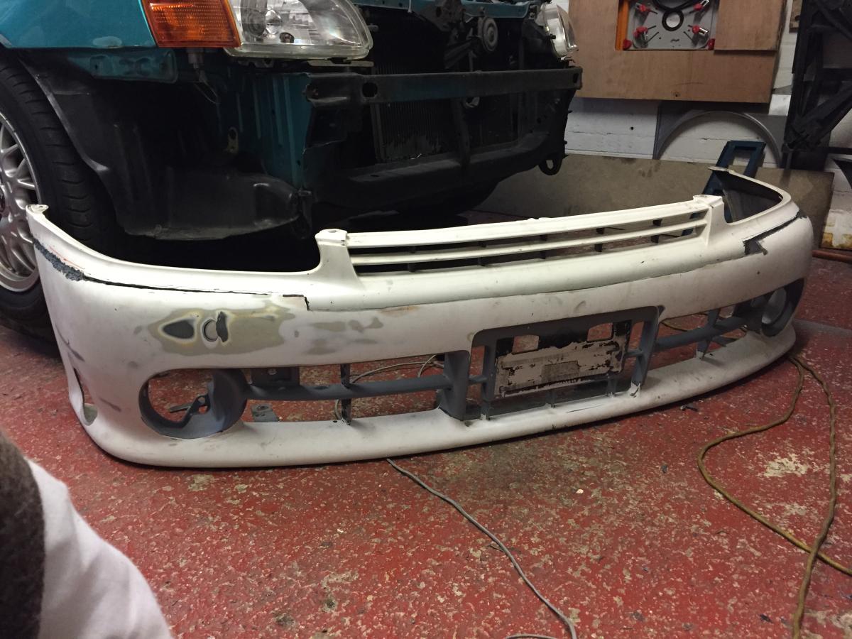

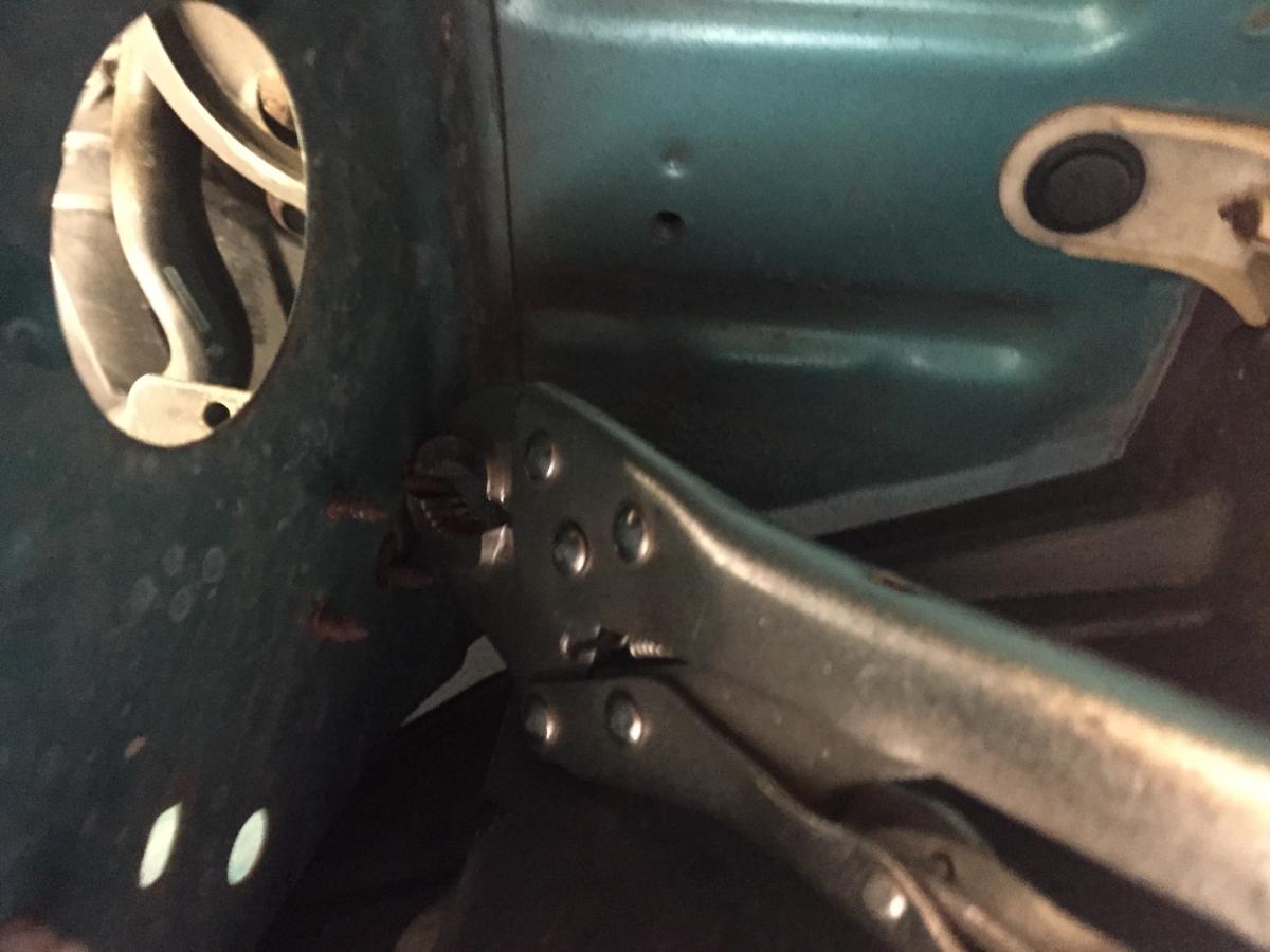

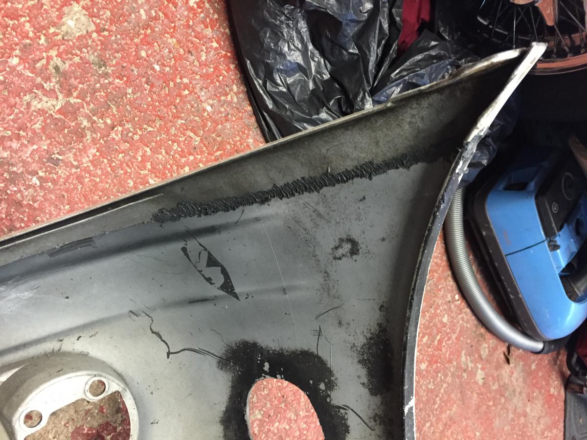

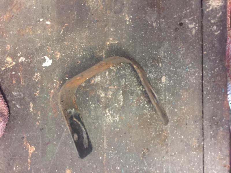

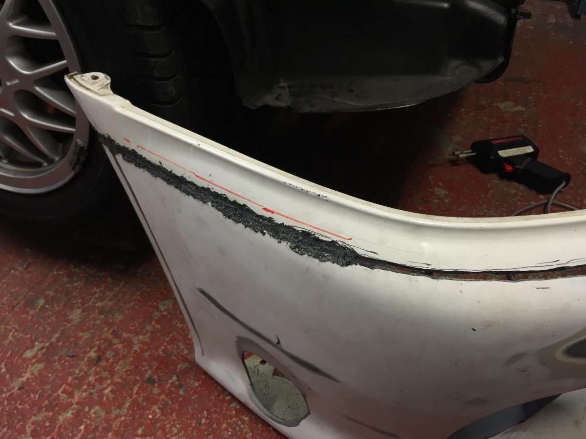

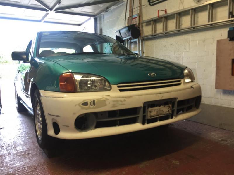

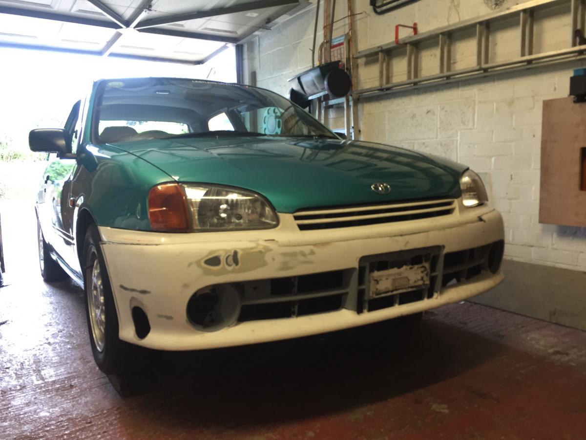

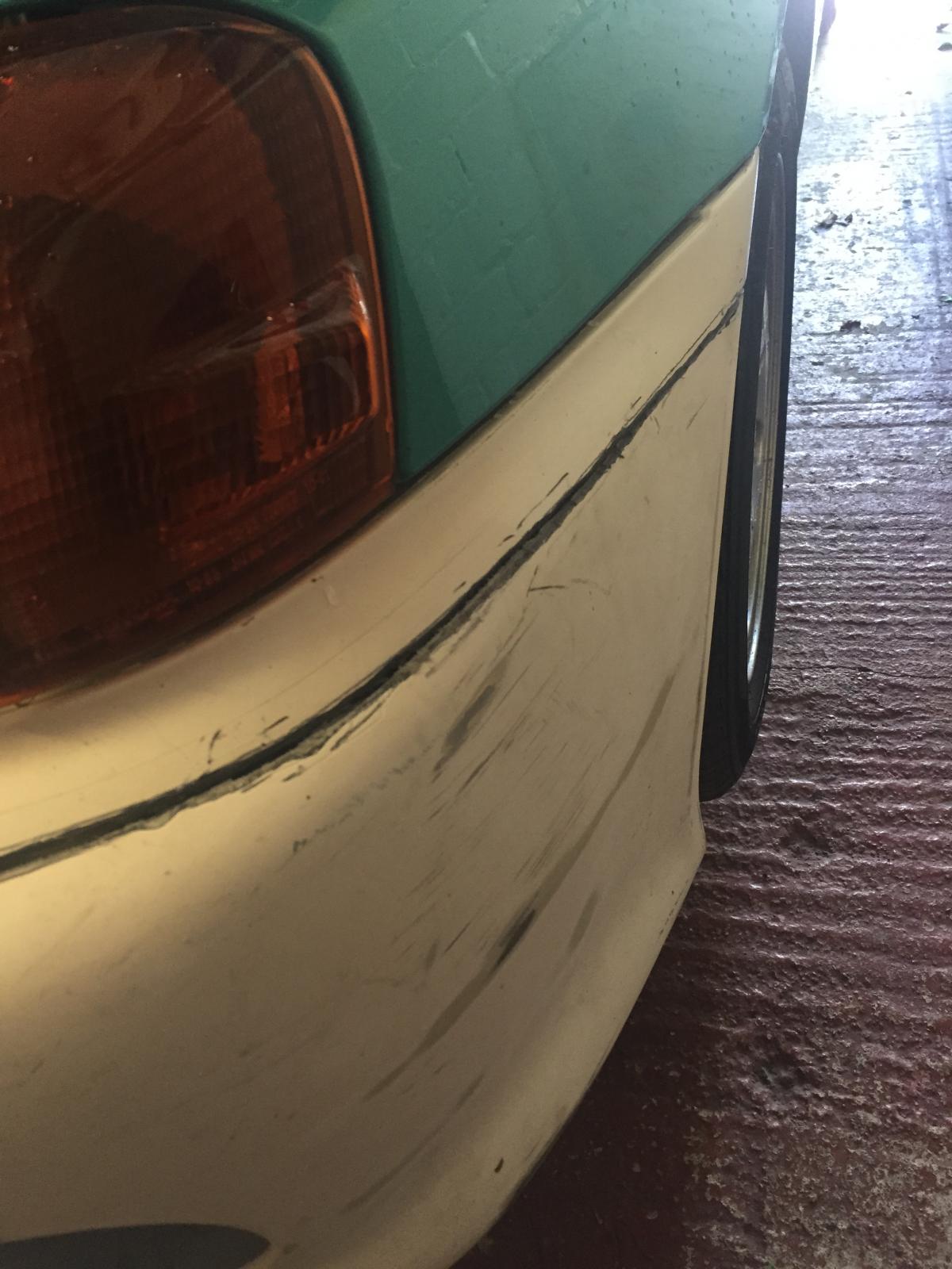

*Pete* Posted September 15, 2015 Author Posted September 15, 2015 Update: With my 2 days off after JAE I decided I to take an old alarm system bracket off as the screws were rounded and rusted but also did alot on my front bumper.Also just how bad my radiator is :/ so I know main purchase on payday going to go civic half rad along with brakes and going to do the timing belt at the same time for peace of mind.Right now for the interesting bit the bumper so I took the old na bit someone else fibre glassed on which over time has fallen off so using my bumper from my sr I've decide to take the approach of plastic welding around the entire bumper for strength which with the little bit I have done now it is on there strong. I found taking a little bit off at a time to be the best way to get the bumper to sit right on the bolt holes.Prep to weld so cutting/filing and making a chamfer for to fill with strips of plastic:Before welding:And During/after:Where it sits currently, I will need to spend some time looking at how to fill the gap now I have already thought of different ways to but will possible look at it in detail on the weekend. Quote
*Pete* Posted September 15, 2015 Author Posted September 15, 2015 Damn just realised I didn't get a picture with the bonnet closed with the sides welded :/ Quote
*Pete* Posted September 15, 2015 Author Posted September 15, 2015 Sweet man thats gunna look awesome Cheers, in person even now it looks like it going to work Quote
