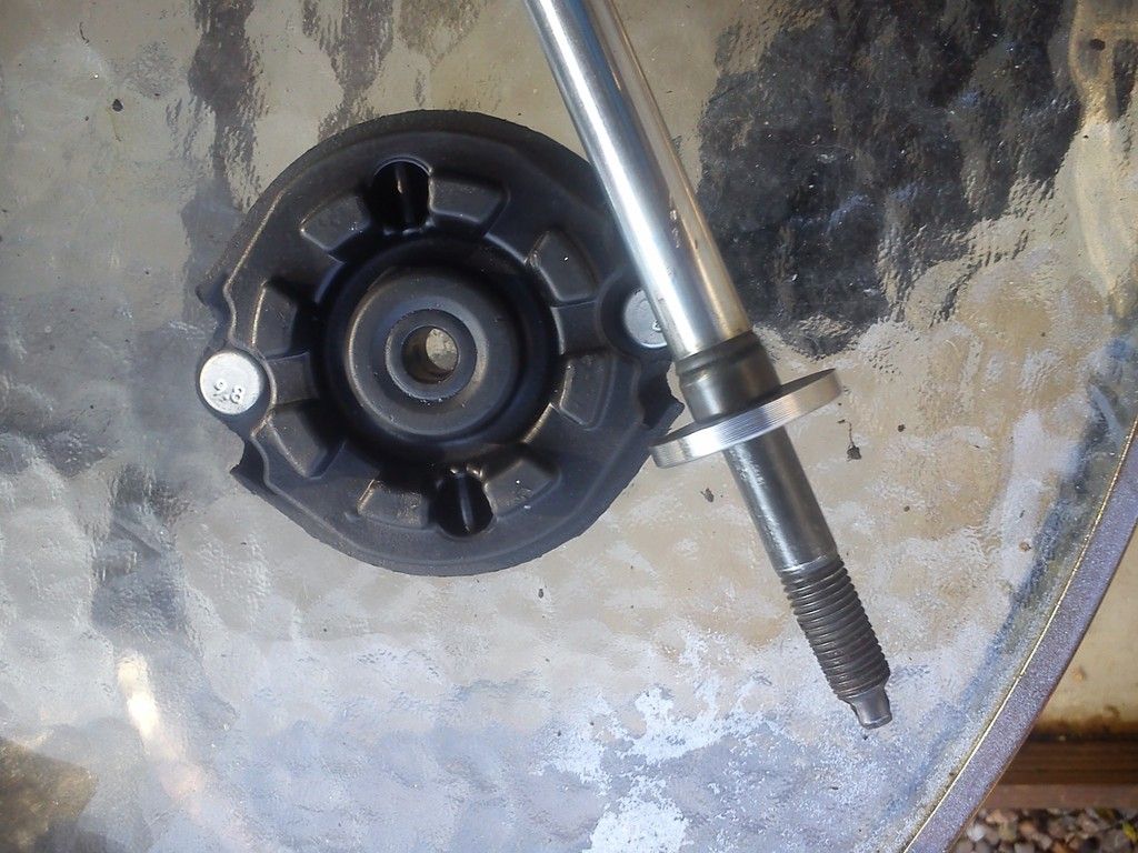

mart1 Posted July 11, 2015 Posted July 11, 2015 I have new KGB shocks & apex springs recently fitted probs done 100 miles on them then this happened.They was fitted at my local car garage, I asked them if my strut mounts was good told me they was fine, I have gone back to the garage a couple of times since they have been fitted because there is a knocking noise at the rear of my car they said it is probably your exhaust.This happened today.What's bugging me is will the garage charge me again for fitting new struts:-( I hope not.Where can I get struts from ? I have had a look on eBay & it's not very clear on ordering the correct ones.Here is a PIC left side that's fucked right side OK at the moment but is knocking. Quote
Starlet__SR Posted July 11, 2015 Posted July 11, 2015 Was the washer refitted on the underside of the problematic top mount? If not thats why its slipped through.Day Quote
akyakapotter Posted July 11, 2015 Posted July 11, 2015 (edited) Missing washer as above 100% Edited July 11, 2015 by akyakapotter Quote
mart1 Posted July 11, 2015 Author Posted July 11, 2015 That's odd it was a mechanic that fitted them so I have no idea what's happened here, has anyone got a pick of the washer I need where can I get one & what size, are you guys sure it's a washer that's missing? Will this have fucked the strut mount up because of this or will it be fine when I get a washer? I will be straight to the garage Monday morning. Quote

mart1 Posted July 12, 2015 Author Posted July 12, 2015 I think it is the strut that's bust they only have the one washer that fits on the top mount don't they? Then the strut.Is this the right part I need to order?http://pages.ebay.com/link/?nav=item.view&id=291053552061&alt=web Quote
akyakapotter Posted July 12, 2015 Posted July 12, 2015 You just need a small washer to put in there dude. Quote
mart1 Posted July 12, 2015 Author Posted July 12, 2015 Should that stop the knocking to? Only it was knocking before it pushed through the mount but now it makes a right noise.Cheers for help Quote
Starlet__SR Posted July 12, 2015 Posted July 12, 2015 Washer, topmount then another washer. Thats how it should be.Day Quote

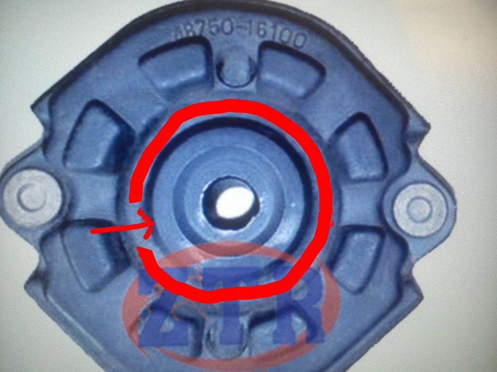

mart1 Posted July 13, 2015 Author Posted July 13, 2015 (edited) So is this the washer that's missing? or should a washer or spacer fit into this?I have been to the garage that fitted the new shocks & springs & they said they swapped everything over from old shocks. There going to take a look for me tomorrow. Edited July 13, 2015 by mart1 Quote
mart1 Posted July 17, 2015 Author Posted July 17, 2015 I have had a couple of spacers made to fit to make it stronger, hopefully it will stop the shock pushing up again next time I hit a grid Quote
jimmymac101 Posted July 17, 2015 Posted July 17, 2015 With that washer there you should be fine .... Tends to be a common problem so your not alone James Quote
