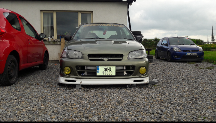

EP70-PT Posted March 20, 2017 Posted March 20, 2017 Why did you remove the side skirts mate? xD Quote
SpikeyJp_68 Posted March 20, 2017 Author Posted March 20, 2017 That msnifold looks great and same with the carThanks buddy Quote
SpikeyJp_68 Posted March 20, 2017 Author Posted March 20, 2017 Why did you remove the side skirts mate? xDOnly test fitted one and i took it off so it didnt fall of when i was moving it. Its on the to do list. Bought some T15 w16w bubls aswell for my fogs Quote

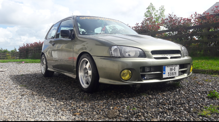

SpikeyJp_68 Posted April 19, 2017 Author Posted April 19, 2017 Love the body color!Cheers mate. Its the same as fordie glanzaV's in the turbo section. Was a complete coincidence with colour choice Needs a wash in a bad way which should be soon now its driving Quote

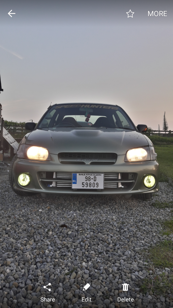

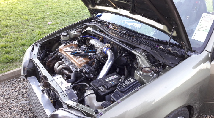

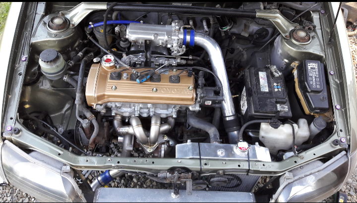

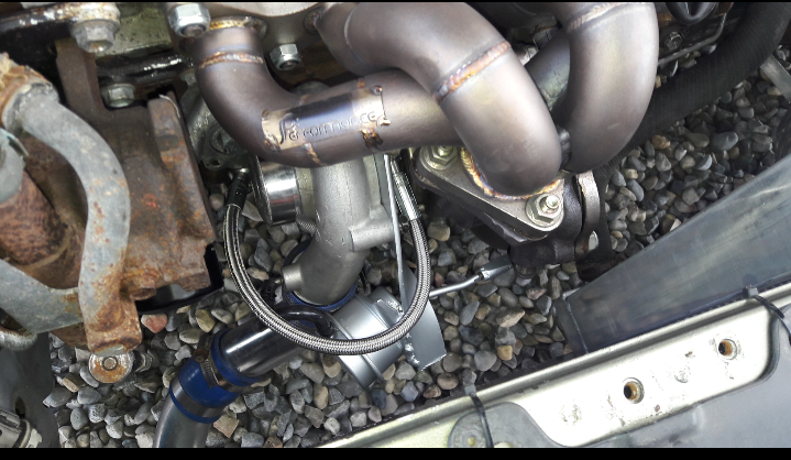

SpikeyJp_68 Posted May 1, 2017 Author Posted May 1, 2017 Map sensors spot on pal thanks :) Got it boosting properly today by putting the actuator on. Full boost at around 3500 which is lovely few little things to sort out still. Need an exhaust system becuase apparently its "too loud" for my neighbors... got the LED fogs in aswell Quote
EP70-PT Posted May 1, 2017 Posted May 1, 2017 Nice fogs mate eheh hope you're not selling it anymore Quote
SpikeyJp_68 Posted May 1, 2017 Author Posted May 1, 2017 Nice fogs mate eheh hope you're not selling it anymoreNope keeping it now. Was getting shit offers and im not breaking it anytime soon Quote
5e colin Posted May 2, 2017 Posted May 2, 2017 Map sensors spot on pal thanks :)Got it boosting properly today by putting the actuator on. Full boost at around 3500 which is lovely few little things to sort out still. Need an exhaust system becuase apparently its "too loud" for my neighbors... got the LED fogs in aswellScreenshot_20170501-212906.png20170501_213013.png you running 0.7bar then ?? using that actuator great that you have fulll boost on 3500 still 500 before tdo4 now source yourself an acis manifold to lower it more ( you will gain top end aswell ) what the fuck joey dont ever sell you will regret eventually wee al do Quote
SpikeyJp_68 Posted May 3, 2017 Author Posted May 3, 2017 you running 0.7bar then ?? using that actuator great that you have fulll boost on 3500 still 500 before tdo4 now source yourself an acis manifold to lower it more ( you will gain top end aswell ) what the fuck joey dont ever sell you will regret eventually wee al doYeah standard td/tf actuator so .7 or.8 bar not exactly sure what it is. Got a cheap boost gauge wired in for the moment so we can see what its running.Will be getting innovite gauges like you said colin boost and afr. Exhaust system is in the process of being bought should be here within 2 weeks all going well Quote

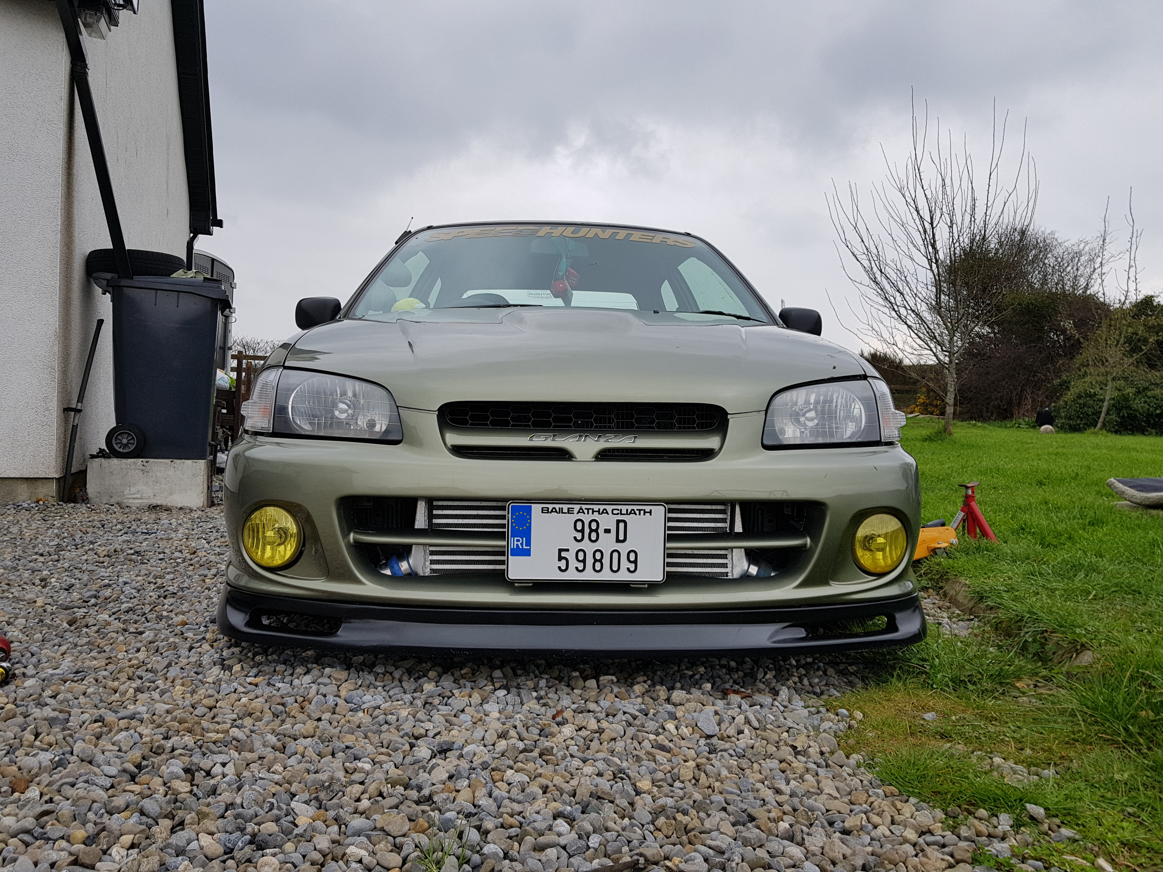

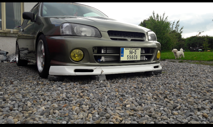

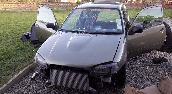

SpikeyJp_68 Posted May 5, 2017 Author Posted May 5, 2017 Bumper had to be cut a bit more..Still needs a little shaving on the lhs Quote
SpikeyJp_68 Posted May 5, 2017 Author Posted May 5, 2017 Okay so according to my cheap boost gauge im only getting .5 bar of boost which is a good bit under the .7 .8 bar i was hoping for. Im going to get a mechanical boost controller and whack that in and see is it my wastegate spring at fault or is there a boost leak anywhere... Quote
SpikeyJp_68 Posted May 5, 2017 Author Posted May 5, 2017 srew that nut al the way back On the boost controller or the actuator ??Feels good even now should feel a whole load vetter with another 4 psi in it Quote
5e colin Posted May 6, 2017 Posted May 6, 2017 actuator arm ( 10mm.nut ) make it tight as possible Quote
SpikeyJp_68 Posted May 6, 2017 Author Posted May 6, 2017 actuator arm ( 10mm.nut ) make it tight as possibleOkay will do Colin cheers Quote

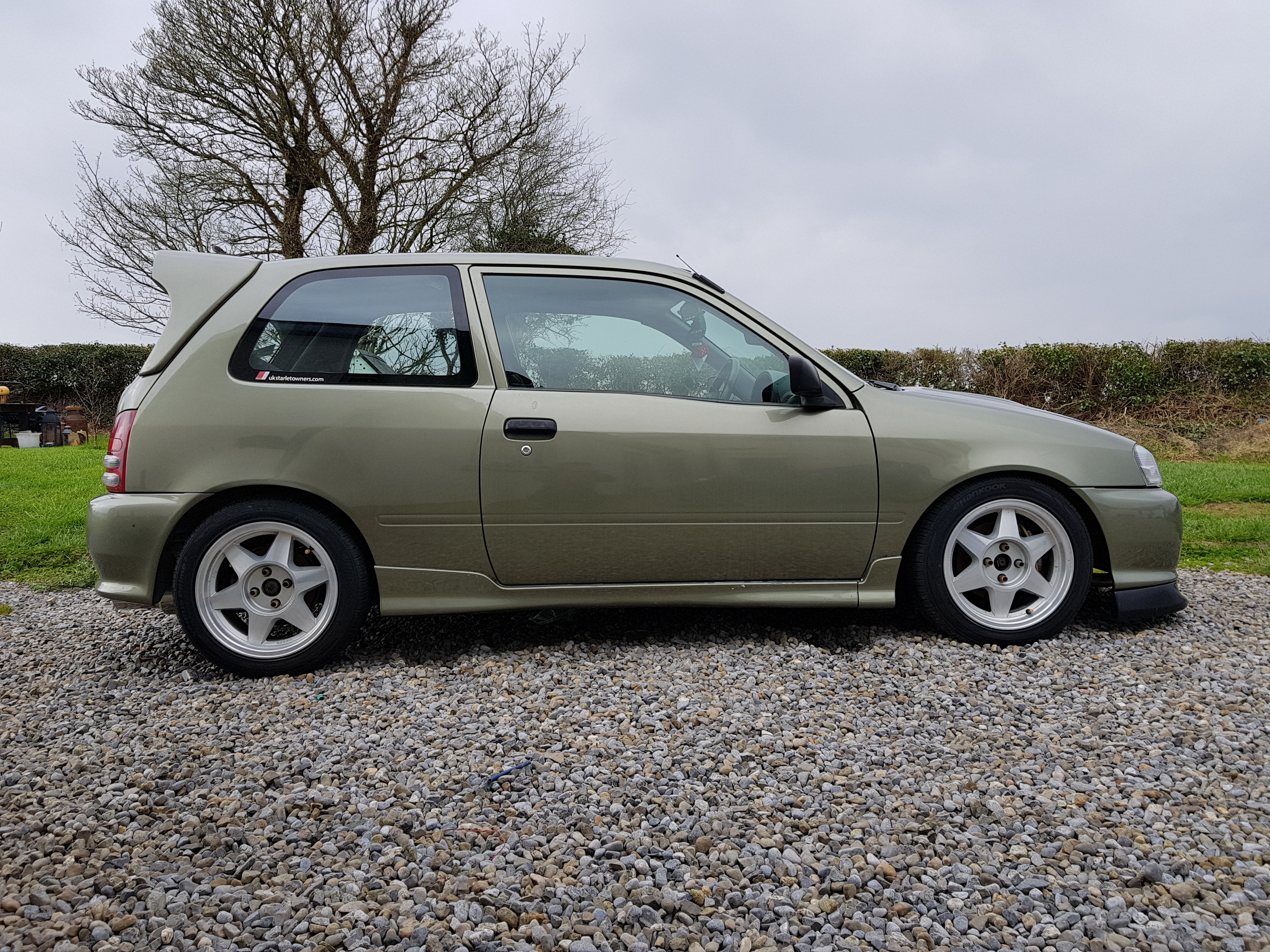

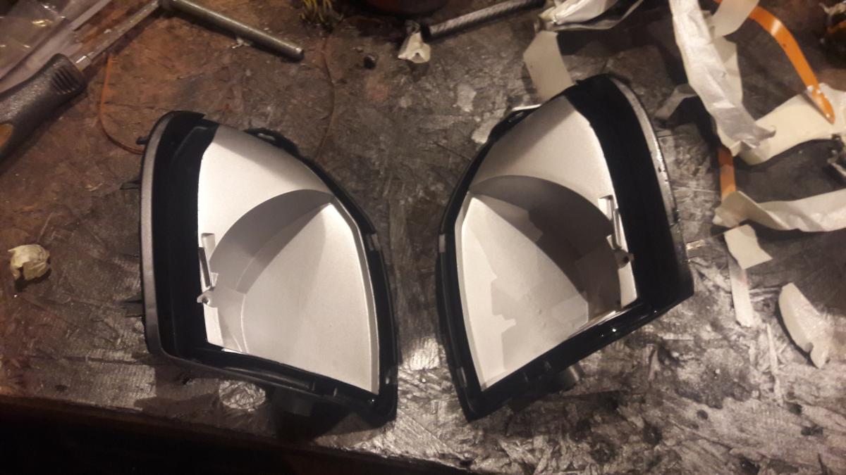

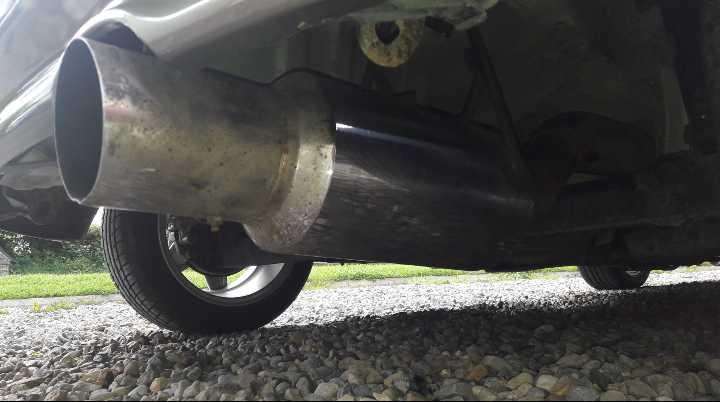

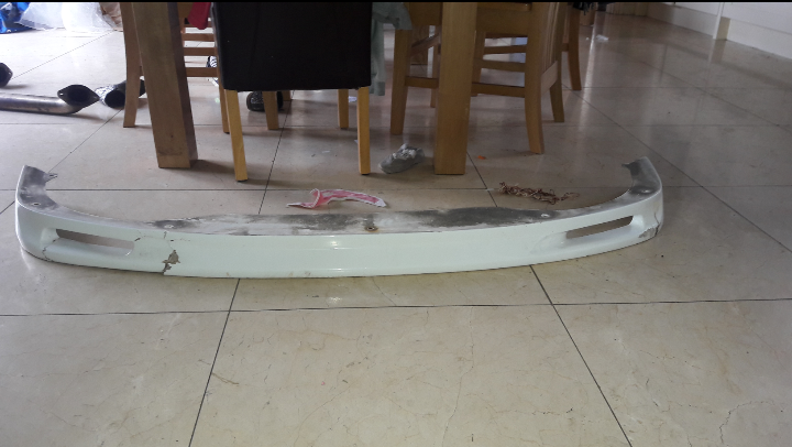

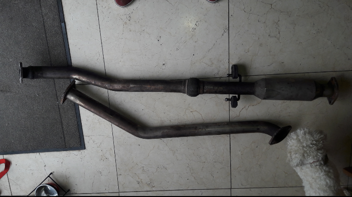

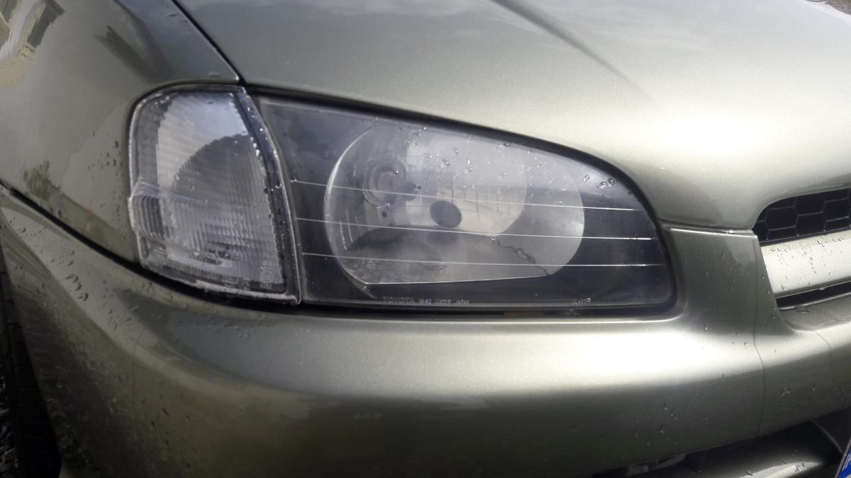

SpikeyJp_68 Posted May 23, 2017 Author Posted May 23, 2017 (edited) Time for an update..Got my indicator units painted up last week silver and black and theyre looking much better nowGot my skirts on good and proper. A piece on the drivers sil needs painting again as paint chipped off the skirt but have a few things to paint now so nothing major. You may havee noticed a lack of midspoiler... it ended up falling off due to my shit painting on the bondimg surface and me not thinking.. have it rubbed down to be painted again as it got chipped when it fell off.Bought a front lip which i believe is a livesports type A ?? Can anyone confirm ? No stamps but i believe livesports only stamped their arches and skirts. Its a perfect fit around the edges and stops when the bumper does. Has holes for screws also. Needs repairing due to it being cracked. Which im not surprised at concidering how low down it sits. Track use only it seems it was made for.Also bought a stainless steel catback. Needs a new flexi but was cheap and cheerful which is all i wanted. May or may not change the backbox to a 5zigen or apexi N1 but we'll seeAnd lastly i got myself a nice new gearknow.. well sort of. Needs drilling and tapping but you get the idea. Now fitted Edited May 23, 2017 by SpikeyJp_68 Quote

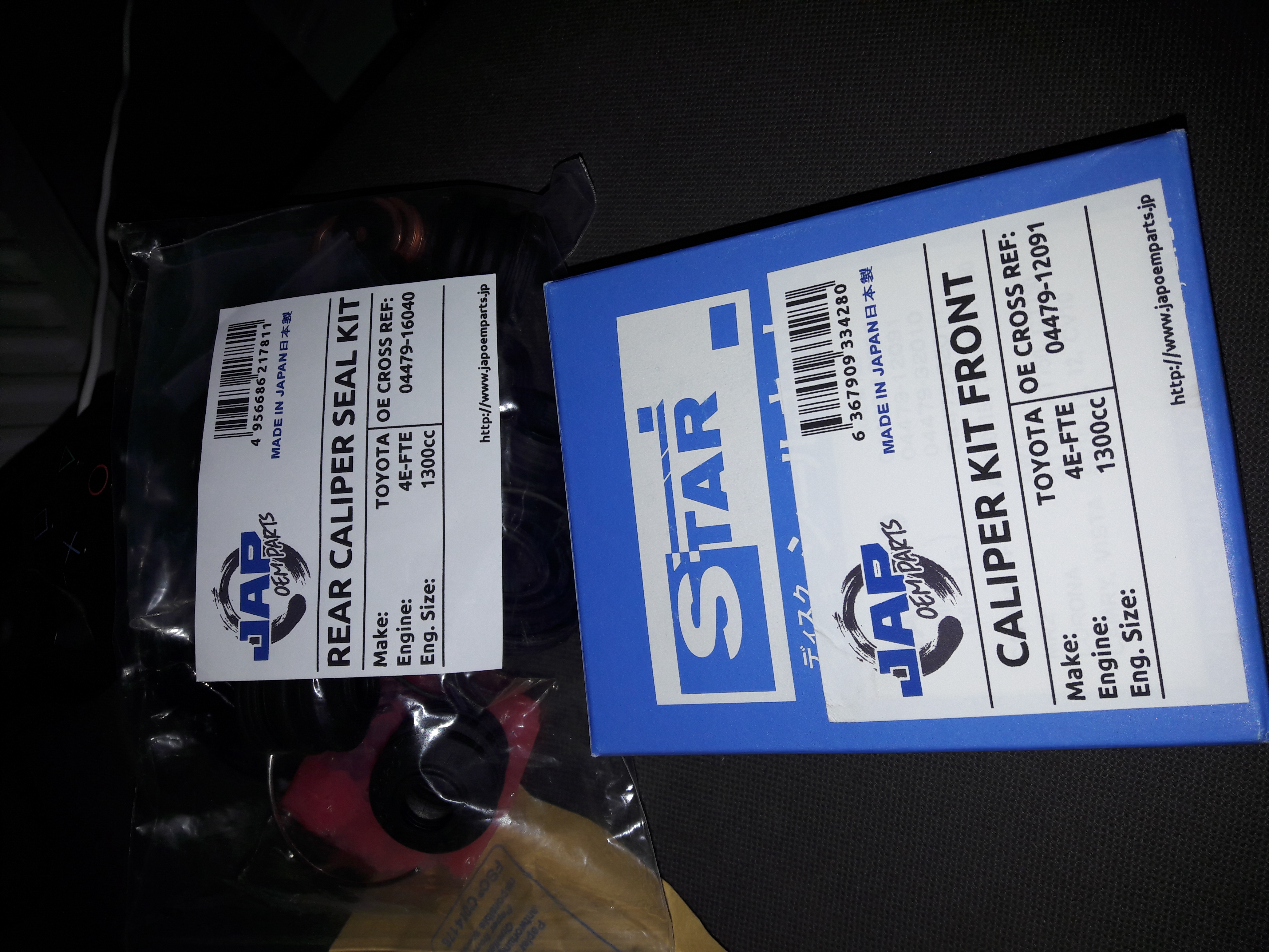

SpikeyJp_68 Posted December 11, 2017 Author Posted December 11, 2017 Okay so a small update. Past 6 months ive done nothing with the car completely lost interest in it. Recently has been sat on axle stands waiting for calliper rebuild kits to arrive which i now have and hope to do in the next 2 weeks  After that sadly im 90% sure im going to get an nct (mot) on it, put an ebc on it and run .8 bar then sell it. Reason being ive had it 5 years already and will be another 5 before i can drive it legally. I have a lot of money tied up in the car so will most likely be for sale in the 1st or 2nd quater of next year Quote

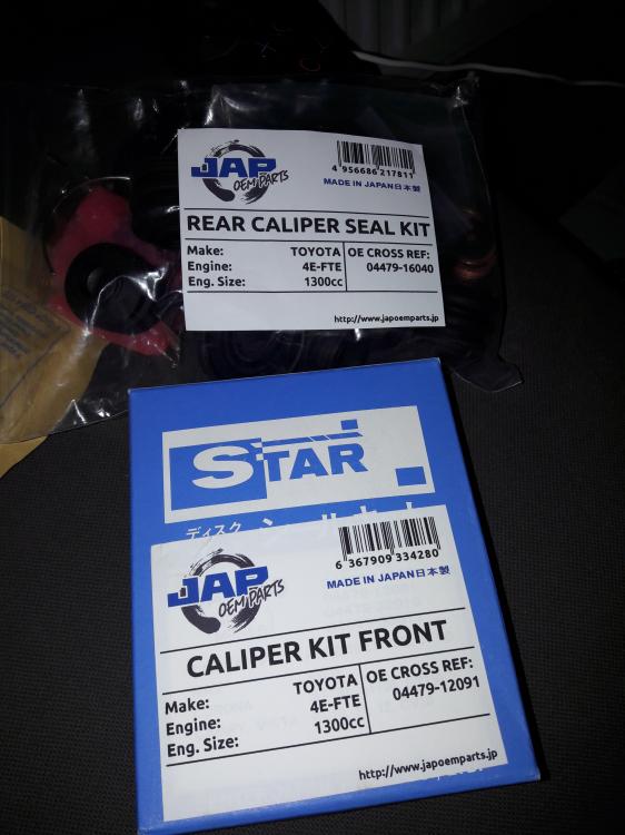

SpikeyJp_68 Posted April 15, 2018 Author Posted April 15, 2018 Okay so after a long absence of feeling shit and not wanting to do a great deal with the car ive finally decided to get a few bits done to it  I have got the brakes rebuilt and all put on the car seem to be working fine but hope to give it a decent enough run soon enough to find out. My handbrake is none existant so will most likely need 3 new cables. Plan next month is to sort the handbrake, get an ebc wired in and running and sort a few other small things such as a slim fan, passenger airbag needs wiring, cat converter for mot/nct, a rear fog needs wiring up, reverse switch, oil pressure switch, n/s exterior door handle, weld drivers seat mount, secure exhaust heat shields, new fuel gauge sender. Anyone have any of these or the bits below at a reasonable price give me a shout for next month Im hoping at .8 bar, standard ecu with my tf035, i can get around 220bhp. Drove it slightly yesterday and the tf035 feels really nice to drive. Full boost (.5 to .6 bar) is at about 3500rpm but you definitley notice when it comes on. If i was to estimate power output at the moment id put it anywhere from 110bhp to 130bhp After that and once it has an mot/nct, i will be looking at getting a piggyback ecu & mapping, 440cc injectors, c56 gearbox & shafts with  possibly a qualife lsd, some new wheels in bronze, meister R coilovers.  Heres a few recent pictures to keep you all updated  will be knocking about on the forum so hope to catch up on what everyones been up to Quote
