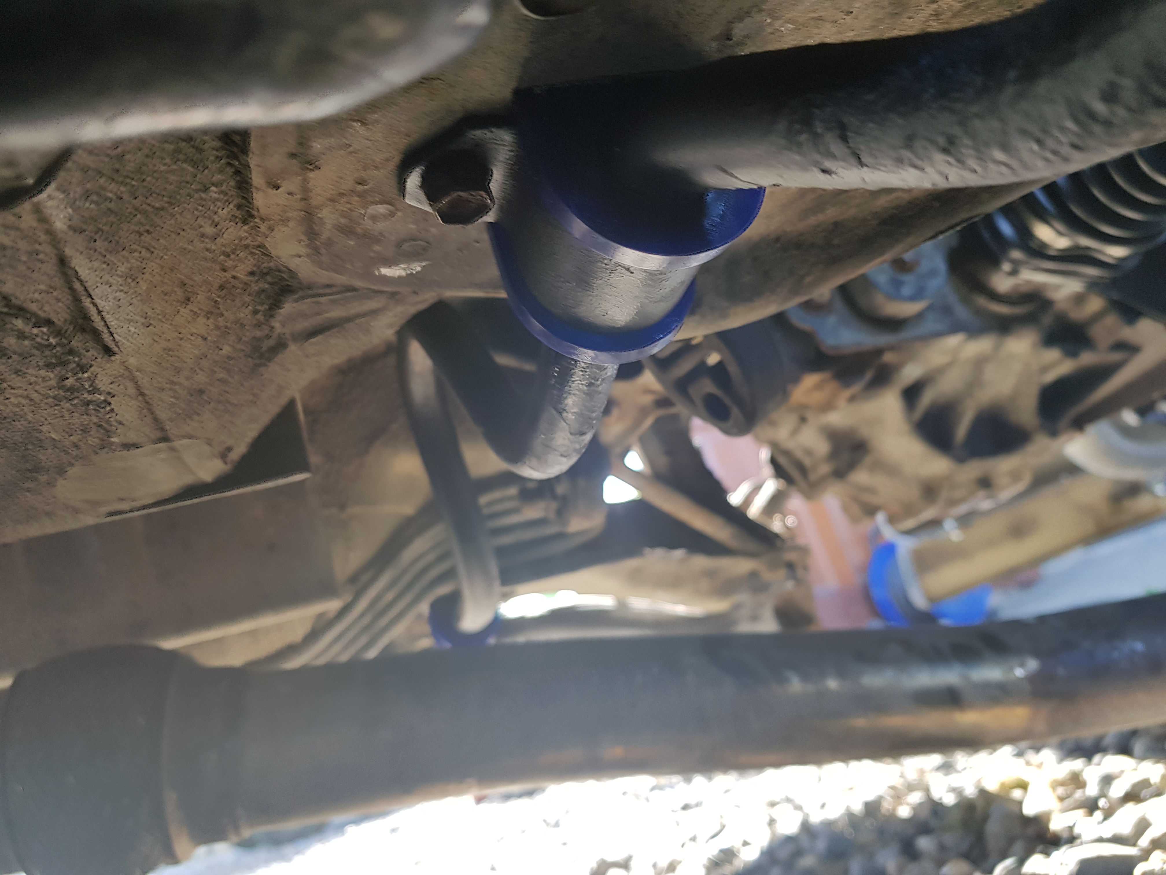

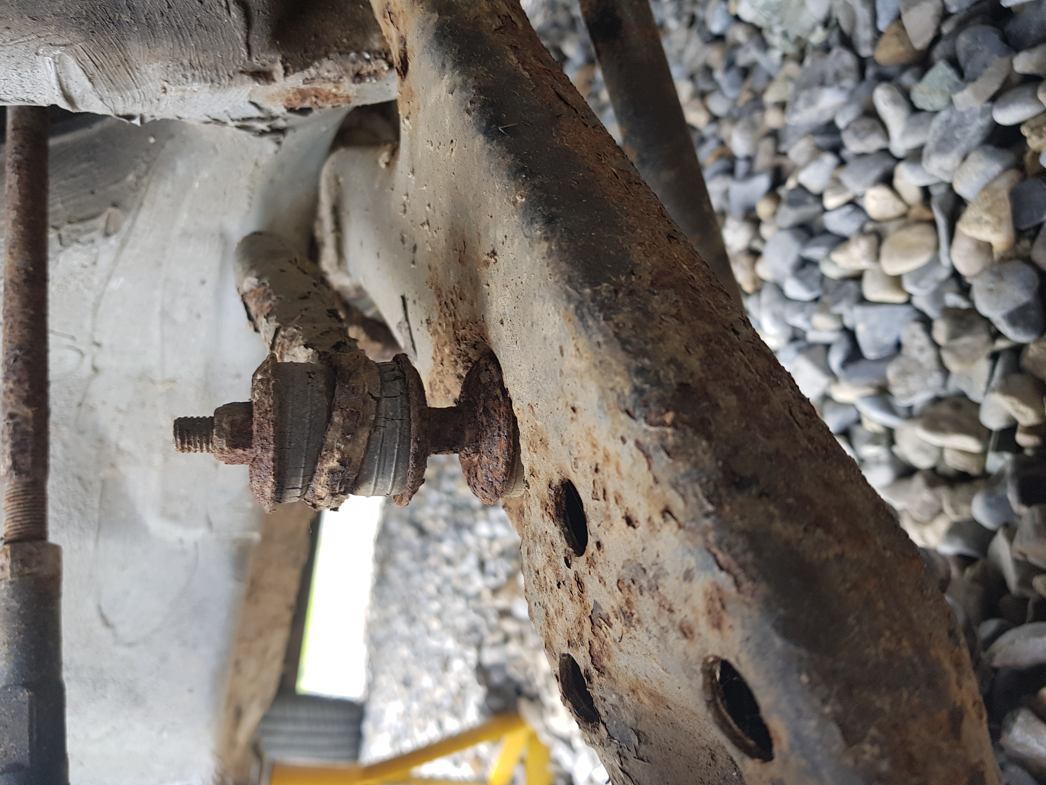

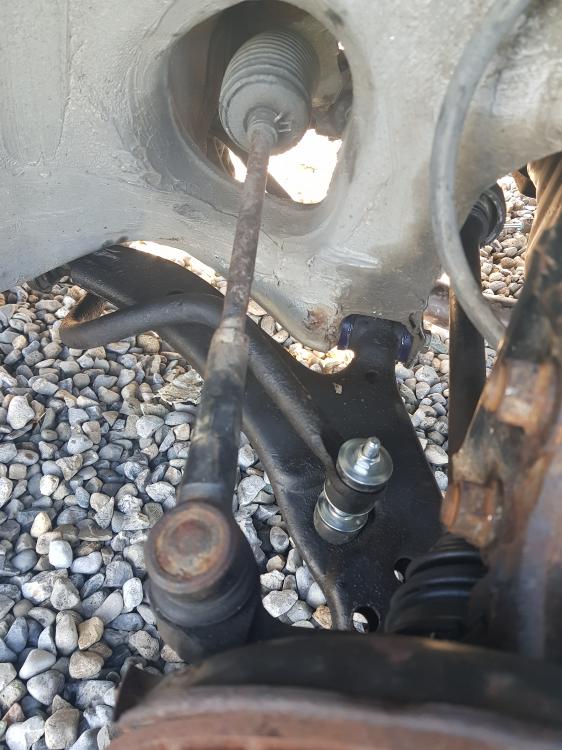

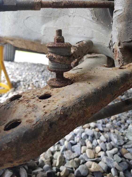

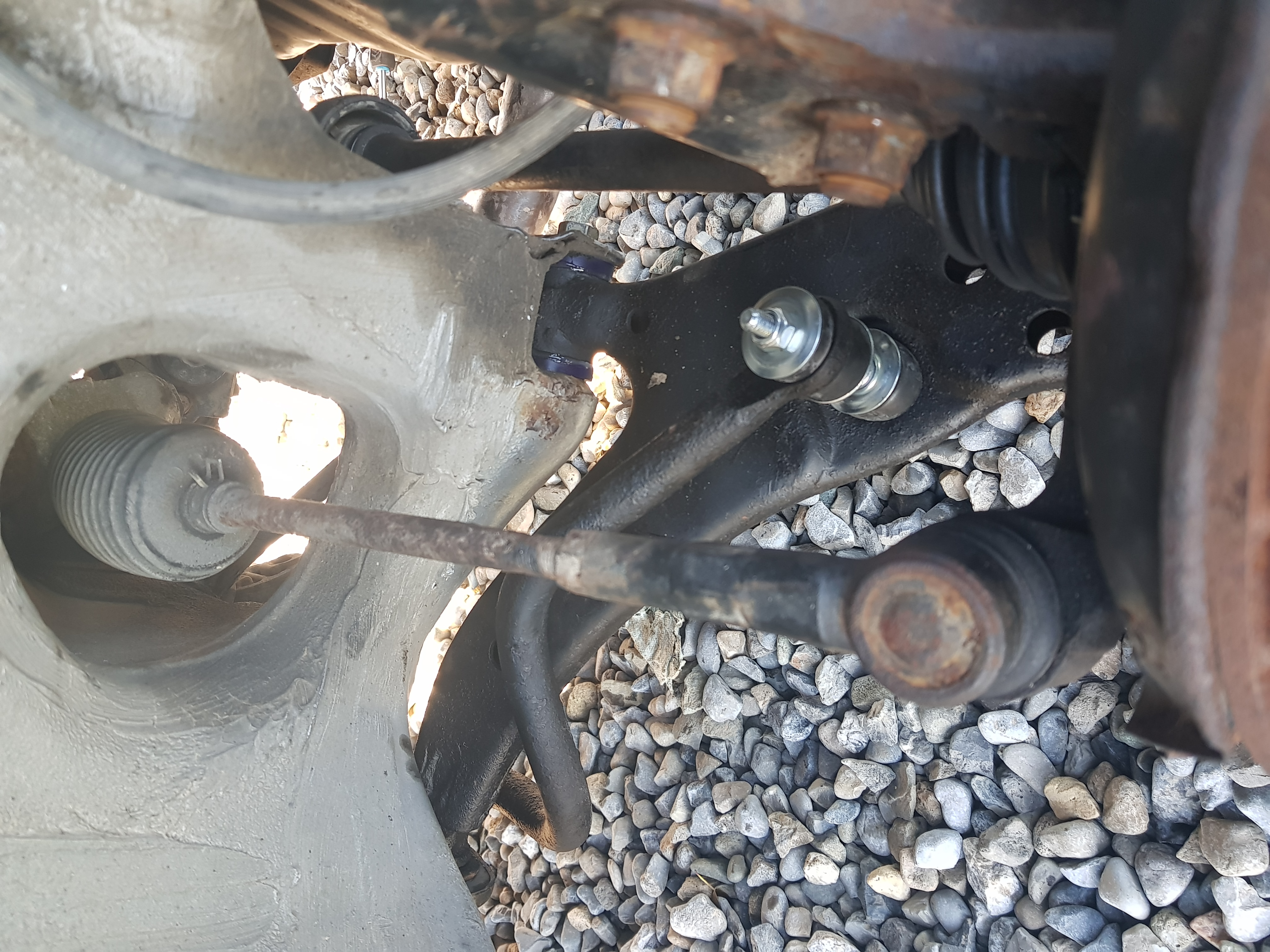

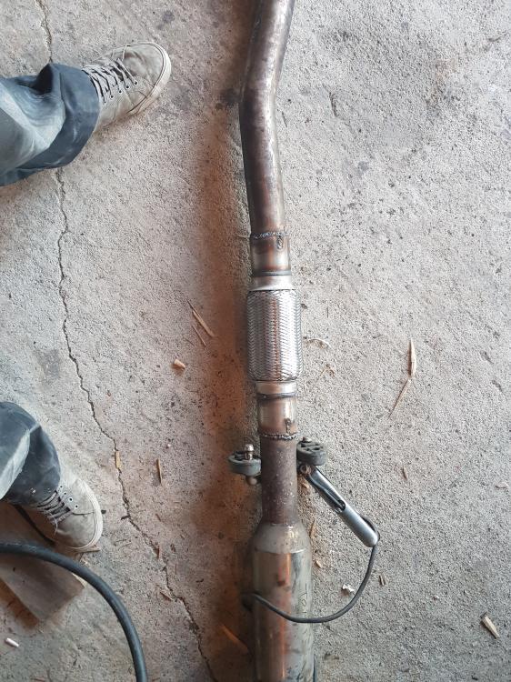

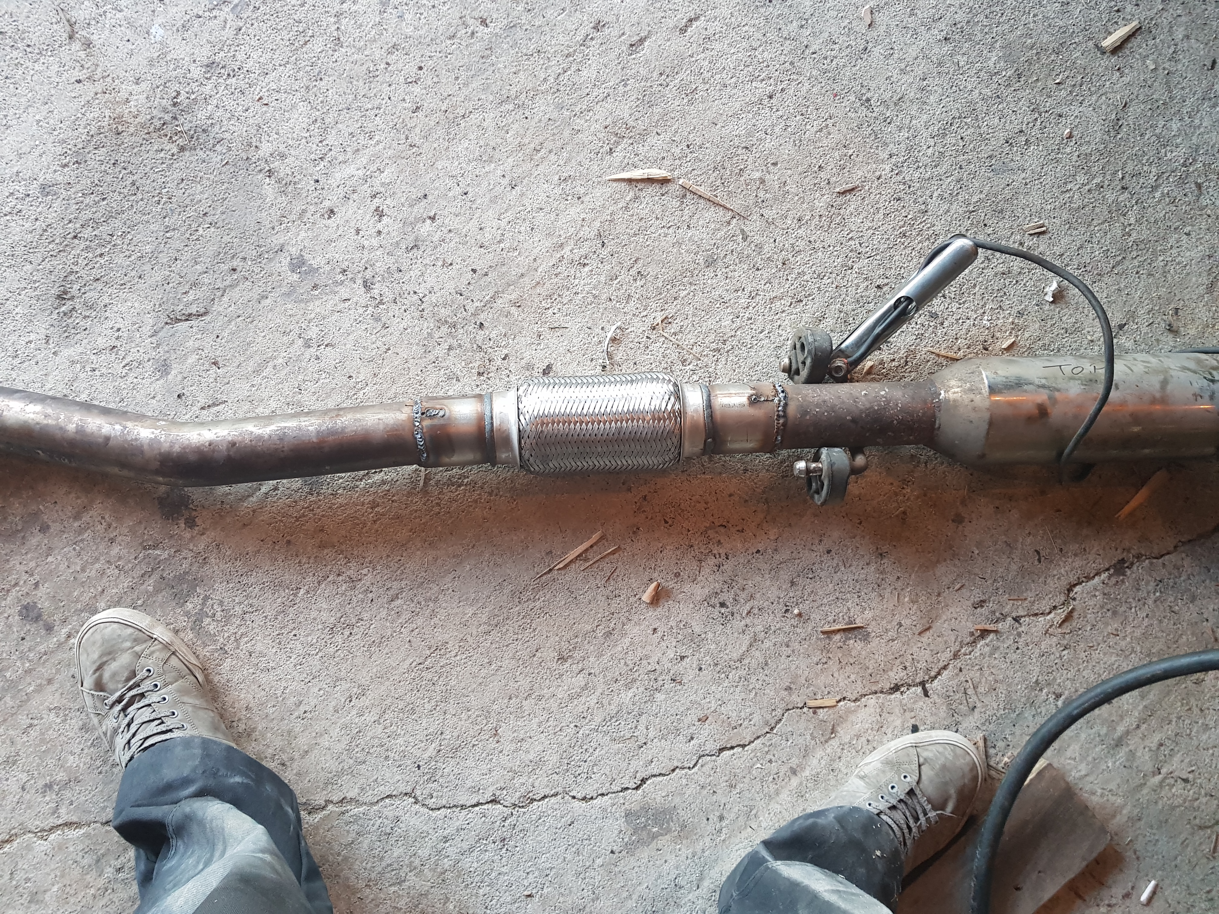

O/s inner and outer cv boots, Front arm pollybushed, Arb pullybushed and new drop links, Coated the front arms and arb in undercoat and welded in a new flexi pipe.
Excuse the shit welding i made do with my mig
Before:20180507_112304.thumb.jpg.29ce03cc8e18ca
After:20180507_171006.thumb.jpg.5489941b0579c9
20180507_171019.thumb.jpg.4ab938283572ab
Exhaust flexi replacement:20180507_195008.thumb.jpg.e33c6422c54b5b
I left the exhaust section off as next weekend i hope to have a look at my handbrake cables - no handbrake at all, and get a few more bits done but as fsr as i can remember all the bits under the car are done. Biggest thing on the list is a cat converter which i was hoping to get another downpipe and weld it into that.

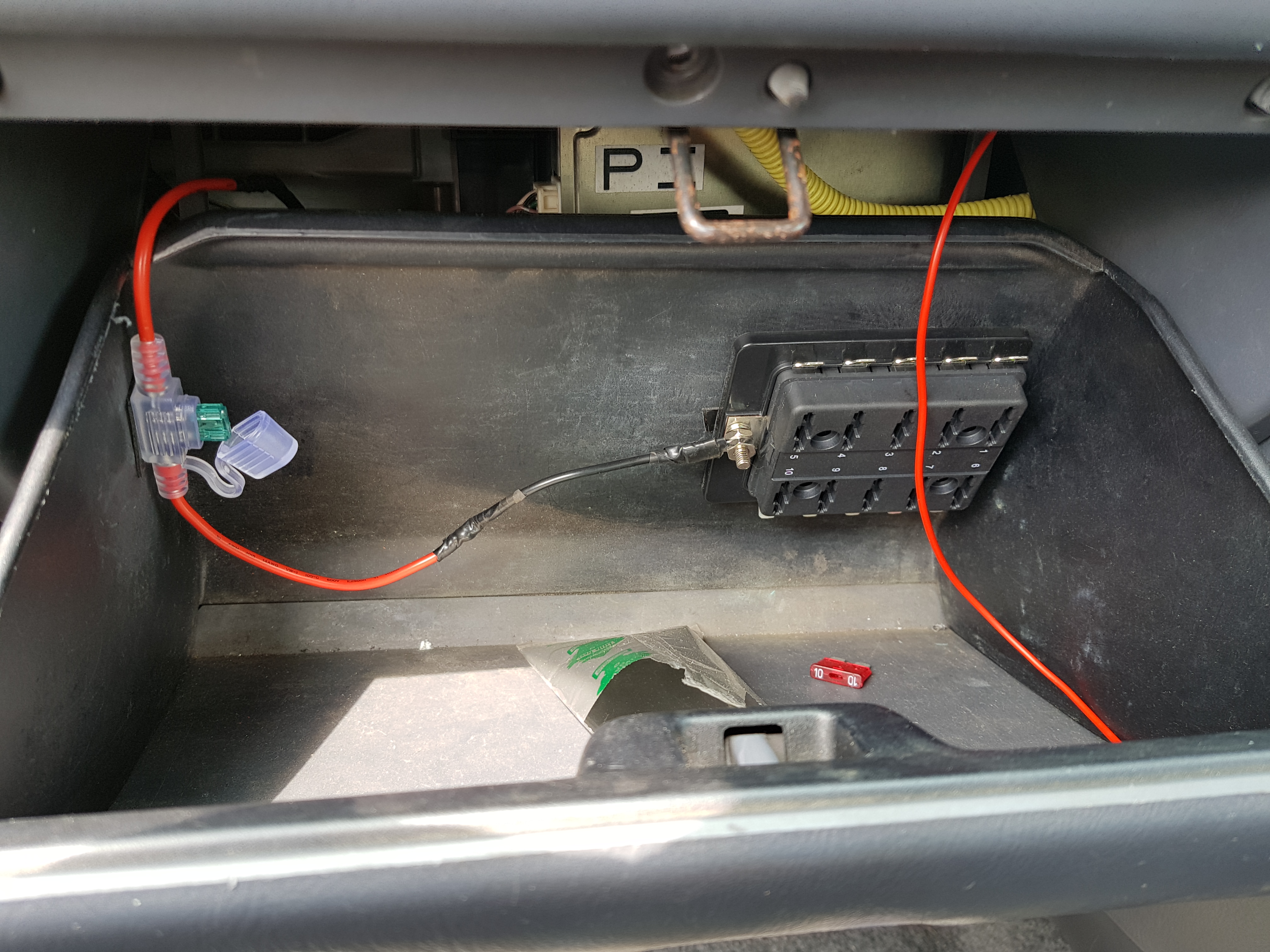

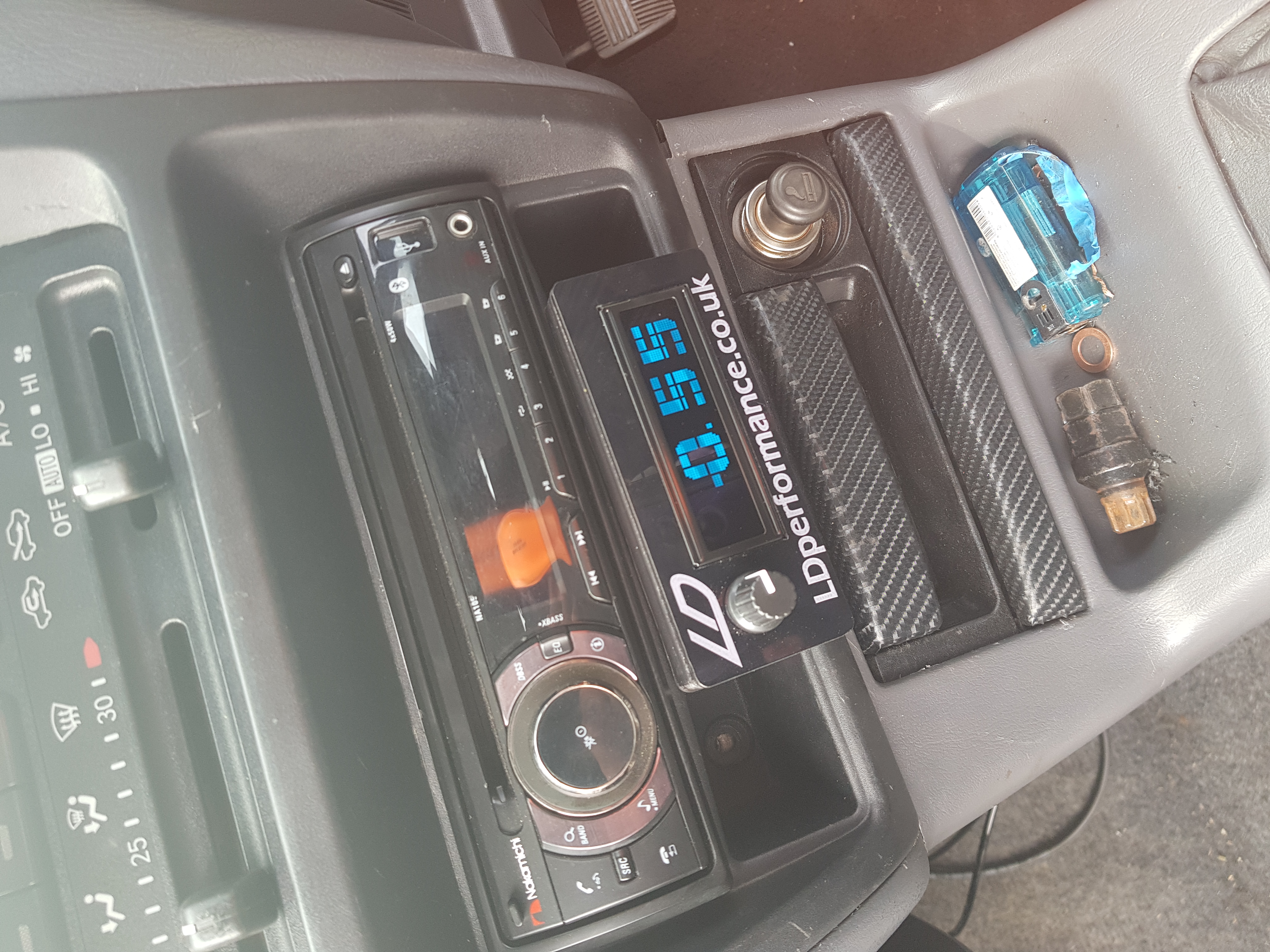

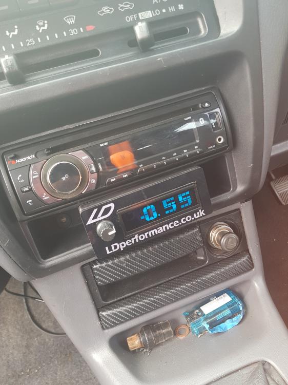

Boost controller with mac solenoid wired in and working as far as i can tell. Ran off an auxillary fuse box. 20180526_150052.thumb.jpg.58a62b3c897d46

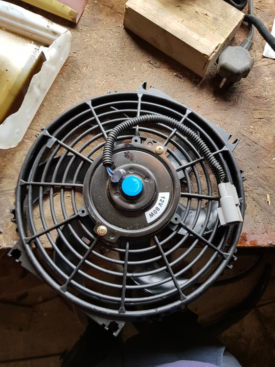

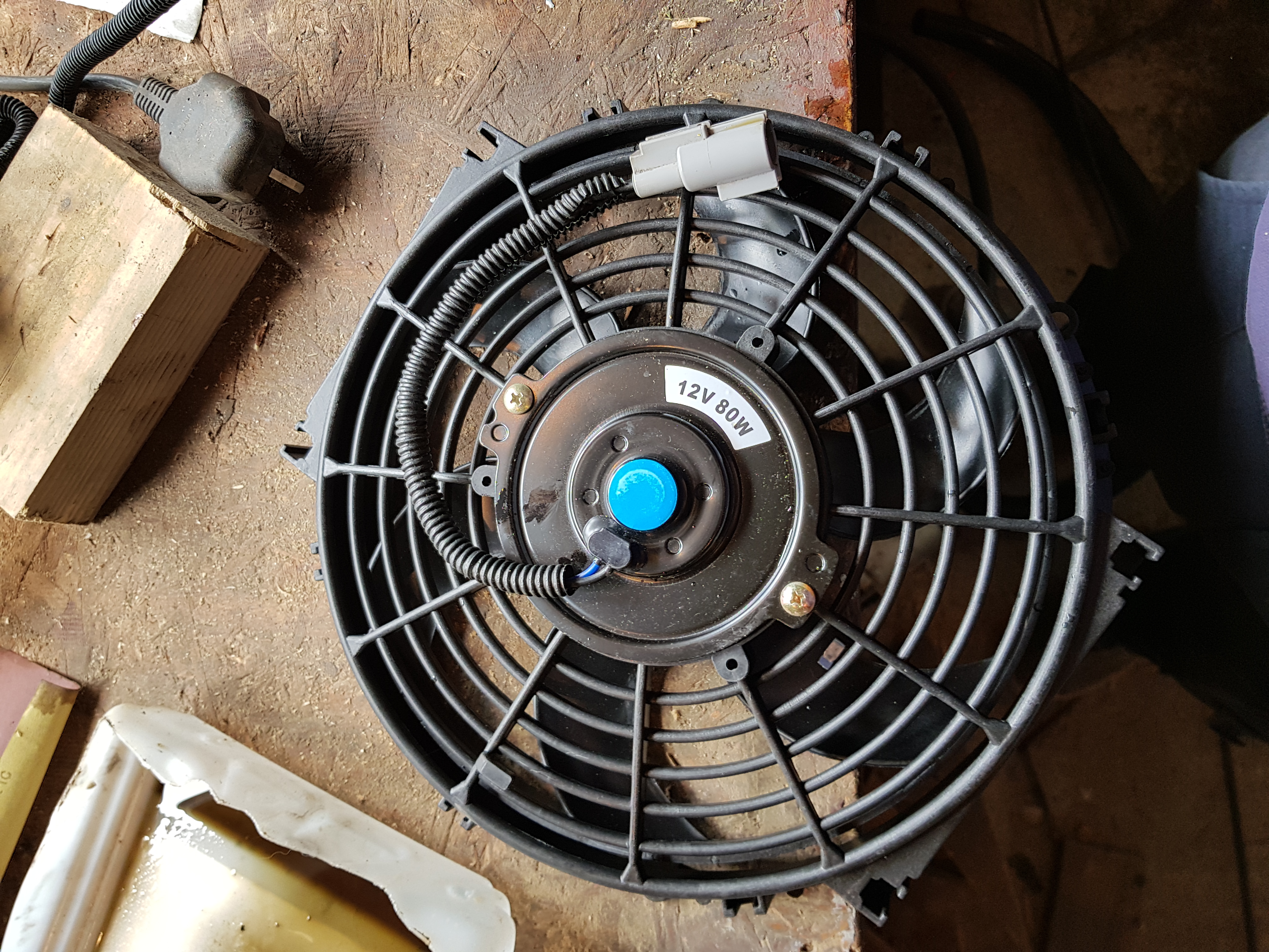

Slimline fan attached and wired using oem plug 20180526_132558.thumb.jpg.79631a7de6cf6abut not working. Dont have a 12v feed going to it when its supoosed to kick in. Temp sensor seems to be working as theres power to the signal of the relay in the fusebox.

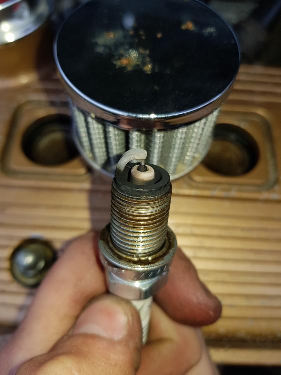

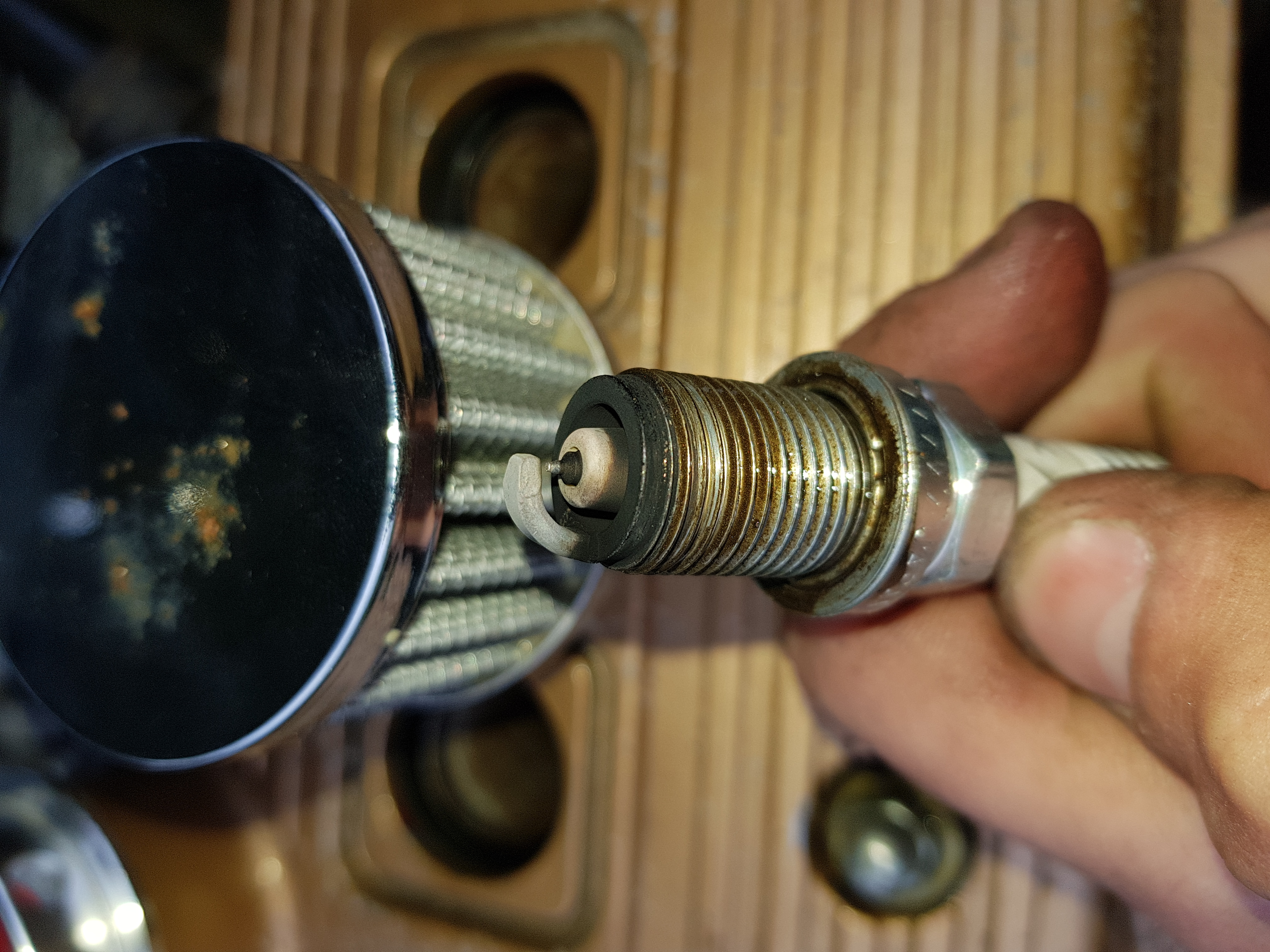

Very bad under load its coughing and spluttering all the time with no power. Under light load she'll keep going but get worse as boost and throttle input rises. Plugs look to be quite sooty (ngk iridium 7's)20180526_174900.thumb.jpg.0948fff7fff835
Ive just cleaned the rotor arm with sandpaper and will test tomorrow and check the coil earth to chassis. If gone ill order a new cap and rotor. If not, ill start with the cap rotor and onto the leads and work back. I will be borrowing a timing gun and checking that also as mines gone walkabout.
