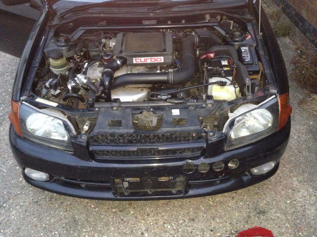

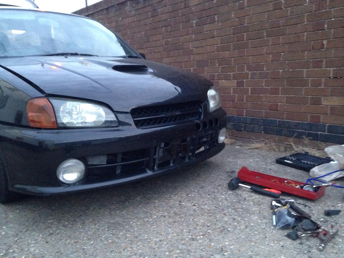

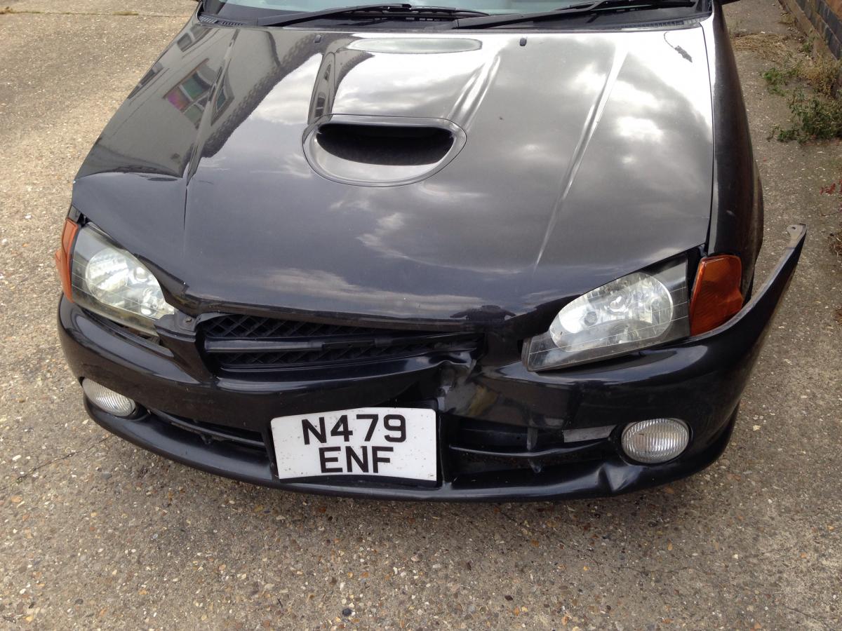

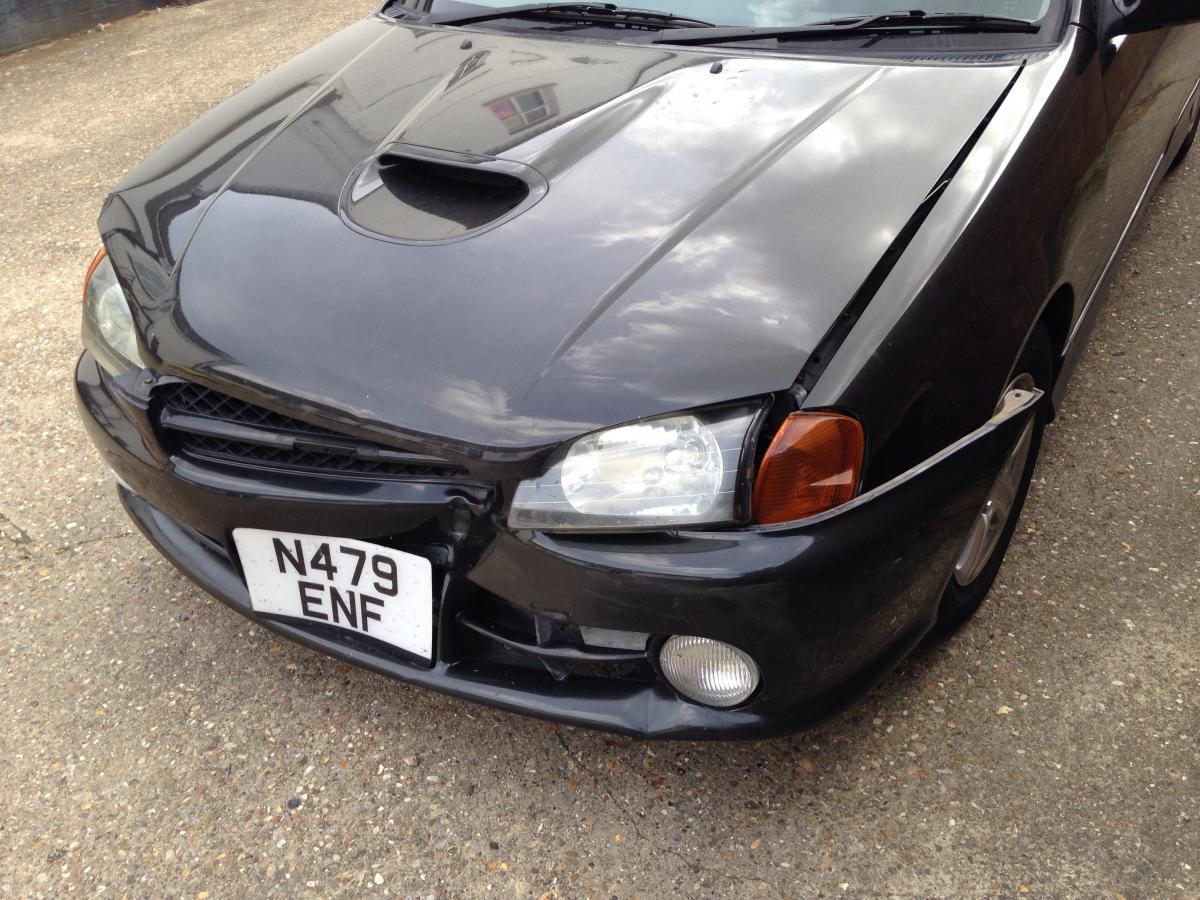

pdg190 Posted July 18, 2015 Posted July 18, 2015 So this morning my glanza attacked the back of a Passat fitted with a monster tow bar. I'm choosing to blame the cold pads and not the moron trying to squeeze through the amber light. The Passat come away without a single mark so I don't think insurance needs to be involved if their just going to write my car off? Was wandering if anybody could offer any advice on the less obvious parts I'm going to need to fix it or wether they are all bolt on parts, or if the cost is going to be that high that I might as well go through insurance?Thanks Quote
Vturbo Posted July 18, 2015 Posted July 18, 2015 (edited) I'm no body work expert, but that looks like a new crash bar and bumper. Bonnet don't look bad.Maybe a few other bits Like a new radiator if it's damaged. I wouldn't go through insurance if it's not needed. more pics would do nicely, maybe AC radiator too Edited July 18, 2015 by Vturbo Quote
5e colin Posted July 18, 2015 Posted July 18, 2015 thats minor damage mate easy fix by the look of it bottom bar aint touched so your a lucky boy Quote

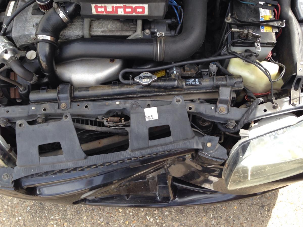

pdg190 Posted July 18, 2015 Author Posted July 18, 2015 (edited) On closer inspection it's damaged the bumper, bonnet, head lamps, one indicator, rad, fan and horn. Not to sound like an idiot, but the crash bars the lower bar that's bent? Edited July 18, 2015 by pdg190 Quote

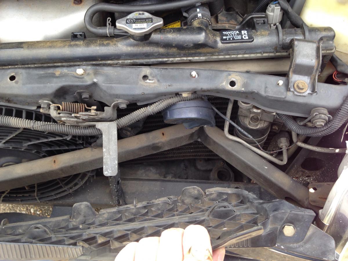

morgey Posted July 18, 2015 Posted July 18, 2015 The slam panel is spot welded in i believe thats the bit with the bonnet catch. The bar thats pierced your rad is the bumper support/crash bar that bolts on. Quote
Ollieh17 Posted July 18, 2015 Posted July 18, 2015 I have a bumper suppor/crash bar available mate let me know if you are after one Quote
Mitchell Posted July 18, 2015 Posted July 18, 2015 Just find somebody local to you who's breaking one, drive down an unbolt all the bits you need in one go, really should be able to have it back on road in a day with the help of q couple mates Quote
akyakapotter Posted July 18, 2015 Posted July 18, 2015 heat that bumper up bet it pops back out Quote

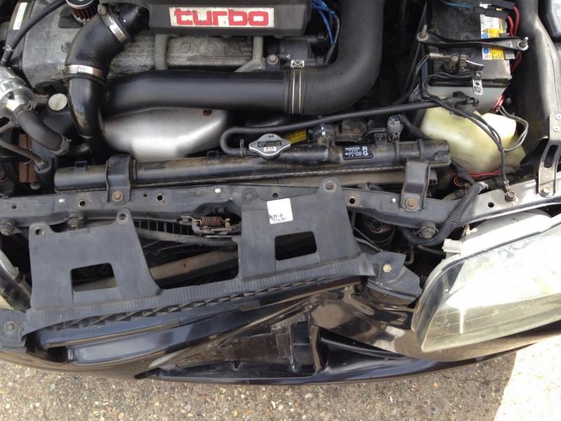

fordie_glanzaV Posted July 18, 2015 Posted July 18, 2015 Looks all bolt on parts apart from slam panel as mentioned is spot welded.Aslong as lower cross member and chassis legs are ok which i reckon they are, ull be ok.. Bonnet hinges always weak point too if u have troubles re-aligning bonnet. Quote

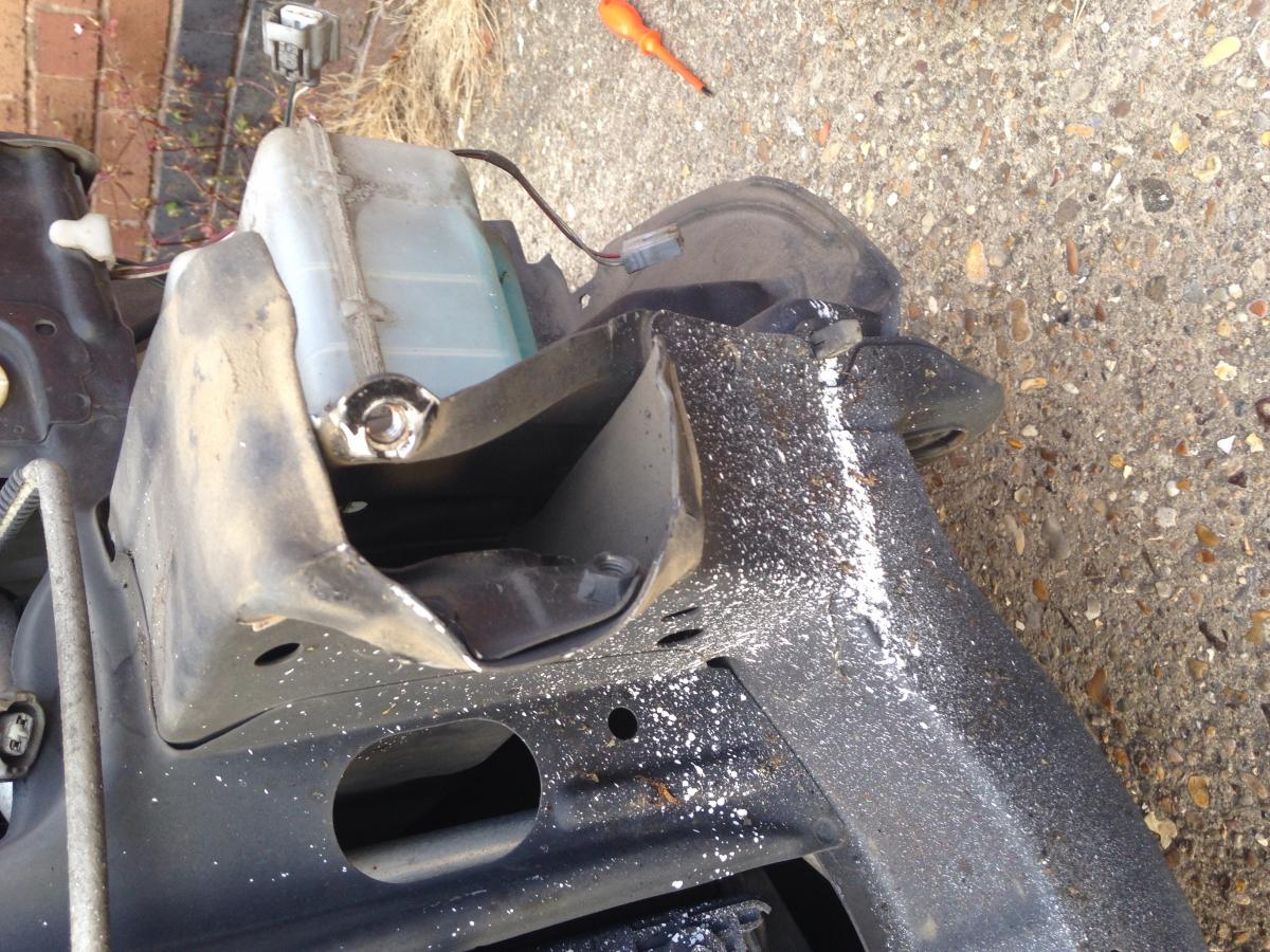

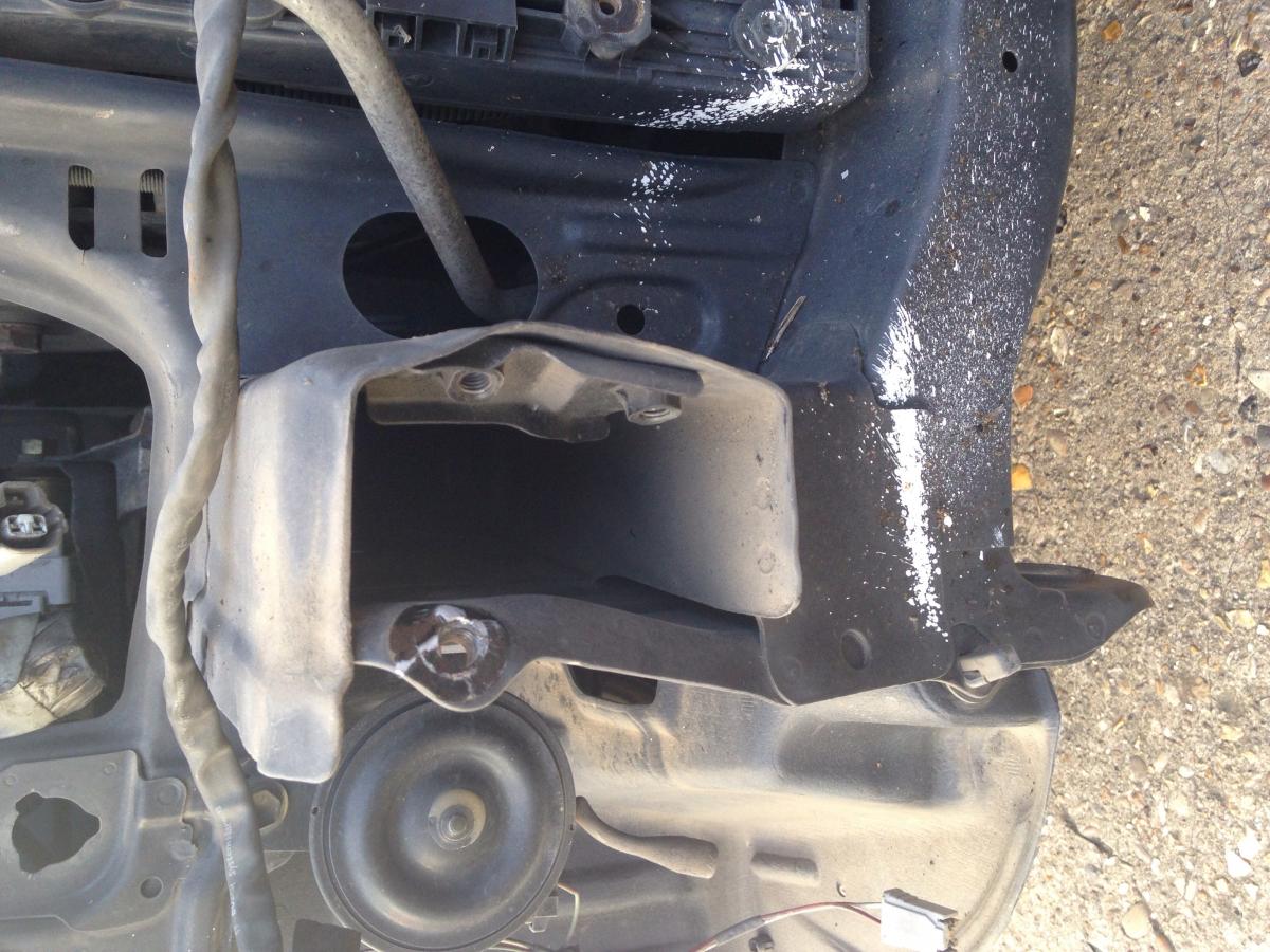

pdg190 Posted July 19, 2015 Author Posted July 19, 2015 So after having a proper look I think the only places I'm going to have an issue are where the crash bar bolts on, drivers sides not too bad but passenger sides a bit of a mess. Been belting it for ages and I can't get it to move, maybe get a torch on it?? It has split the metal, but only by 10mm at the side. Been desperately working away to get it half presentable to run over to trax tomorrow, got everything as close as it's going to be without new parts only to find when I ran it up to temp my rear rad fan is fouling the metal cover. Out of light, out of patience. Thanks for the help so far. Quote
pdg190 Posted July 19, 2015 Author Posted July 19, 2015 Nuts!!! Didn't think to ask if anyone was going that had parts. Will get in touch if I can't find something being broke locally with all the parts I need. Really appreciate the offer. Would have been at least one thing off my shopping list. Anyone know if the slam panel and crash bars are same on N/A? Quote
morgey Posted July 19, 2015 Posted July 19, 2015 Slam panel is, not sure on crash bar, they might be bumper specific so might need a 96 spec glanza one but dont quote me on that. Try jdm-ep in the traders section. They should have most of what you need Quote
