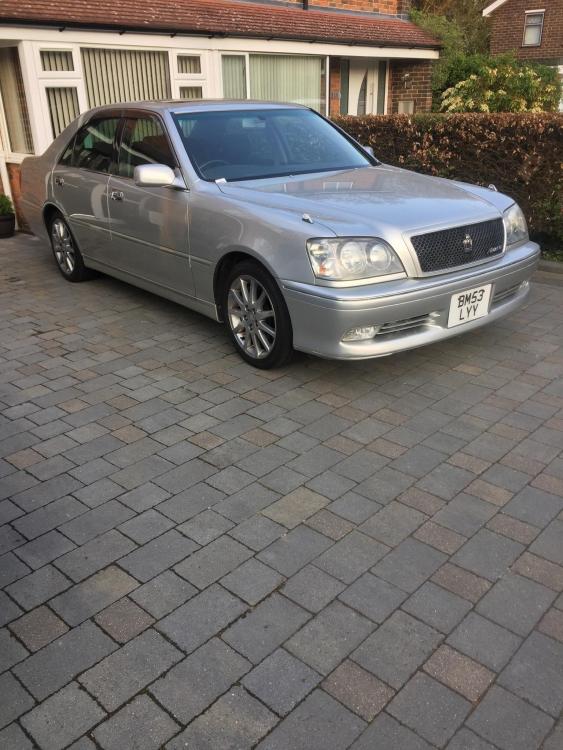

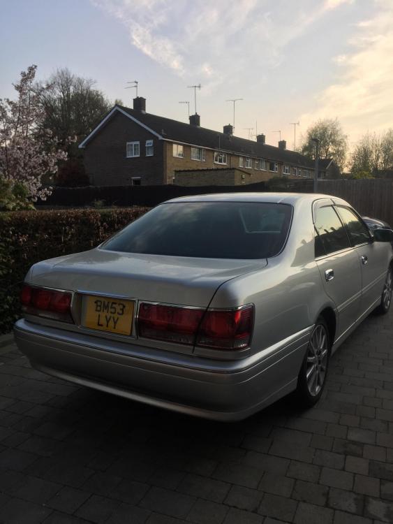

Its been parked up, started doing the mods that i wanted to do in first place and my daily failed mot, bought another daily and that started to play up so had to get rid of it. Finally have something now. So the work on starlet continues.
Got lots of work to do but hopefully will be back on the road
