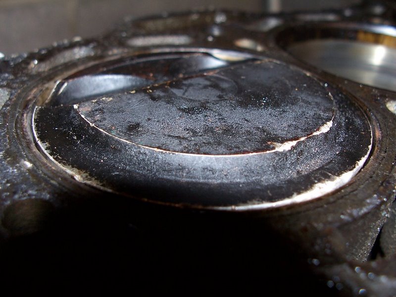

daniel_g Posted September 28, 2015 Posted September 28, 2015 Duno if id be able to get any useful info from these Gen1 pistons or not?!.. Quote
5e colin Posted September 28, 2015 Posted September 28, 2015 (edited) daniel i cant see shit bring up a piston a bit this is a gen1 look at the mahoooosive dome Edited September 28, 2015 by 5e colin Quote

daniel_g Posted September 28, 2015 Posted September 28, 2015 daniel i cant see shit bring up a piston a bitTomorrow Quote

5e colin Posted September 28, 2015 Posted September 28, 2015 (edited) lol would 2pac not do atleast piston nr2 has a smiley face now Edited September 28, 2015 by 5e colin Quote

daniel_g Posted September 28, 2015 Posted September 28, 2015 lol would 2pac not do atleast piston nr2 has a smiley face nowBit of metal putty and it would be brand new again! What about Wiseco 9:1s, wouldn't they do the job?They might even do a higher CR if you asked them nicely. Are the 9.1 the flat tops? Quote
