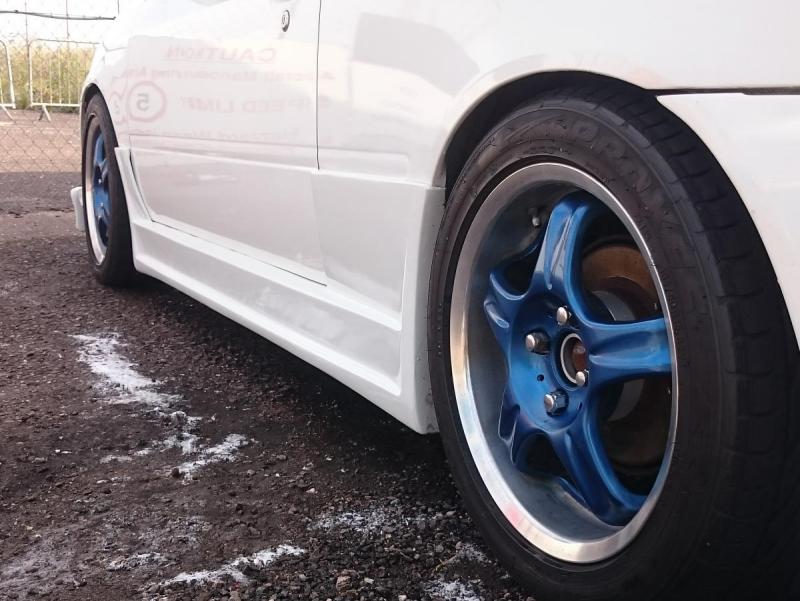

akyakapotter Posted October 5, 2015 Posted October 5, 2015 (edited) Edited October 5, 2015 by akyakapotter Quote
Sefton-EP91 Posted October 5, 2015 Author Posted October 5, 2015 (edited) I love how flush the wheels are with arches on your glanza nick! Looks lovely mate! Jealous! im going to look into some h&r spacers! Look at getting same size. I just want abit more stance Anyone got any idea what the centre bore diameter is of a glanza? Is it 54.1mm? Thanks Edited October 5, 2015 by Sefton-EP91 Quote
Arnold Posted October 6, 2015 Posted October 6, 2015 tmp_7617-post-8483-0-59761300-1436031525_thumb-476067062.jpg Nice. I guess I can't buy the same size spacers in case my wheels are a different offset, but they're definitely on my shopping list Quote
