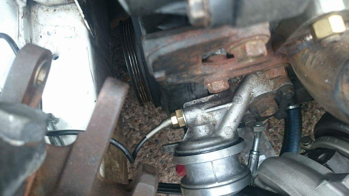

akyakapotter Posted November 14, 2015 Posted November 14, 2015 Akyapotter is that an innovate sensor? Whats the thread on the relocator?No its stri I'll dig out the packaging later after ive had a sleep just got off night shift. Quote

akyakapotter Posted November 16, 2015 Posted November 16, 2015 I will see if the package is still in my wardrobe when i get home at about 8:30 think its m16 x 1.5 x 1/8npt but let me check Quote

RobSR Posted November 17, 2015 Posted November 17, 2015 The oil filter housing above is m16x1.5mm Quote
Flaminsam Posted November 27, 2015 Posted November 27, 2015 My temp sensor is in the same place as akyakapotters (nicks) saves on sandwich plates but not ideal as its behind the power steering bracket :/ Quote
