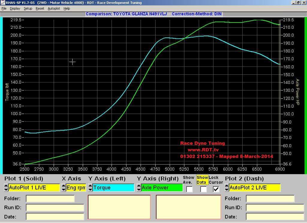

ro55ifumi Posted November 28, 2015 Posted November 28, 2015 Paul Sent you the graphs when mapped at TD, have asked Will for a copy as can't find them on this pc.It was 218 on TD map and finished at 220 at Will's John Quote
paulgtt Posted November 28, 2015 Author Posted November 28, 2015 Cheers John, if you can get hold of the other graph aswell that would be good. Quote

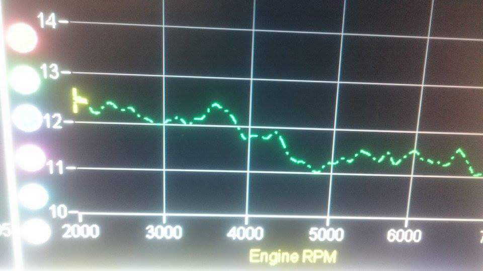

ro55ifumi Posted December 1, 2015 Posted December 1, 2015 (edited) Paul Here you go with afr shot toJohn Edited December 1, 2015 by ro55ifumi Quote
