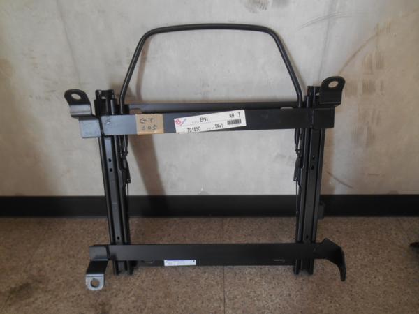

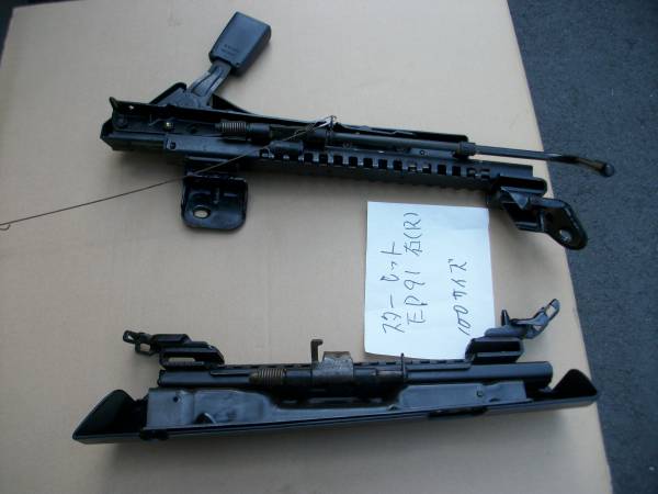

Cammy R Posted December 24, 2015 Posted December 24, 2015 May be a bit of a noob question but i'm trying to understand the different rail types and how they are mounted etc.The first type being a bride rail seems easy enough to understandi imagine this would work with most bride seats and from what i am reading it can also work with recaros with some adaptor plates.But the ones like the photo below that i see on the jap websites really confuse me maybe because i'm just no understanding it or there is something missing but how do they work its just like two sides and i'm unsure how that would mount with a seat haha as there is nothing along the middle also how are you meant to know which seats fit what?If someone could point me in the right direction of a guide or help me out that would be fine, trying to read the translated japaneese is like trying to understand hyrogliphics of the side of a pyramid in the middle of a sandstorm while someone throws buckets of water at your face, any help appreciated Quote
BMX-RIG Posted December 24, 2015 Posted December 24, 2015 Ive actually got a bride rail with an adaptor plate, the plate bolts to the seat then the plate has threaded holes which allows you to bolt it to the rail.The rails that are seperate bolt straight to the seat with no adaptor plate, you slide the rails all the way foward to allow the bolts to go in the back, put those in then slide the rails all the way foward which allows the fronts in i recently ha to sort a rail out for my recaro sr3 so it was a learning curve for me lol Quote

BMX-RIG Posted December 24, 2015 Posted December 24, 2015 I emailed capital seating about which rail to use, this is the one i boughthttp://www.demon-tweeks.co.uk/motorsport/seat-mounting-frames-universal/recaro-double-locking-runnersDoes require you to mount your own seat belt buckle to it but if you run harnesses there no issue lol, the chop the feet off your oem rails and bolt them to it you could also seap feet to suit different cars! They sit about the same as ep91 recaro rails! if you want any photos i can get some Quote
