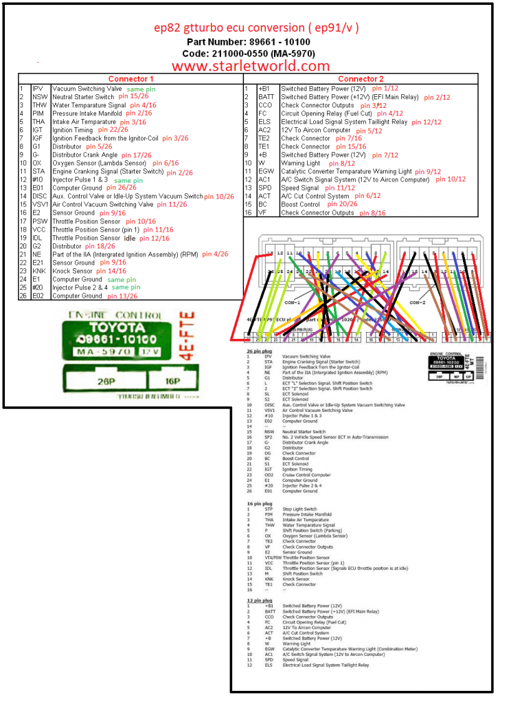

5e colin Posted January 9, 2016 Posted January 9, 2016 (edited) you have to compare each pin on the ep82 and 91 ecy pin outs then match the wires from the ep82 plug to the acording pin on any of the 3 plugs on the glanza this is for the v ecu in the starbo just use different sex plugs and it will turn in 1 suited for you Edited January 9, 2016 by 5e colin Quote

5e colin Posted January 10, 2016 Posted January 10, 2016 just for future readers i went from gt to v plugs so on the gt pinout i written down next to them what pin they go to on the v i know the drawing aint the best ha ha best i could do at the time Quote
Stu Posted January 13, 2016 Posted January 13, 2016 Handy diagram - Ive done that wire up a few times now. One setup for a Jam ecu I spliced in above the original plugs as the owner wanted to be able to swap between the ecus (for some reason) Quote
5e colin Posted January 13, 2016 Posted January 13, 2016 handy indeed stu free 300rpm increase for us gtt boys he probly wanted to mess with his setups till he found something that matches ecu readings well ? Quote
