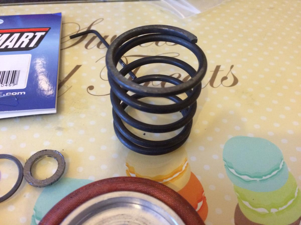

aleximport25 Posted January 24, 2016 Posted January 24, 2016 Right guys I've stripped down my fake turbosmart ultra gate to replace the diaphram and noticed there's only one Spring which is unpainted shouldn't there be another spring in there ? Quote
Sefton-EP91 Posted January 24, 2016 Posted January 24, 2016 Depends what the pressure of the Spring is, if it hold boost until your desired boost is achieved then no need for another Spring in there! I'm sure that's correct. If I'm wrong I'm sure someone will correct me! Quote
Whitenoize Posted January 24, 2016 Posted January 24, 2016 You only run one spring mate you can put two in but best just to use the correct spring in the first place Quote
5e colin Posted January 24, 2016 Posted January 24, 2016 the 2nd spring is usually for higher boost level in those kits like 10psi spring and 4psi spring together they make a bar etc etc Quote
aleximport25 Posted January 24, 2016 Author Posted January 24, 2016 Awesome that's all I needed to know :-) I'm going to get some grinding paste on the valve for piece of mind while its in bits. Quote
ChrisLeeBoost Posted January 24, 2016 Posted January 24, 2016 mine came with two springs Alex the small one boosts .7 and the larger one in presuming boosts .3 because it's 14psi in total with the both of them installed Quote
aleximport25 Posted January 24, 2016 Author Posted January 24, 2016 Nice one cheers Chris. As long as that's ok I'm happy. Quote
