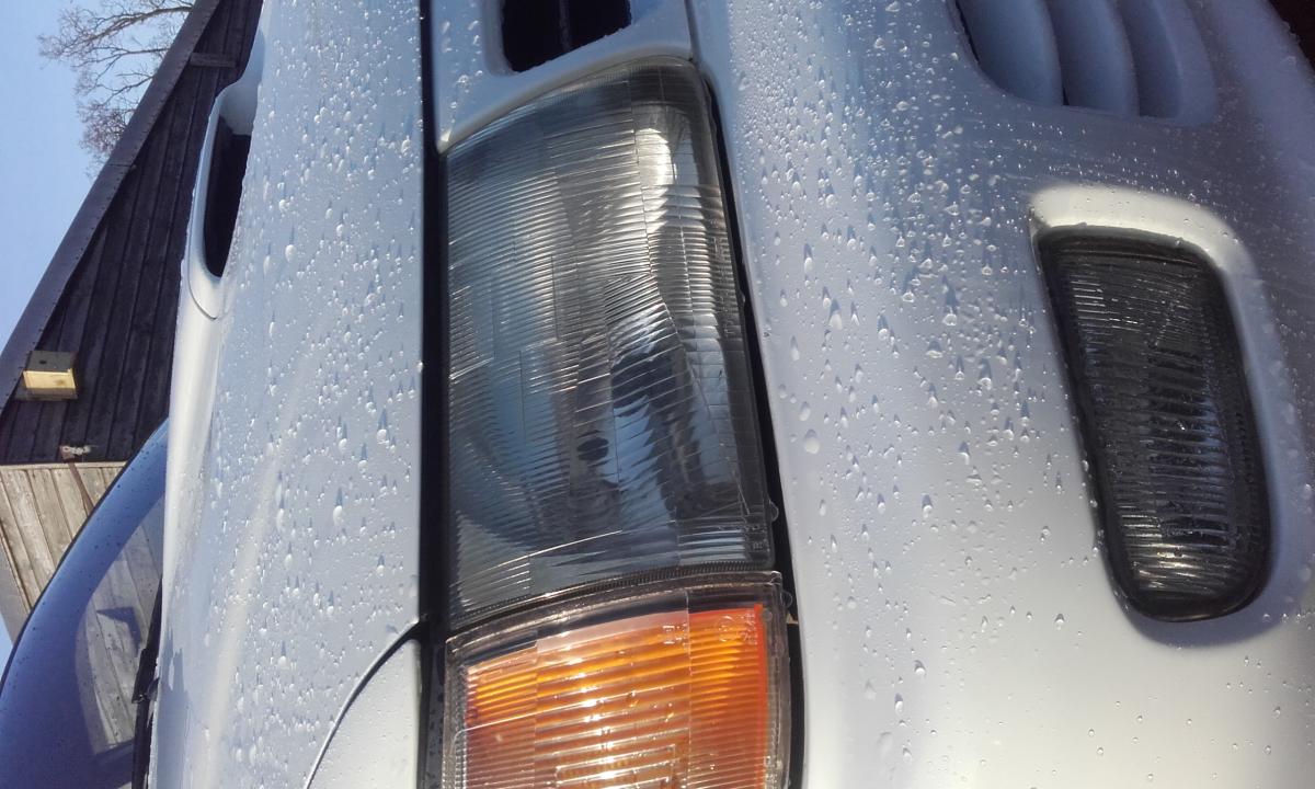

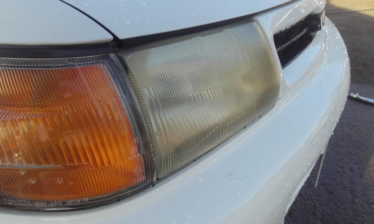

Dale SR Posted February 28, 2016 Posted February 28, 2016 I heard that toothpaste is ment to be a good cleaner for dull headlights. I was very surprised with the results! All I used was collgate and a good bit of Elbo greese, no taking the lights apart just a clean on the outside of the lense.Before:After:Sorry for the upside down picture I'm not sure how to sort it Quote
Gainzy Posted February 28, 2016 Posted February 28, 2016 I used a machine polisher and just a cutting compound the difference was amazing most people don't realise how bad they are till they clean one! Quote

aleximport25 Posted February 29, 2016 Posted February 29, 2016 ive done the toothpaste trick, doesn't come out too bad not as good as the proper stuff but defo works on the cheap :-) Quote
