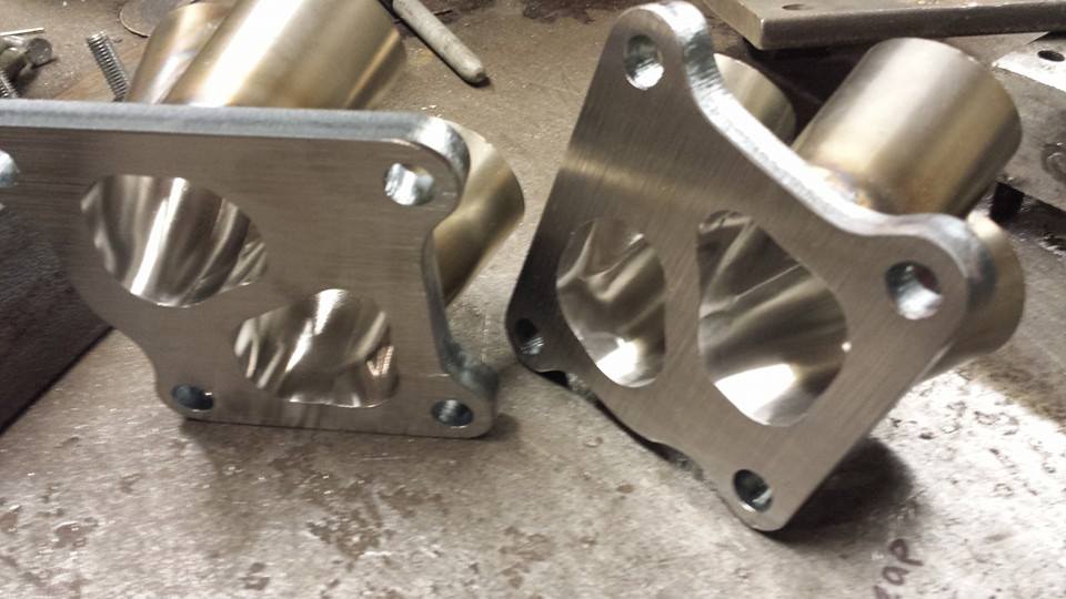

and while we wait... here's my idea of a "professionally" made collector...
11745800_10153128181322809_5612235760437
we have access to cnc and we do offer all sorts of billet options for other vehicle platforms (evo/Rb/2jz etc). they are available to you guys with starlets too..but i dont actively push these because of the cost involved.
