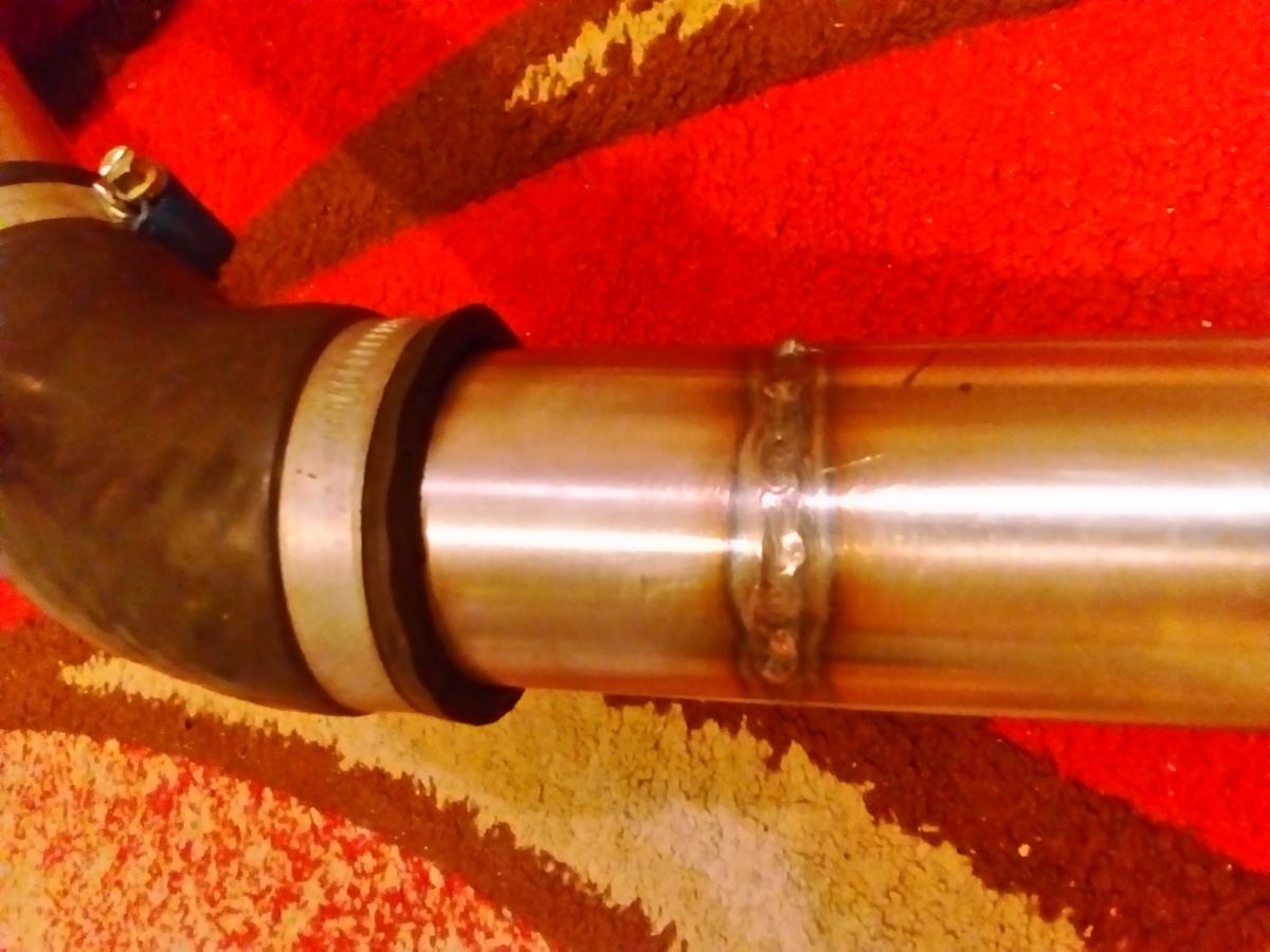

5e colin Posted December 11, 2016 Author Posted December 11, 2016 (edited) now after al the messing and trying today was the 1st time i thought i weld 2 exhaust tubes together as i use them for my turbo kit boost pipe to the oem topmount ( for now ) honnestly i am very happy with it as the practice tig welds where al on flatbar and on mild steel this ss stuff welds totally diferent dont ask me how it just is im not experienced enough to say why i forgotten to take pics when i was actually doing it ( sorry to exited ) but took 1 from it on the pipe put back on the topmount setup i know its not the prettiest but i tested it for leaks and its not leaking so good start ha ha was at 60A + - as my yoke is not digital 1.6mm red tungsten and no filler on most just on the back where i got a little hole i dipped some filler in to save my 1st work ha ha now i touch puddle ruffly every 20 seconds was every 3 seconds when i started so progress indeedto me it seens using bigger tungsten and filler rod is easioer to weld ( for me ) let the pro welders say something on current speed etc as i am still green behind the ears with this cheers Edited December 11, 2016 by 5e colin Quote

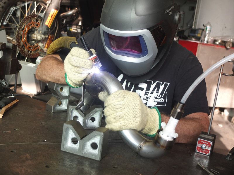

5e colin Posted December 11, 2016 Author Posted December 11, 2016 (edited) fuck me seeeeeeems like i am holding the torch wrong !!! i hold it at the stem where the hose connects the section of bar going to the front ( ass my trigger switch is cabletied on to it ) look at this fucker holding it haaa !!! Edited December 11, 2016 by 5e colin Quote
SpikeyJp_68 Posted December 11, 2016 Posted December 11, 2016 I've never tigged before but that looks pretty damn good for one of your first attempts Quote
5e colin Posted December 12, 2016 Author Posted December 12, 2016 1st attempt on ss indeed going to order a footpedal now and try holding the torch like the pic above also some welding gloves ha ha as i burned my thumb many times ] i also did non of that back purging crap and al that as its not worth it yet as im only starting to Quote
