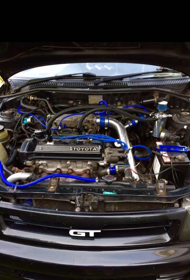

patman Posted June 9, 2016 Posted June 9, 2016 Hello Bug mate sure did, didn't come out to bad either, used some black sealant on all 4 corners and cams, and as tightened the nuts down and some sealant comes out the corners of the cover just wiped it away with a cloth, (pic below) haven't had time to sort out the dastek, I might just put it back up for sale on here as I have a feeling gonna need to travel quite far to get it fitted etc. Quote
Bug679 Posted June 9, 2016 Posted June 9, 2016 That's a nice clean looking bay there man loving it 🤗 The black and blue just looks sexy Pity about the dastek man sure it'll sell no bother but sure if it to much travelling puts a downer on things lol but ya should think of the fun you'd have coming back 😝 Quote
patman Posted June 10, 2016 Posted June 10, 2016 That's a nice clean looking bay there man loving it 🤗 The black and blue just looks sexy Pity about the dastek man sure it'll sell no bother but sure if it to much travelling puts a downer on things lol but ya should think of the fun you'd have coming back 😝Thanks mate, although still needs tidying etc, this is what you would call a budget bay haha haven't put stupid money into it, and can only do bits at a time due to funds etc, to be fair mate haven't even thought about the dastek since we last spoke in pm, so I'm really not sure what to do now, if I could of hard wired it in myself then drove to wherever to get it mapped, wouldn't be so bad, but as its got a map on it from a 400bhp scooby was told not a good idea. Quote
