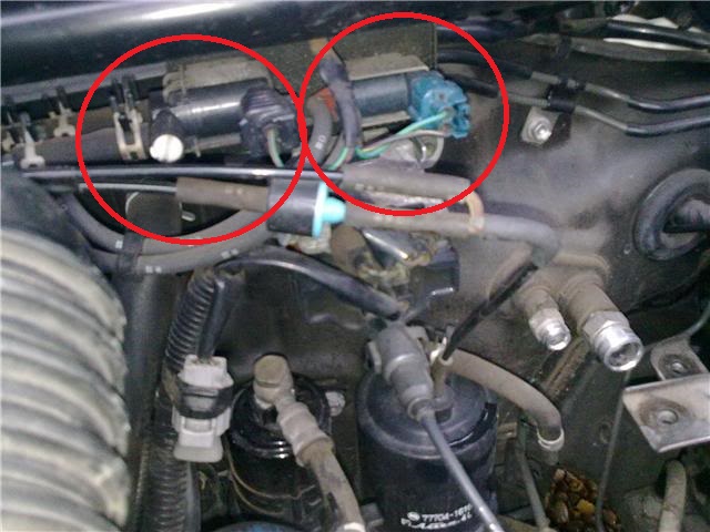

starletezy Posted June 10, 2016 Posted June 10, 2016 As above what are these for seen people delete them in the past can it be taken out? Cheers Tez Quote
5e colin Posted June 10, 2016 Posted June 10, 2016 yes airco related if urs is deleted you can remove them just block the pipes at the source i give you 5£ for the vsv and plug ( green 1 ) Quote
starletezy Posted June 10, 2016 Author Posted June 10, 2016 Cheers guys was abit unsure what they were for my aircon is been deleted so i guess i can go ahead and take them out Quote
patman Posted June 10, 2016 Posted June 10, 2016 Could you put some pics up please mate when you have done it, to see what's Being blocked off etc, I take it people just block the pipes of with a bolt or something? And what to do with the sensors just tuck them away? As I still have these in mine and if there a/c stuff it can go from mine thanks mate Quote
H_D Posted June 10, 2016 Posted June 10, 2016 (edited) the sensors/solenoids can be removed from the flrewall and the plugs can be tucked away neatly or you can chop them off the loom. Edited June 10, 2016 by H_D Quote
daniel_g Posted June 10, 2016 Posted June 10, 2016 Whip that carbon canister out aswell whilst youre at it (next to the fuel filter)The pipe from that needs to be left to vent to atmosphere, not blocked. You can fit an inline 1 way valve if ya really wanted. Quote
starletezy Posted June 10, 2016 Author Posted June 10, 2016 Could you put some pics up please mate when you have done it, to see what's Being blocked off etc, I take it people just block the pipes of with a bolt or something? And what to do with the sensors just tuck them away? As I still have these in mine and if there a/c stuff it can go from mine thanks mate Okay mate will takes some snaps once completed for you Whip that carbon canister out aswell whilst youre at it (next to the fuel filter)The pipe from that needs to be left to vent to atmosphere, not blocked. You can fit an inline 1 way valve if ya really wanted.Was thinking of doing that aswell can I just leave the pipe open to air? Quote
