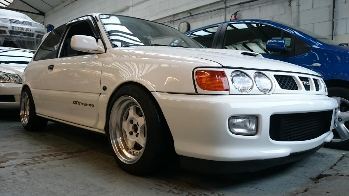

starletezy Posted July 20, 2016 Posted July 20, 2016 Here's an old pic of my gt running 7.5j ET 35 Cades wrapped in 195 tyres no mods were needed to the arches they cleared fine Quote
5e colin Posted July 20, 2016 Author Posted July 20, 2016 sweeeet ^^^^^ are you running spacers to clear the strut ?? how many mm clearance do you have between rim and shock Quote
Ollieh17 Posted July 20, 2016 Posted July 20, 2016 I had 8j et20 16" rota grids on mine with a 195/45 tyre. They came off a gt and fitted the GT alot better Quote
starletezy Posted July 20, 2016 Posted July 20, 2016 sweeeet ^^^^^ are you running spacers to clear the strut ?? how many mm clearance do you have between rim and shock Had around 3 fingers clearance from rim to shock Quote
