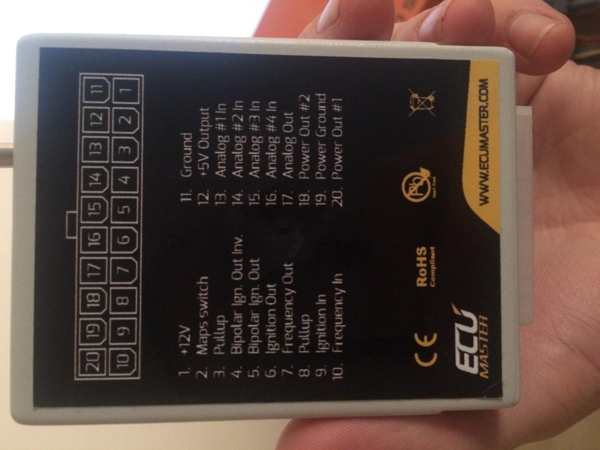

aleximport25 Posted September 14, 2016 Posted September 14, 2016 how do all,does anyone have any useful info to help me wire in my det 3 to my 3 plug ecu extension harness.i have the manual and a basic pin out for both the DET3 and the standard ecu. thanks in advance Alex. Quote
TrisK Posted September 14, 2016 Posted September 14, 2016 can you post the DET3 pin out? and are you 98 spec wiring? Quote

aleximport25 Posted September 14, 2016 Author Posted September 14, 2016 can you post the DET3 pin out? and are you 98 spec wiring? i shall get it when im home from work dude :-) You planning on using the fuel implant? this is where im unsure what are people recommendations ? Quote
richardc9052 Posted September 14, 2016 Posted September 14, 2016 If you just want it for launch control then go standard client. Otherwise go fuel implant. Stand-alone fuelling gives very good map possibilities. I would say, given the amount of combinations of inputs I would just let the person mapping it do the wiring. Plus the fact that in fuel implant mode you can't drive the car without a map so you would have to tow the car there if you hardware it. Quote
aleximport25 Posted September 14, 2016 Author Posted September 14, 2016 Cheers dude, I'll go for the stand alone fueling, the the two mappers I've been speaking are both local one is based in my village and does road mapping the other is about 10 miles away with rollers, they both would like a copy of the software to have a play with before hand. I was hoping to wire the det3 into the extension harness and run a vac line ready then just plug in at the mappers. Quote
aleximport25 Posted September 14, 2016 Author Posted September 14, 2016 can you post the DET3 pin out? and are you 98 spec wiring?It's 98 spec wiring dude Quote

aleximport25 Posted September 14, 2016 Author Posted September 14, 2016 Cheers rich, I've printed off a manual and just going to burn them to disc and drop them off, on the plus note I found on the ecumaster forum that they use the same plug as a pc motherboard power supply, just cut one off my old tower. Quote
