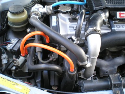

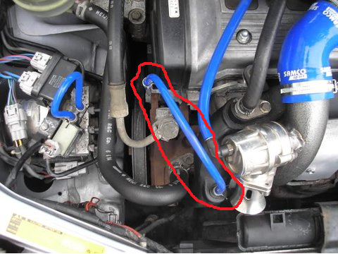

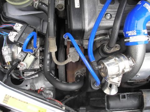

akyakapotter Posted October 23, 2016 Posted October 23, 2016 Here you go bud from this To this Where ever your solonide is take the side that goes to it off and loop it so its like the above pictures. Cheers nick. Quote

StuDoc 72 Posted October 25, 2016 Posted October 25, 2016 Right just to clear this up. All you need is the vac going from the compressor housing on the turbo to the top iirc nipple on the actuator. Absolutely everything else can be removed and pulled out. If you are still using the standard EFI pipe then just block off the nipple on that it isnt needed. Quote
