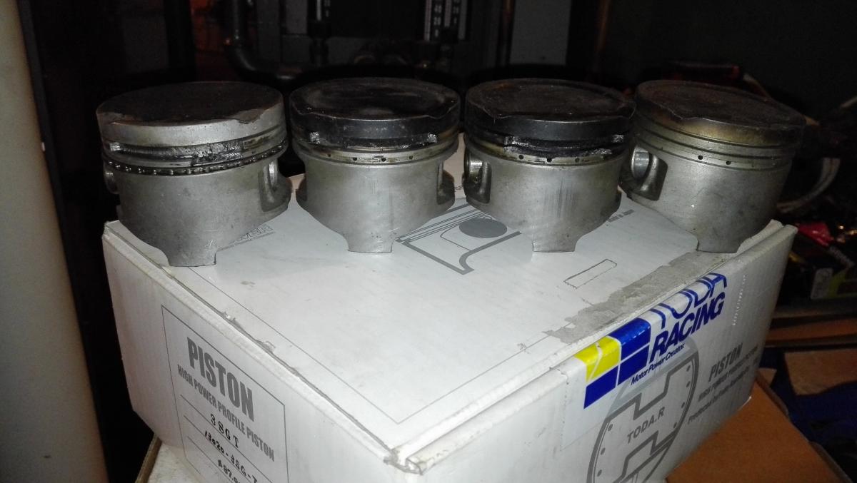

I have blown my pistons few times and all times engine were worked back to home easily, maybe little oil in windscreen, but it's only oil. Breather fumes act in good condition engine that way, that if You add more gas or rev engine a lot, You hardly see/smell/feel fumes, fumes comes only on idle. When pistons are gone, then when You raise revs, fumes comes very visible and oil fysically comes out from pipes and valves, maybe other seals too. Plus that ratling sound is there also naturally. Test Your engine this way, no need for compression test if pushing out out breathers when reving...
Here few of my GT pistons, engine still worked and rings were ok, parts dropped after taking pistons out of cylinder...

saying that, the first time I did that to my engine, (cyl 2 and 3) they crumbled like the image above.. got new pistons for free (very lucky) swapped them over and all was good for about 8 months until I blew the HG lol..

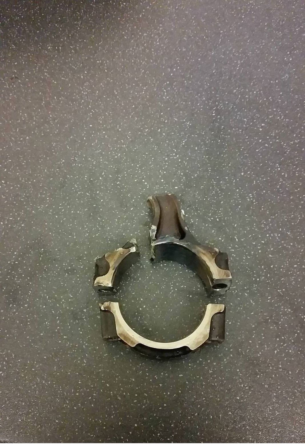

Unfortunately I think its done a bit too much damage to salvage the engine lol. Considering I drove about 3 miles back home on it with chunks of con rod flying around the engine haha
