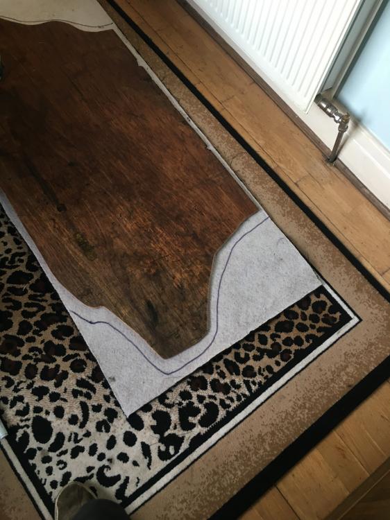

HarrisonS Posted February 14, 2018 Author Posted February 14, 2018 (edited) So after finally getting round to making a floor for the back it came out pretty well. Some gaps are larger then I wanted but I’m more than happy with it it’s much nicer. Also got some black harnesses instead of the blue ones. It wasnt too difficult either it was just cut around some cardboard, cut that shape then out of wood and stick carpet to it. I also cut out some holes for my 6x9s because the little 4 inch speakers in the front just weren’t enough. Oh and I also got some glanza Rear Plastics to make the back look nicer. All I need now is the glanza door cards and then I’m happy with the interior And I’ll leave you with a couple of pictures of my car after I’d given it a quick wash. Edited February 17, 2018 by HarrisonS

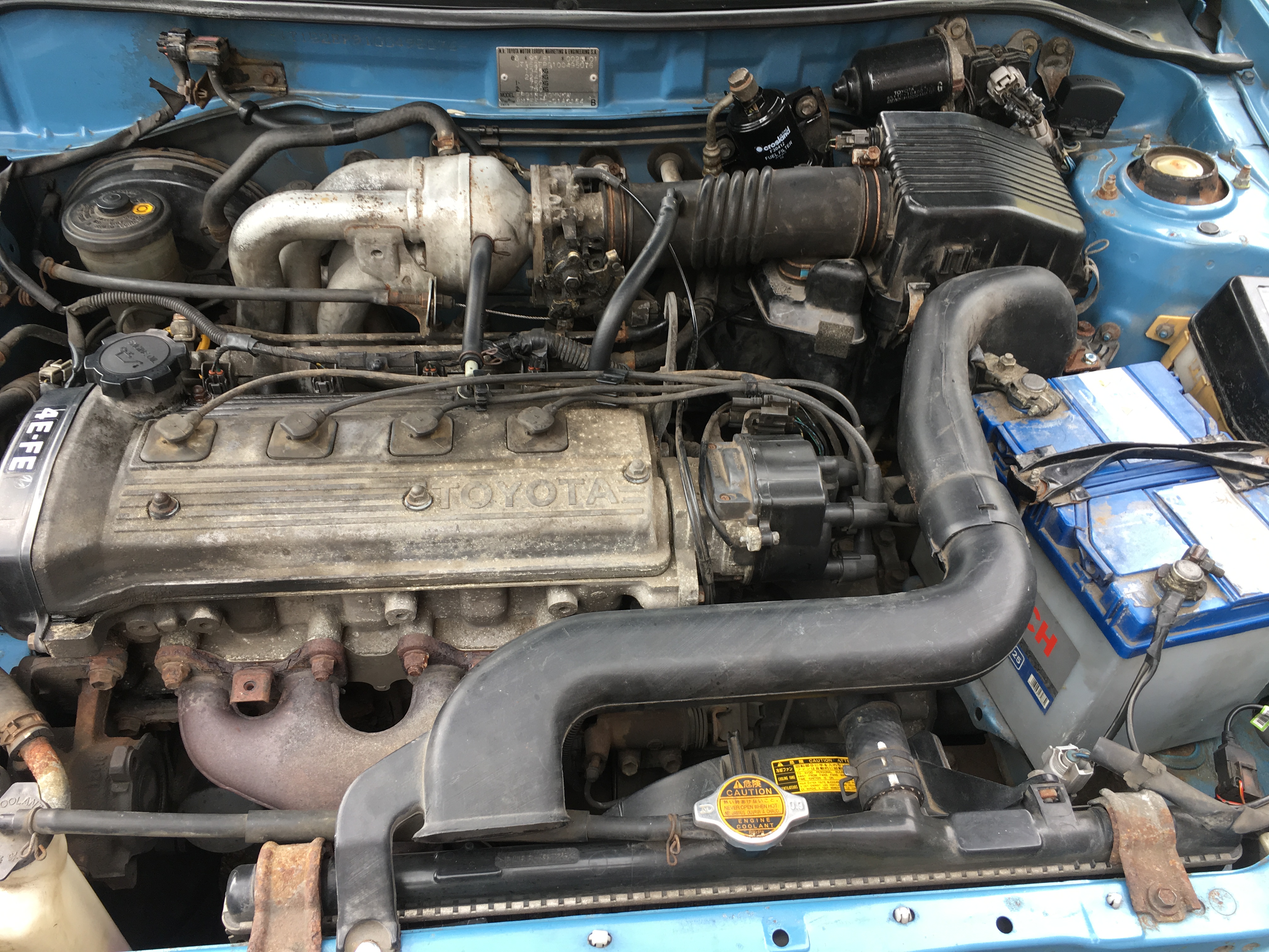

HarrisonS Posted May 1, 2018 Author Posted May 1, 2018 (edited) So a quick update. My little starlet has become quite unhappy. After 137,000 miles, oil consumption has now become an issue. I think to resolve this I'm gonna try and find a good condition 4efe to replace it temporarily and while my current engine is out i'll give it a bit of an overhaul (new piston rings, valve seals, headgasket etc) so that it can go back in happy and healthy and ready for hopefully a turbo. Before the engine gets rebuilt there is a couple of things I would like to do first. I'm finally gonna get rid of the awful alloys on the car and replace them with something a little nicer but also something a bit different. I'm also gonna modify some polo 6n/6n2 coilovers to fit since 3 of my shocks are leaking and for the shocks I want its cheaper to get some polo coilovers (if I decide I dislike the polo coilovers they wont be staying and shocks will just be getting replaced instead). I also want to refresh the drums at the back and I will also be getting a rear anti-roll bar to solve that god awful understeer. I'm not too sure when all this will be happening as my insurance is due this month so I'm going to be skint for a little while but I'll keep this updated. Edited May 1, 2018 by HarrisonS

HarrisonS Posted May 12, 2018 Author Posted May 12, 2018 So I did a little thinking around the oil usage issue and I think it’s not as bad as I thought. After realising that for the oil that I’m losing there should be at least some smoke but there’s none. So I decided to investigate further and it seems like the rear main seal? has started leaking and that’s where my oil is going. There’s never any oil on the floor where I park but being the rear main seal? I can only assume it would only be leaking when the engine is running. It would also explain my juddery starts with oil getting on the clutch as well (I just assumed release bearing). This is good news though because lightweight flywheel and glanza clutch are on the to do list anyway so I can replace it at the same time. Modifications wise not too much has been done. I fitted some yellow corolla injectors with all new seals as the old ones had pretty much fallen apart. I also put the stock airbox back on since my cars been feeling slower ever since the eBay induction kits went on. Finally I also put a tow hook/loop thing on the front in case I ever need towing to avoid having to take the splitter off to get to the originals

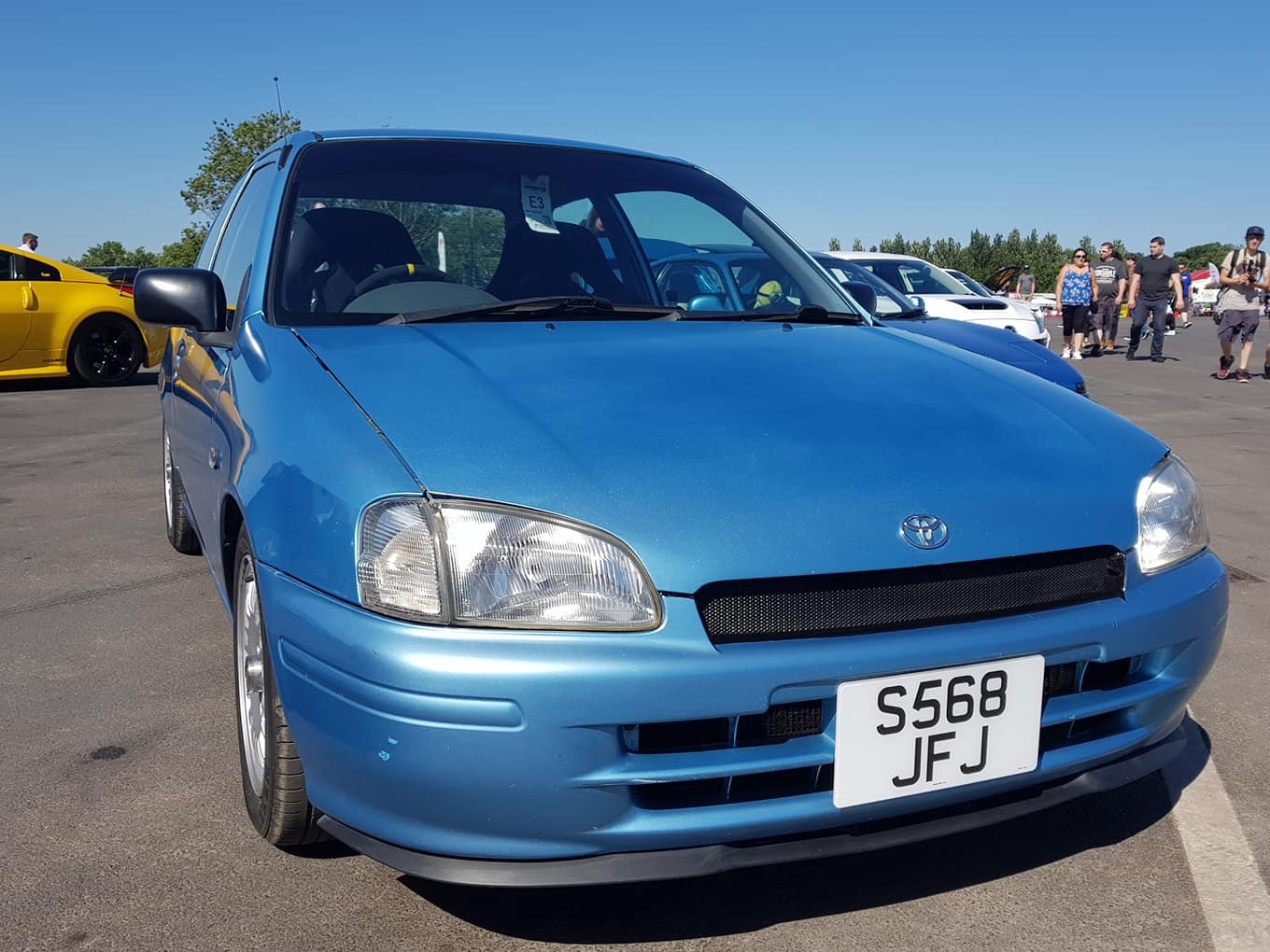

HarrisonS Posted June 29, 2018 Author Posted June 29, 2018 So the new wheels got painted and fitted and I finally levelled my car out so it’s no longer nose diving. Also got rid of any tint on my lights. I don’t know whether it’s the tyres I got put on the wheels or that fact that it’s no longer nose diving but the car feels so much better to drive and goes round corners so much nicer now. Enough chat anyway here’s a couple of pics I took getting ready for Japfest Donnington
HarrisonS Posted June 30, 2018 Author Posted June 30, 2018 Had a great time camping at japfest donington and the event was great. Also got to show my car last minute after making friends with another starlet owner who turned out to be an admin at outlaw jap club. Anyways some picture
