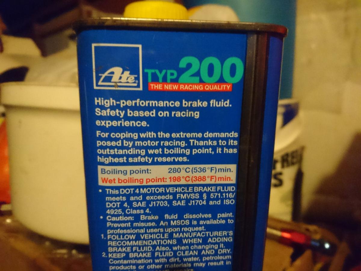

akyakapotter Posted May 1, 2017 Author Posted May 1, 2017 I have ebc yellow stuff in them it was like it on the way up to Silverstone almost feels like brake fade but not as I have to push the pedal then push further to make them work. I have decent high temp fluid in there. Quote

maddox710 Posted May 1, 2017 Posted May 1, 2017 Hmm I know ate super blue stuff is quite hyrdroscopic and needs changing often. It can cause vague brake feel Quote
akyakapotter Posted May 1, 2017 Author Posted May 1, 2017 Hmm I know ate super blue stuff is quite hyrdroscopic and needs changing often. It can cause vague brake feelI see could possibly be that but I've done hardly any millage on this stuff say 3k max. Quote

MR-2 Posted May 2, 2017 Posted May 2, 2017 Hmm I know ate super blue stuff is quite hyrdroscopic and needs changing often. It can cause vague brake feelHad that fluid several years on my MR2, never had problems or changed... Quote
maddox710 Posted May 2, 2017 Posted May 2, 2017 It also has one of the lowest boiling points of any performance based brake fluid Quote
