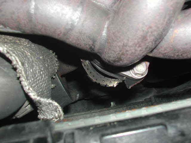

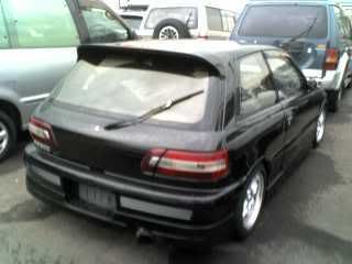

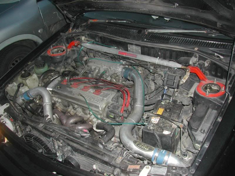

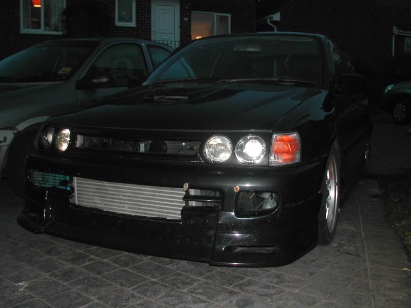

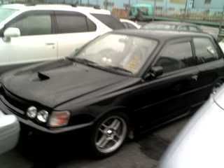

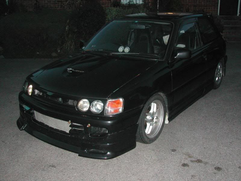

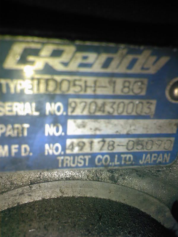

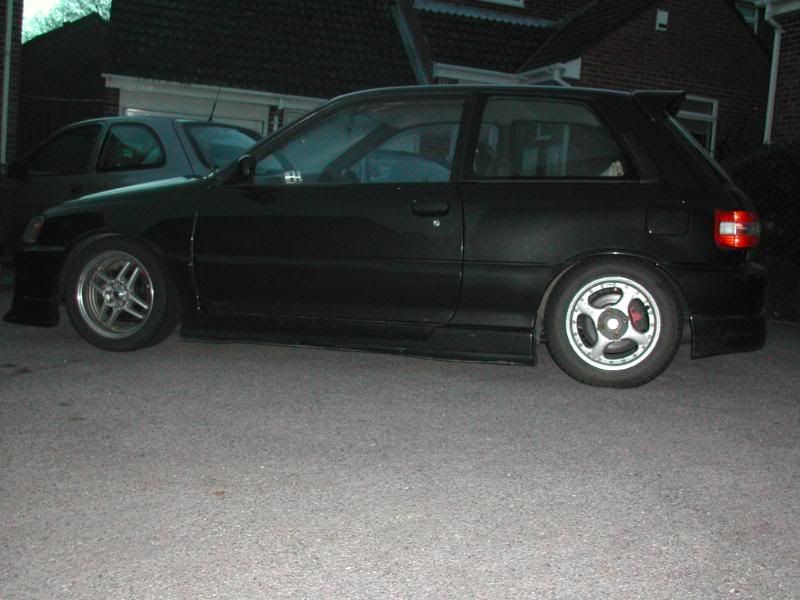

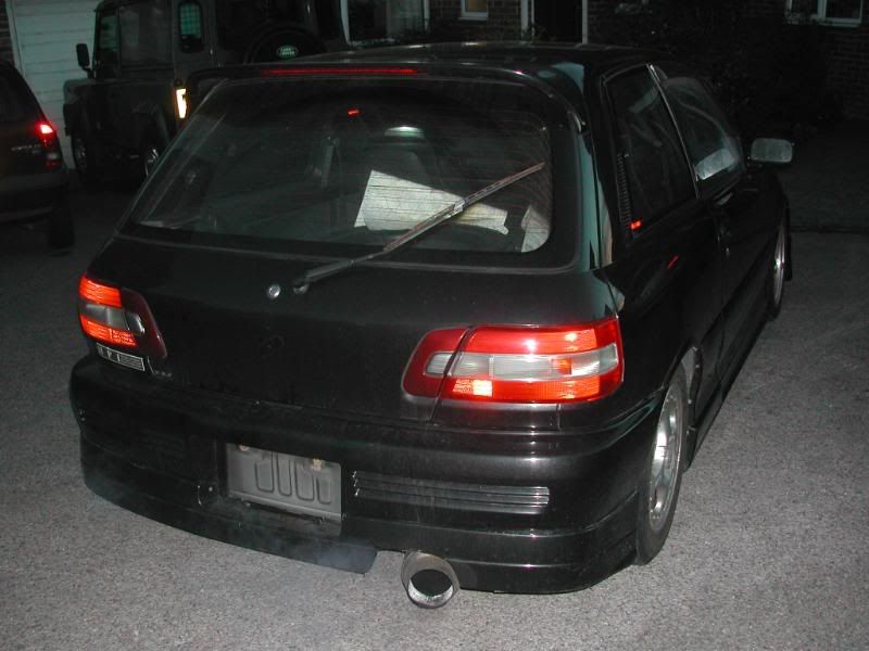

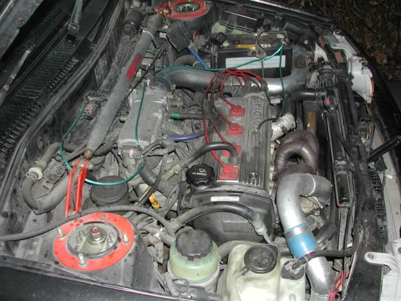

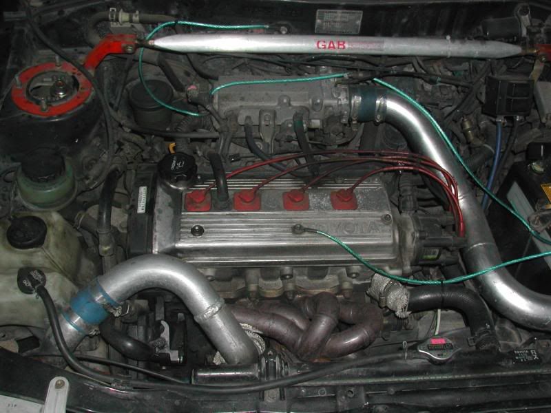

siilversurfer Posted April 5, 2008 Posted April 5, 2008 Ok so here is NO.2 StarletPics from Japanand sat at the docs in tokyo The apparent specs are:5E APEX POWER FCH.R.F V300 turbine KitTurbine TRUST TD05-16GInjector 600ccRacing Fuel PumpHi-Profile Camshaft in 272 / ex 272Racing IntercoolerGreddy Oil Cooler kitGreddy relocation KitBoost ControllerRacing Wastegate SARDStainless Exhaust ManifoldMuffler Height Adjustable Suspension GABLSD TRD 2WAY Interior Gauges BoostExhaust tempA/F Oversized forged pistonConnecting rodEngine head full modifiedBlow off valveAPEX ECVboost selectable 1.0kg, 1.3kg, 1.5kg MAX 1.8kg So i currently have a 270bhp ep82 so i know what they are like but this thing is just crazy it seems to be on full boost at around 4ish@1.2 which seems faster than my current starlet but then it hits around 6k and it takes off to 1.8bar I've never experienced so much power, The power was quoted at 250bhp but Id say its way over that, Who knows have to get it down the dyno.Upon inspecting the car I've found that some of the parts are correct but it isnt a 5E its still a 4E and the turbo isnt a TRUST TD05-16G BUT A TRUST TD05-18G with a little bit of mesh over the mouth, its massive in fact to big Ok so here are the uk pix, it hasnt been washed in 5 months, there are a few things to sort out but it still looks ok Anyone guess what this is?Then i came across a litle problemHad the MOT done went through no probs, but noticed a problem spooling up, checked it out and found this Hmm i guess its in need of a tougher gasket So im still trying to find out the exact specs I've just found out its actually a H.R.F car Turbo: my supposed 16G which is actually an 18GApex ECVGReddy Filter Relocation KitGAB CoiloversSard WGStickers that might give something away And thats project NO.2 unfortunatly its not on the road yet as im still sorting out the docs Quote

siilversurfer Posted April 19, 2008 Author Posted April 19, 2008 Not long to go now, I've managed to sort out the gasket problem, Fitted one from a omega with a bit of modding :angry: got the Plate and tyres on the way atm then on the road sometime nextweek ;) Also did a DB test with a meter it hit 92DB @4.5 with the ECV and 101.5 Without so good thing it has the ECV or no tracktime for me Quote
siilversurfer Posted April 23, 2008 Author Posted April 23, 2008 Ok so the car is running now and I've had my first problem Earlier today when i accelerated it kept cutting out after a few seconds, Thought it was the tank so i filled it up and it was fine, looks like i need a surge tank or dont let it drop below 1/2 way Been driving it quite a bit trying to get use to it, extremly difficult to control, im pretty sure it was a Drag starlet due to the size of the turbo the only chassis mods it has is coilovers which are rock solid and it not running a DV, absolutly insane amounts of grip wont spin in any gear but it hardly spools untill the end of 2nd :confused: torque steer is insane its hard to keep the back end in line (Snow tyres dont help )Anyway i am going for a Dyno at Triton Motorsport in bournemouth on 3rd of may which is a saturday, not sure on the time yet but will put it up when i do but if anyone wants to comedown or go on the Dyno they are more than welcome Quote
