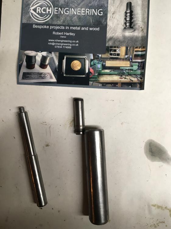

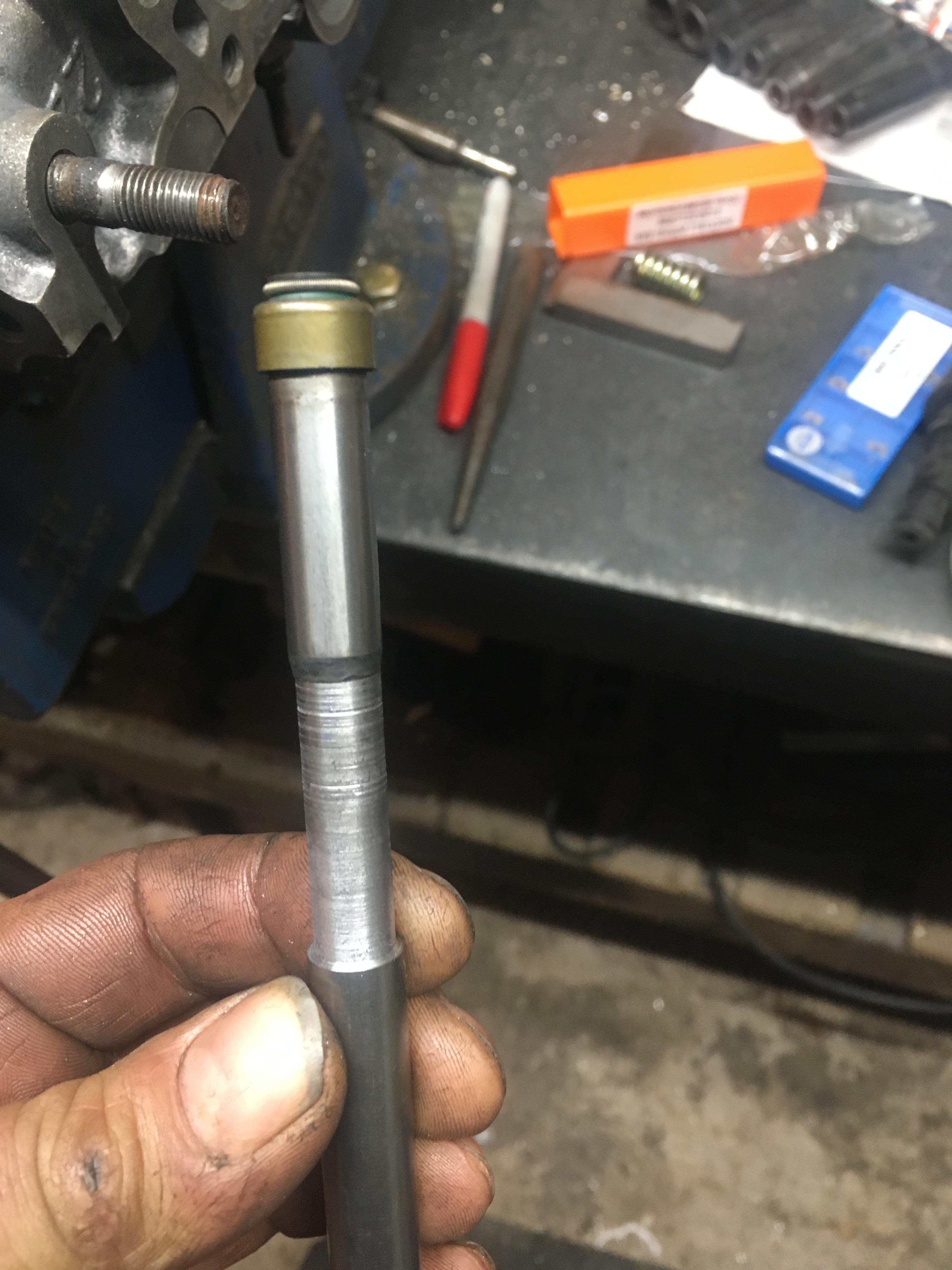

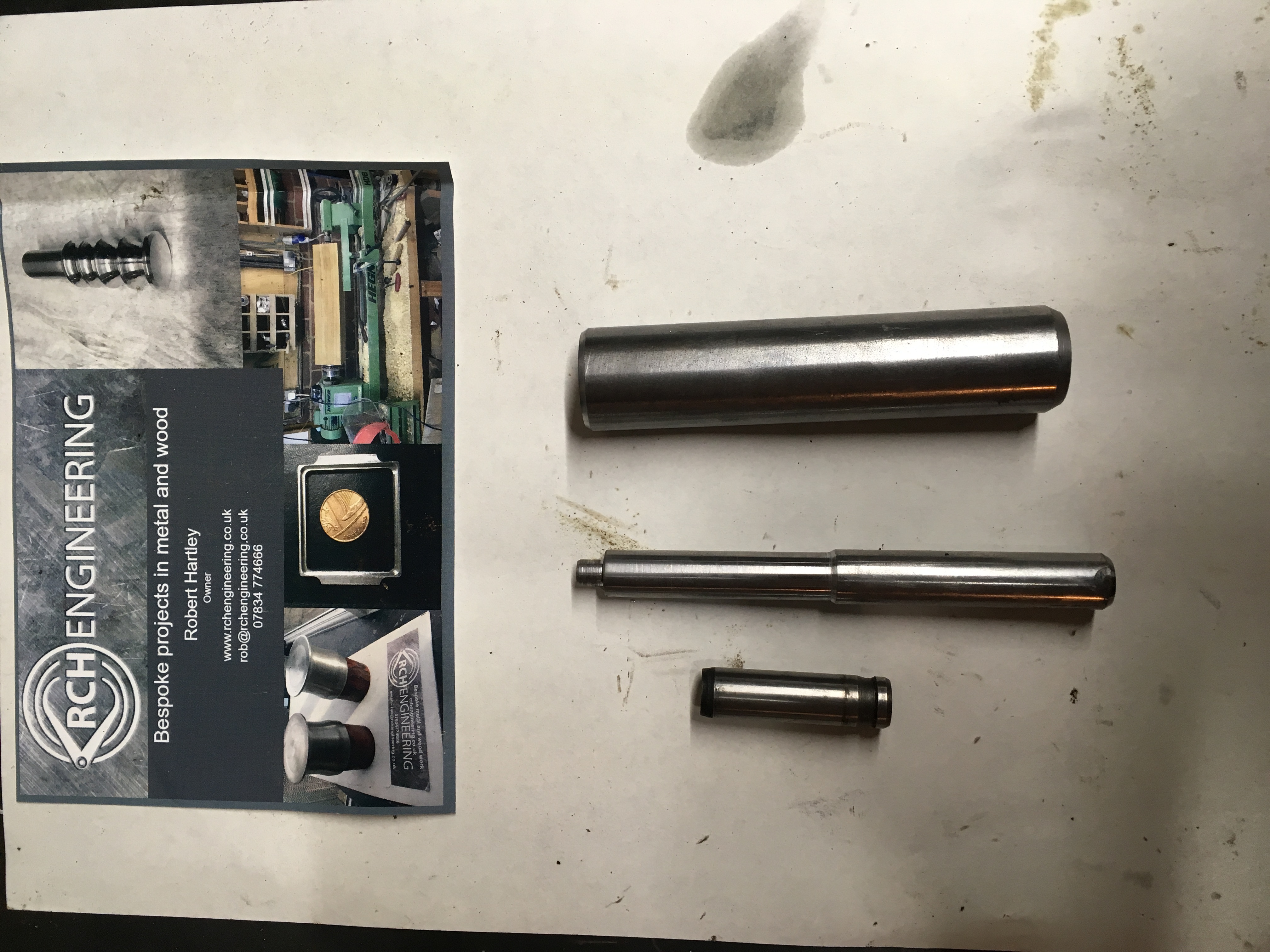

Rob H@RCH Engineering Posted February 21, 2018 Posted February 21, 2018 Your after something like this then Quote
5e colin Posted February 22, 2018 Author Posted February 22, 2018 Yes indeed rob that's it where did you get yours or is it d.I.y ? Quote

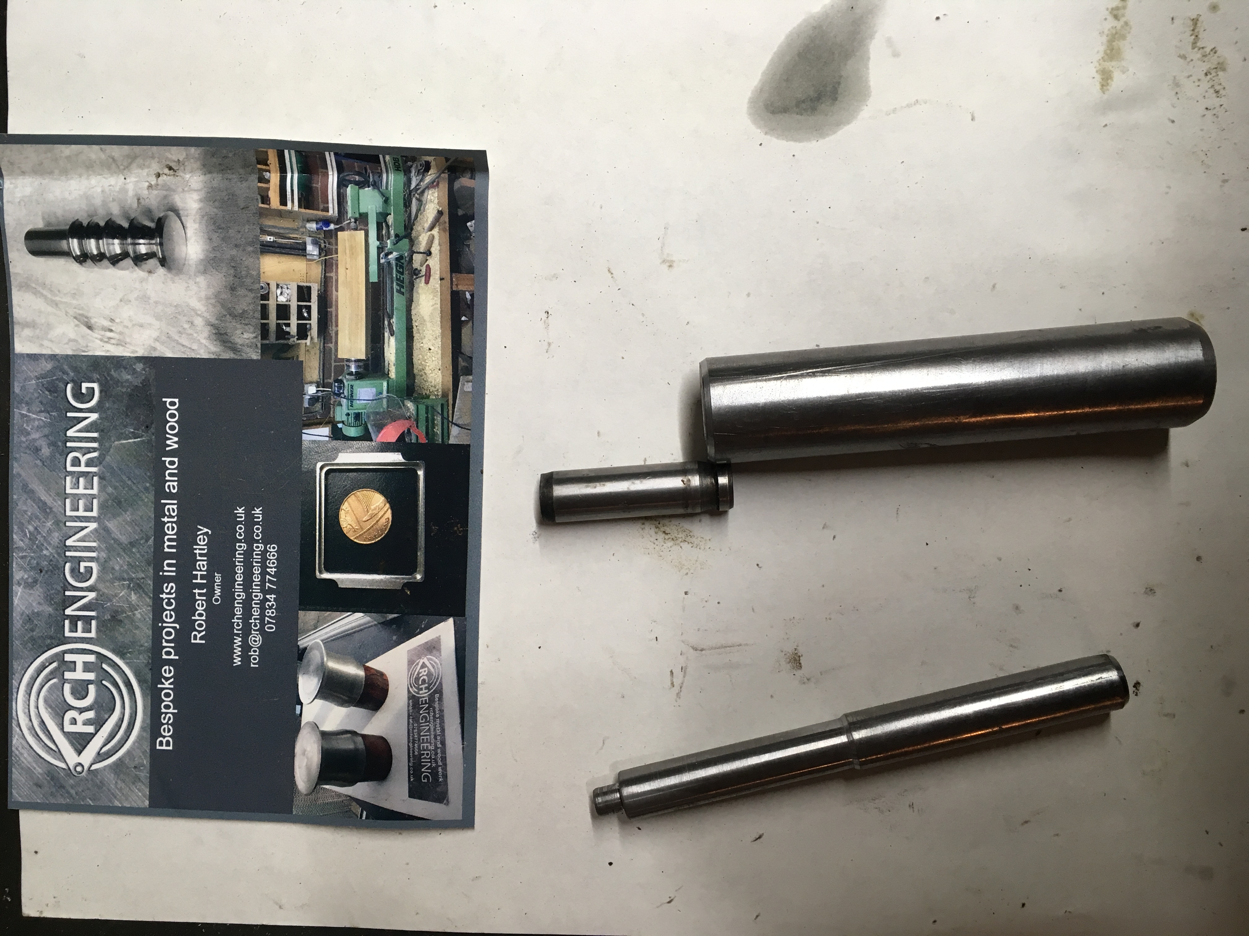

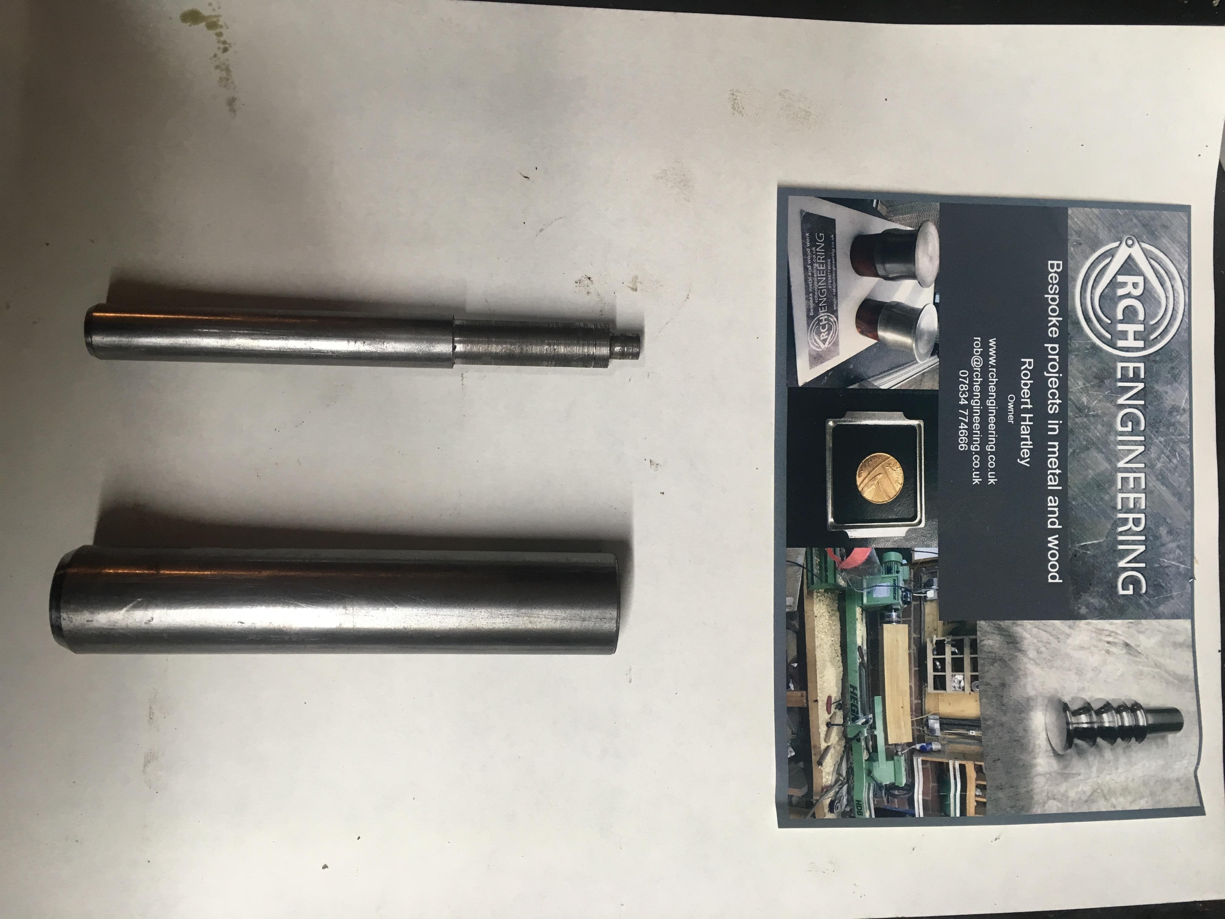

Rob H@RCH Engineering Posted February 22, 2018 Posted February 22, 2018 Its a diy one, I saw this post and thought I make one, I’m going to do one thats a depth stop for putting em in with too if needed Quote

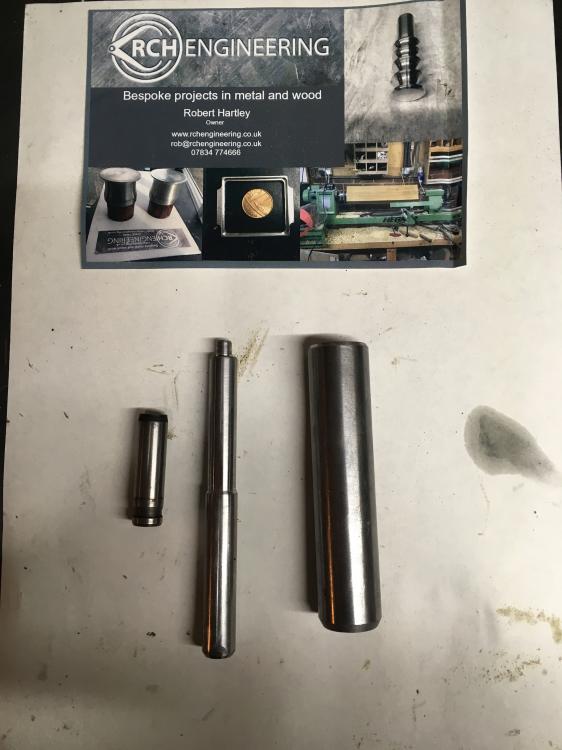

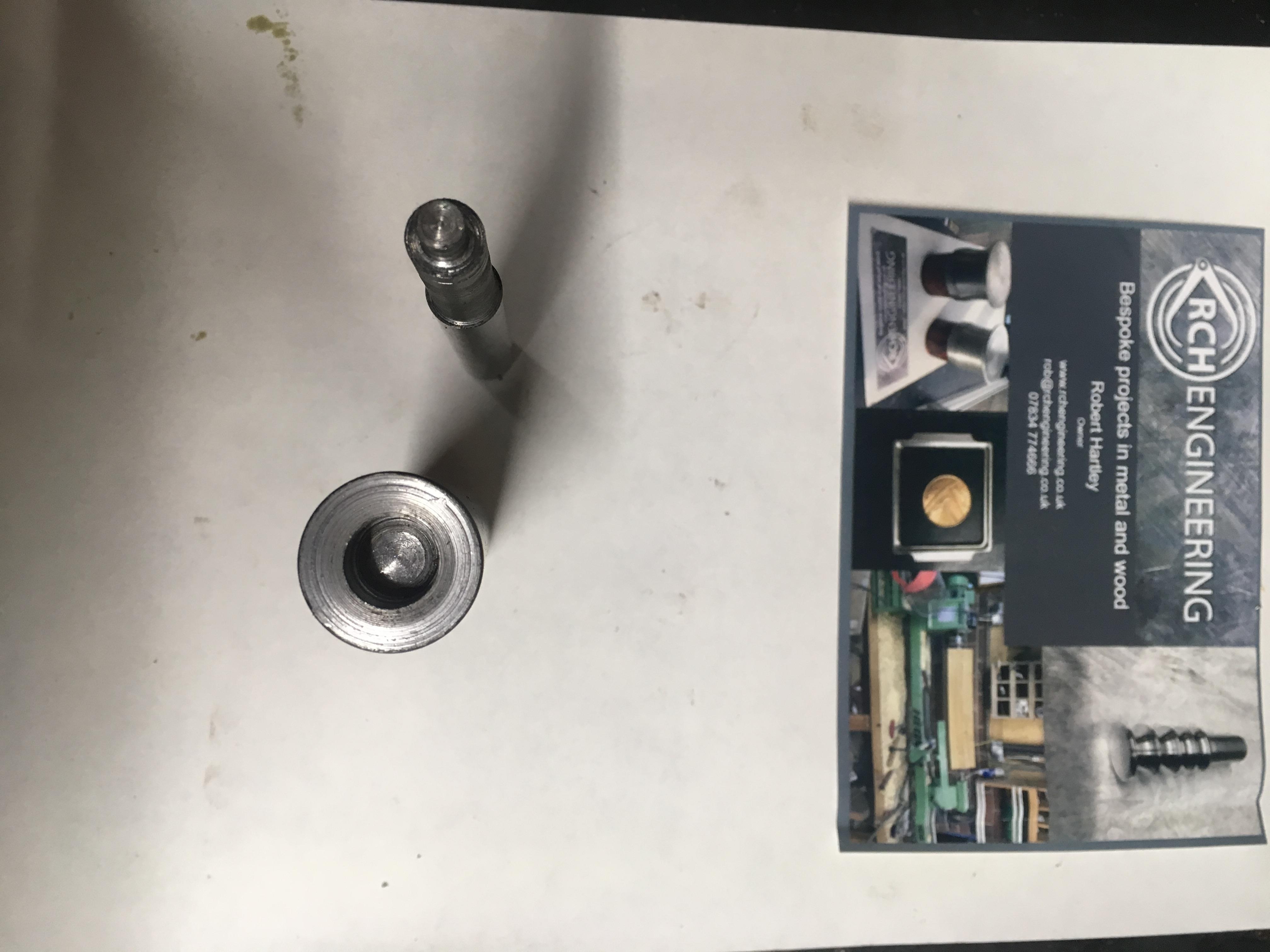

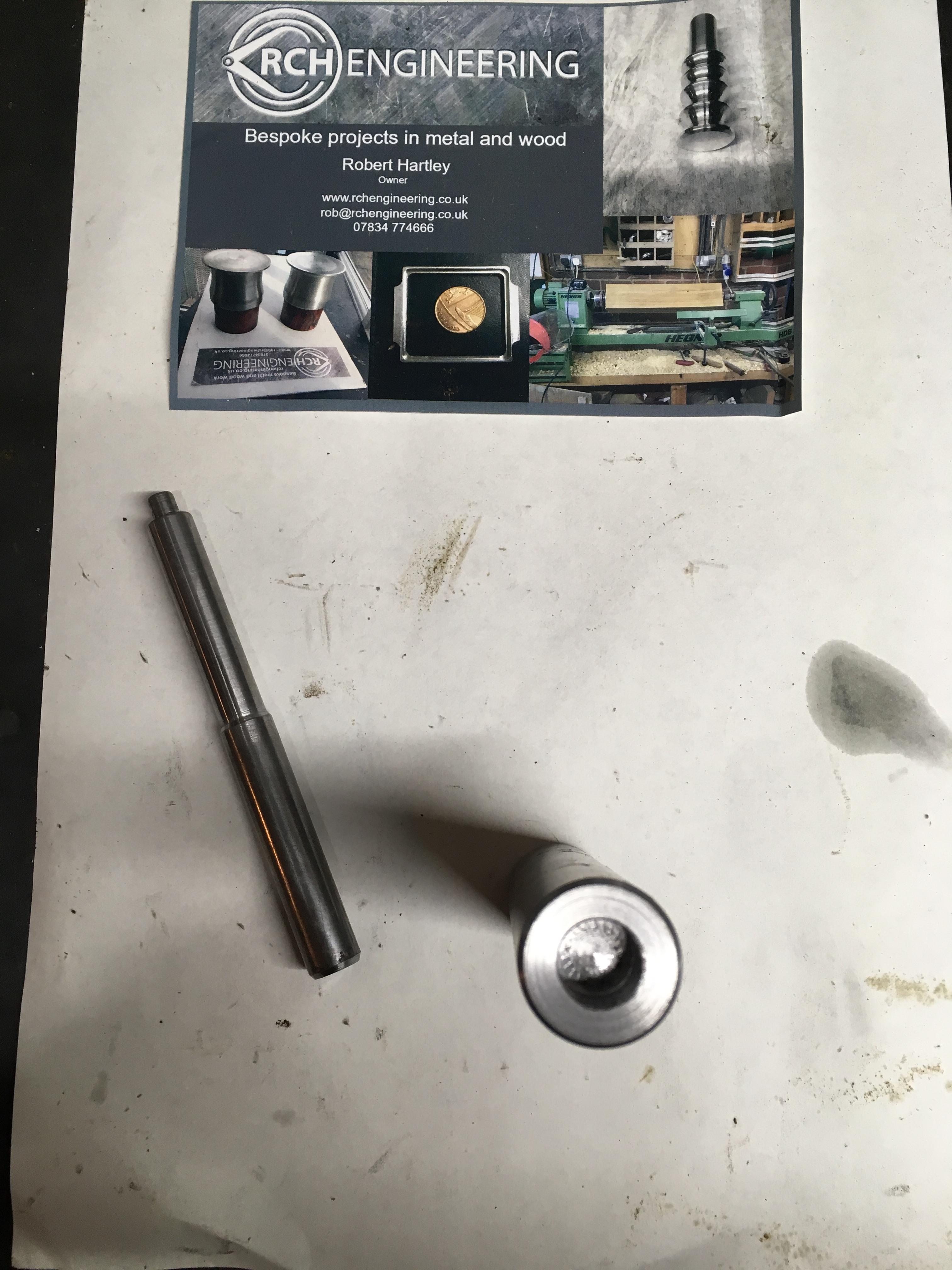

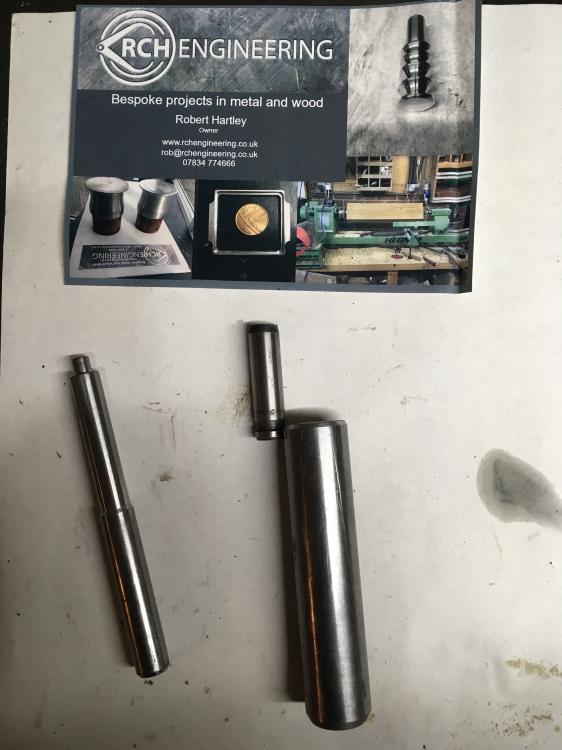

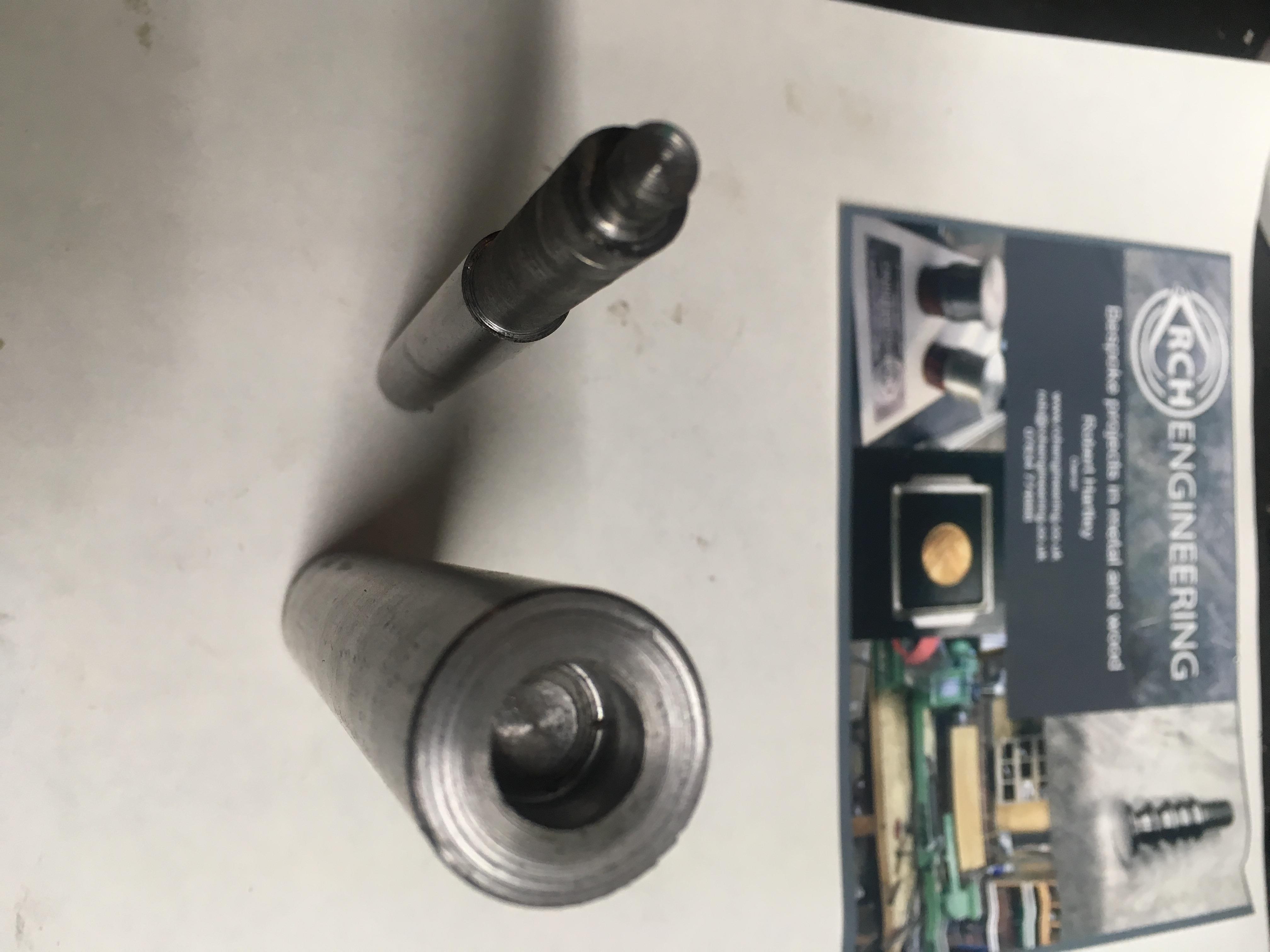

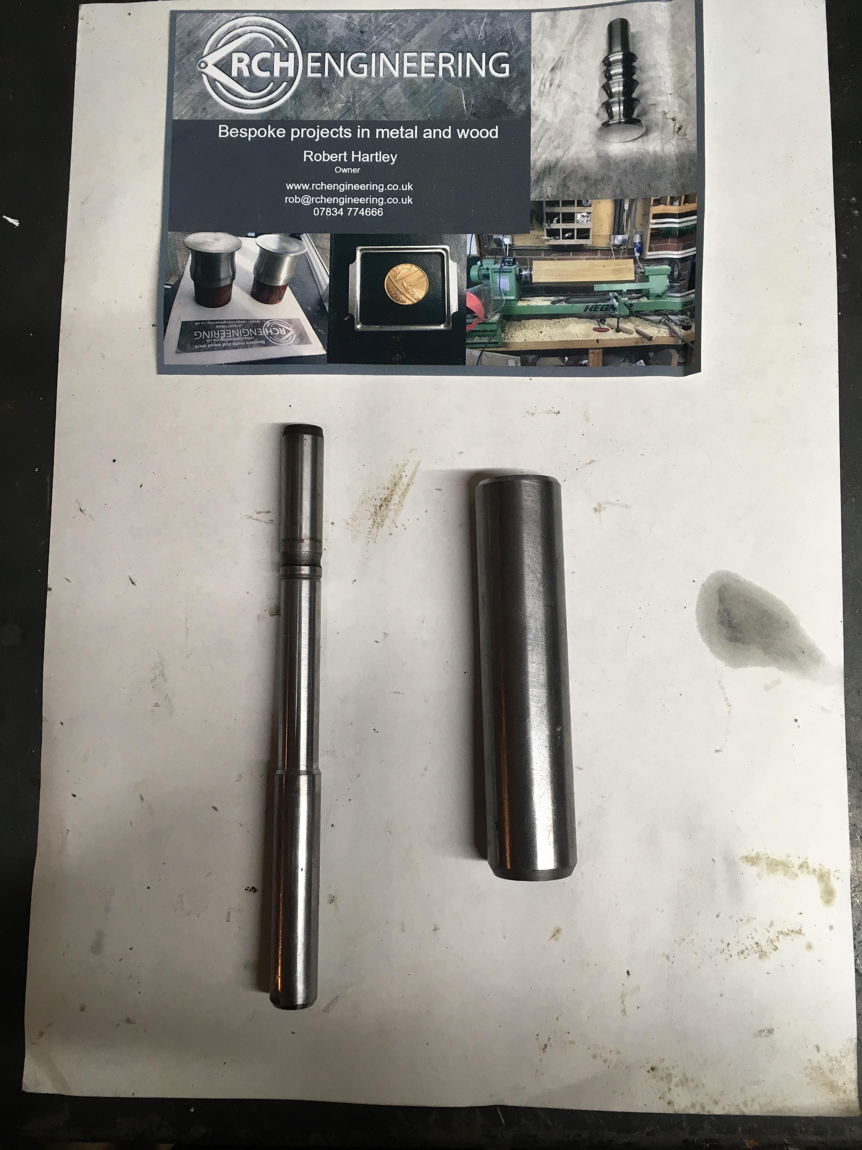

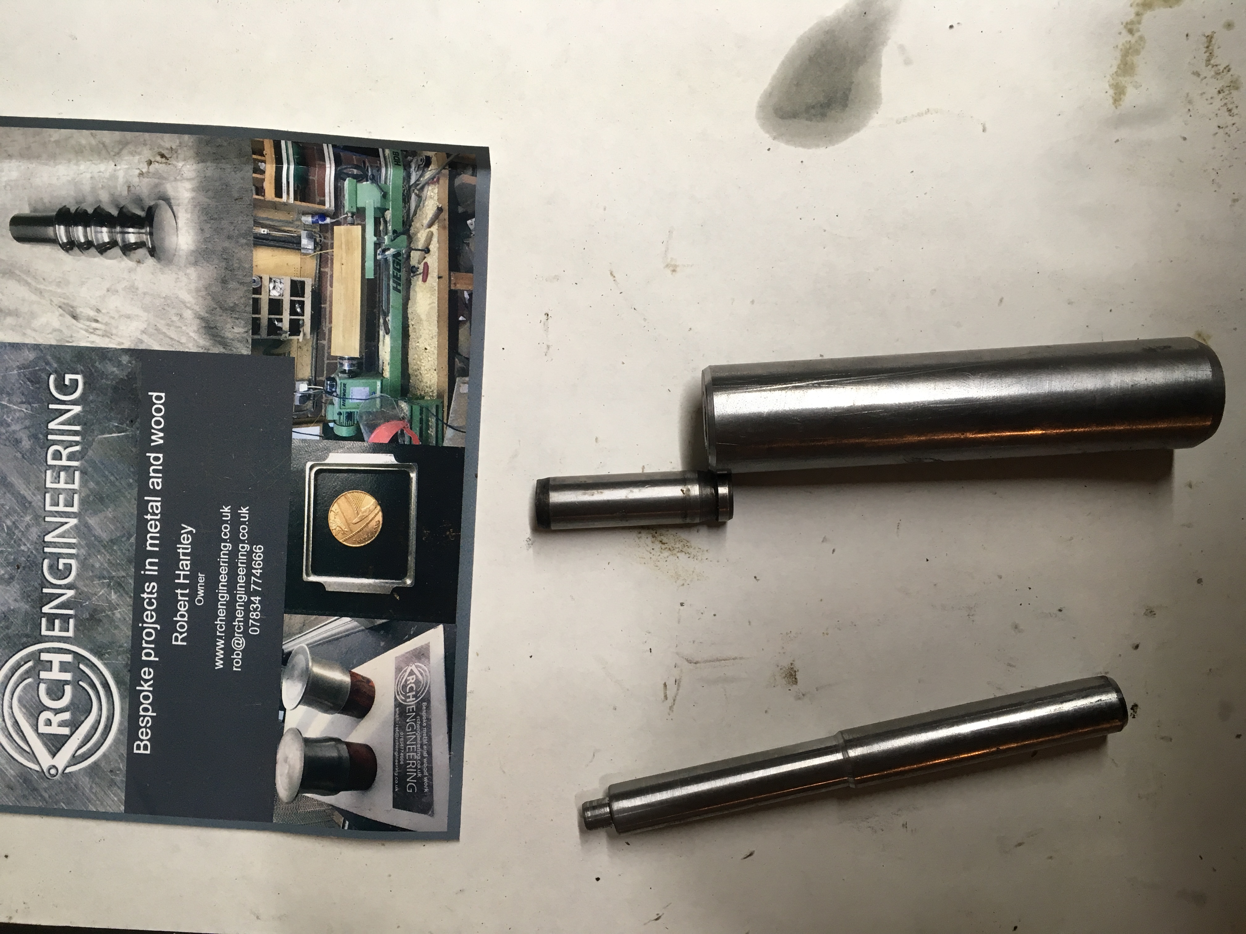

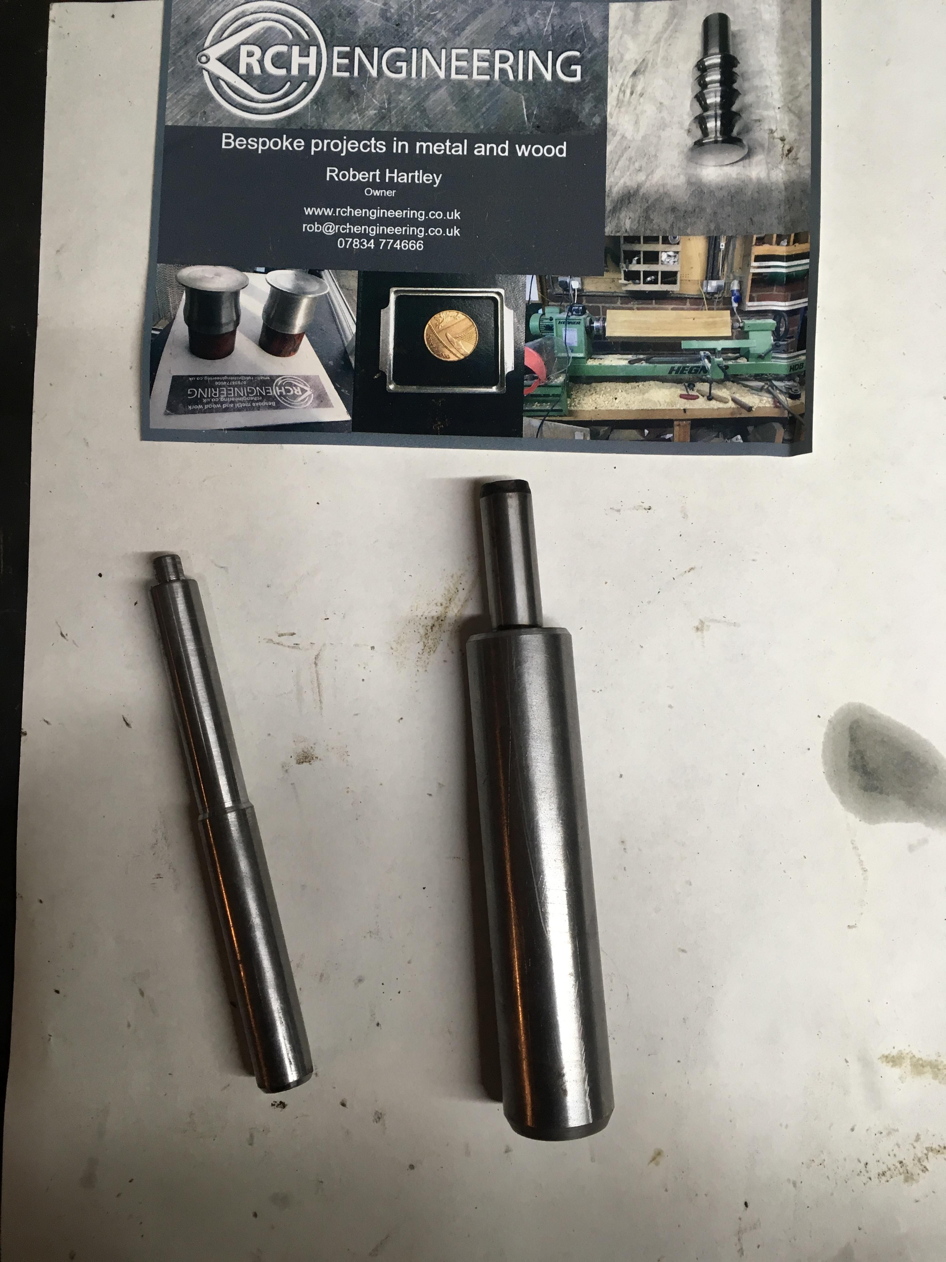

Rob H@RCH Engineering Posted February 22, 2018 Posted February 22, 2018 There ya go a removal tool and setting tool to get them all to the correct depth Quote
5e colin Posted February 22, 2018 Author Posted February 22, 2018 Make me 1 please I will buy it of you think you could make a few as plenty would do there own guides Quote
Rob H@RCH Engineering Posted February 22, 2018 Posted February 22, 2018 Thats not a problem mate, I’ll give you a tip too knock the out from the block side and in from the top, also leave the new gides in the freezer over night before fitting them! Pm me Quote
5e colin Posted February 23, 2018 Author Posted February 23, 2018 13 hours ago, Rob H said: Thats not a problem mate, I’ll give you a tip too knock the out from the block side and in from the top, also leave the new gides in the freezer over night before fitting them! Pm me Thanks for that And thanks for the freezer tip Quote

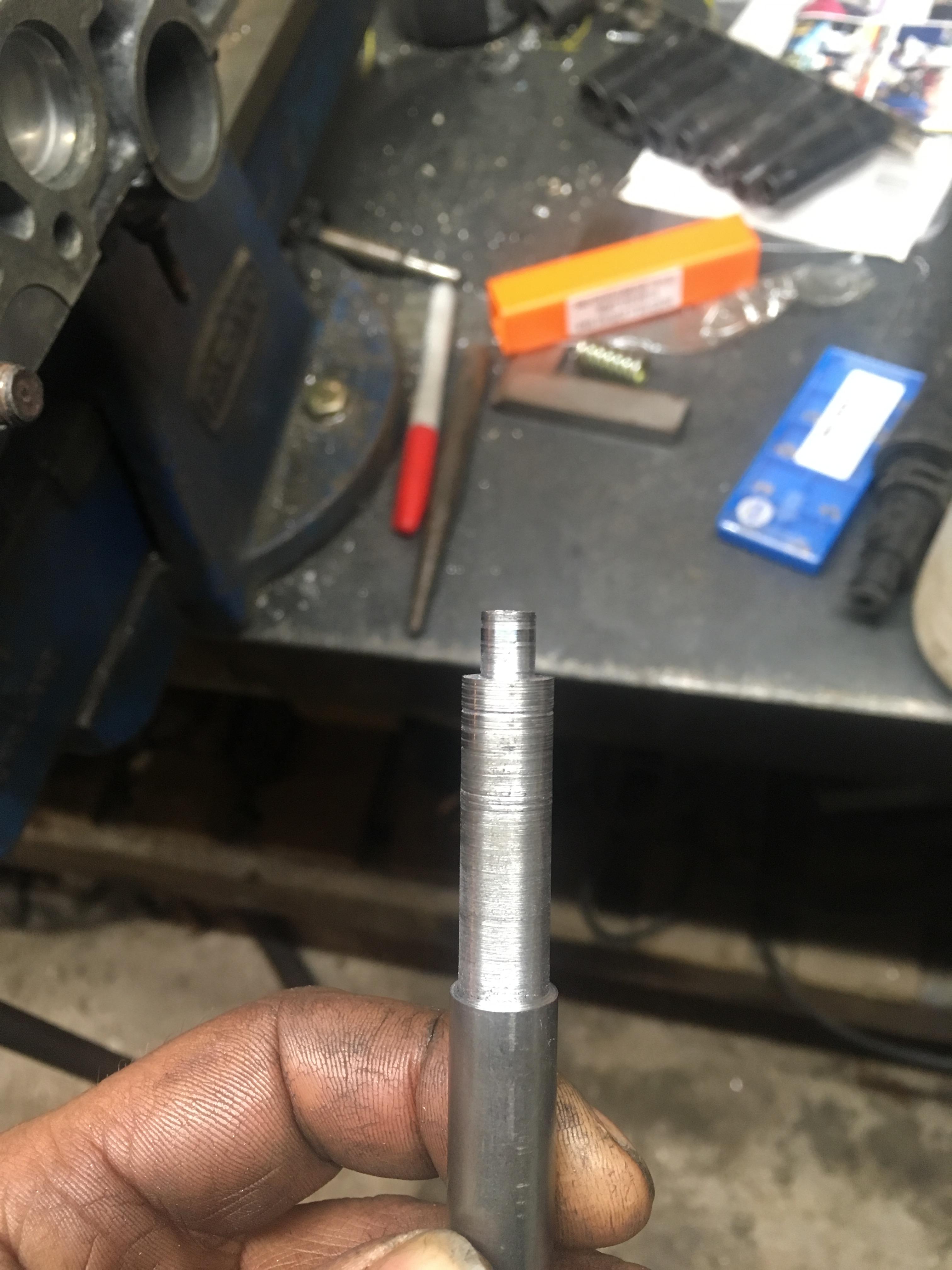

maddox710 Posted February 23, 2018 Posted February 23, 2018 Also valve stem seal tool, not valve guide :p Quote
Rob H@RCH Engineering Posted February 23, 2018 Posted February 23, 2018 Cheers, the tool for fitting the guides also doubles up as a stem seal fitter too perfect! Quote
