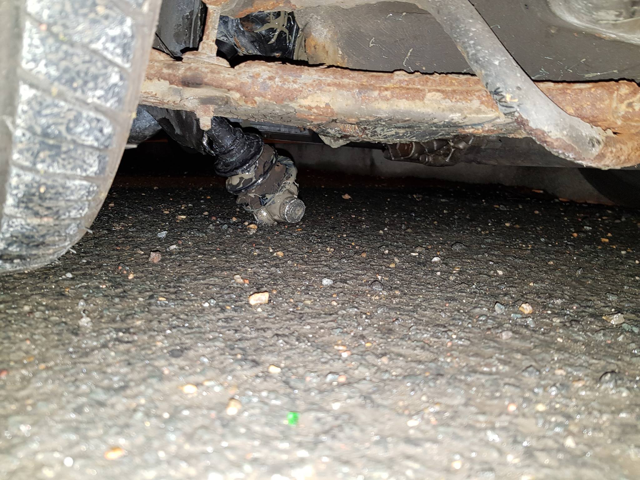

brett-davey Posted January 16, 2018 Author Posted January 16, 2018 Thanks for your reply appreciate any help you can offer me. I will attach some photos of whats happened so you can see. All I can remember is an extremey loud bang then no drive... luckily it happend 50 metres away from my flat so just about rolled to a stop outside. Thanks Quote
brett-davey Posted January 16, 2018 Author Posted January 16, 2018 Here's a few pictures of the aftermath. Could it have done more damage? I was a very loud bang just hoping its not to serious. Its not running an LSD but is running a fair amount of power so not sure if that's linked to this. Pretty sure it was just hitting the bump very hard in the dark. Will check out the facebook pages, thanks for the info. Thanks. Quote

Calum122 Posted January 17, 2018 Posted January 17, 2018 See I know nothing of the part of the drive train, but this is why I wanted an image. Those spiders are pressed it seriously hard. By the looks of it, the spider, whilst now unusable, is still intact. So if that's still intact. then it would have been the thing that is held in by that broke, not the driveshaft. Although you will want a new spider. Unfortunately, this doesn't look like a thing that simply happens overnight. There probably would have been some sort of knocking noise or play before this occurred. You can see from the state of the lower arms that the suspension units need attention, so it could have been just neglect that has led this failure. I would concede wear and tear but this seems extreme. I guess your best bet is to get it jacked up, wheels and hubs off to investigate. If you can do the investigation yourself, you can figure out what has failed, and thus save yourself time/money having someone else do it. Quote
maerijn Posted January 17, 2018 Posted January 17, 2018 (edited) Are you sure they are pressed in? As far as I know the spiders are only held in the cup by the rubber and they cannot come out unless you take off the hub or cross arms? I used to pull them out and push them back in all the time when I would remove and install an engine. I would leave the cups in the gearbox to save the hassle of draining the gearbox oil But still, only way for them to come out in a moving car that I could think of is a broken cup, or something else is broken/loose, or the drive shaft must have been at an extreme angle, perhaps the car is lowered? Edited January 17, 2018 by maerijn Quote

Gary91 Posted January 17, 2018 Posted January 17, 2018 The grease looks emulsified so I would say the boot has been split for awhile and waters been in there but that doesn't explain why the shaft came out of the cup. I agree with what maerijn suggested as to why it it happened. Also looks like the drop link is bent. Post up a wanted thread for a driveshaft, someone should have one lying around. Quote
