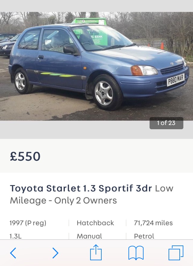

Slicster Posted March 25, 2018 Posted March 25, 2018 Hello looking at buying a starlet as my first car. Found one with decent mileage, however did MOT history check and these were advisories: Offside Windscreen has damage to an area less than a 10mm circle within zone 'A' (8.3.1a) Front coil spring corroded O/S and N/S (2.4.C.1b) Offside Rear coil spring corroded (2.4.C.1b) Central Front Exhaust has a minor leak of exhaust gases Slight leak at front to intermediate joint (not affecting emissions) (7.1.2) could someone please let me know if these are serious problems or easy cheap fixes. thanks Quote

mart1 Posted March 25, 2018 Posted March 25, 2018 Not really much to worry about with exhaust and springs, these are normally the first things that get removed when it comes to mods, just depends if you want to keep it standard but still not a big job or expensive to put new standard exhaust and springs on. Have a good look under the car for rust, old cars now plenty of rot boxes knocking about. Take your time go and look at more than one, good service history is a bonus, try and find a jem with low mileage, you be surprised they are about. Quote

Slicster Posted March 26, 2018 Author Posted March 26, 2018 3 hours ago, SKINY said: I've seen not even a year old BC coil over springs rusting, most of the cars I've had have have some degree off it, set of lowering springs is only 120£ Great wee cars 13 hours ago, burty said: mines at 150k needed a new fuel tank last year because of rust but its still fairly solid everywhere else other than that just general wear and tear 22 hours ago, mart1 said: Not really much to worry about with exhaust and springs, these are normally the first things that get removed when it comes to mods, just depends if you want to keep it standard but still not a big job or expensive to put new standard exhaust and springs on. Have a good look under the car for rust, old cars now plenty of rot boxes knocking about. Take your time go and look at more than one, good service history is a bonus, try and find a jem with low mileage, you be surprised they are about. Okay cheers guys, very helpful. Might take a look at that one at the weekend. I would be willing to buy a new exhaust and springs. So I should just check for any rust and find out when the timing belt was done? Quote
mart1 Posted March 26, 2018 Posted March 26, 2018 I've seen it on auto trader looks a nice motor, ring them up ask if there's any service history and has the cambelt ever been changed, if not it's around £200 to £300 for that job including parts, but if the belt was to snap they are a non interference engine so nothing to worry about if it was to snap. Test drive it see if it goes into gear fine and clutch seems OK, check that the engine gets up to good temperature halfway. For the money go for it. Quote

JDR33 Posted April 16, 2018 Posted April 16, 2018 (edited) Good solid little car I bought mine as a project last year for £260 as it needs a new clutch and tlc. easy to disassemble parts for mods if you go down that road. Like the guys say check for servicing and cam belt change. I wouldn't pay 550 for it though I'd offer 350-400 because of the springs. There's plenty of them around anyway mileage isn't an issue long as it's been looked after. Edited April 16, 2018 by JDR33 Spelling error Quote
