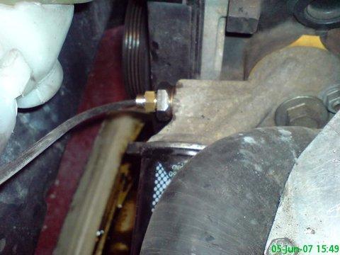

at the weekend me and a friend wired up the guages which I had from my previous project and managed to fit one off the oil pressure switch with an extension, previously scanning the forums, over the other side by the oil filter housing there is a blanking bolt which I wanted to use for the oil temp.
on removal of the bolt it looks like I need some sort of adapter to fit the sensor into as it’s too small, I found a pic on here of where I mean.
I wondered if anyone could push me in the right direction to get hold of one.
picture is below, sorry for stealing it :0)

Thanks guys, I purchased one and is now waiting for me to whack it in.
