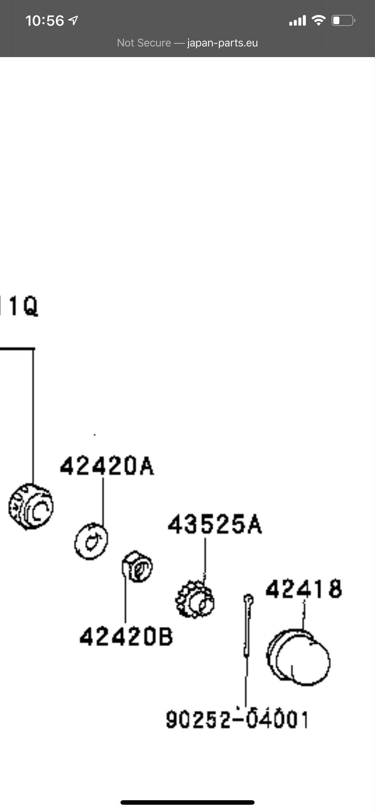

dazstarlet Posted October 8, 2019 Posted October 8, 2019 So today my UK EP91 failed it's MOT on 'excessive play in rear nearside wheel'. I've had an issue with this passenger side rear wheel since I inadvertently went over what was a large hole in the side of the road where a B road had collapsed away at the edge due to rain or something. I went over the hole with the rear wheel, a huge bang occured and there was some grinding noise for a few mins, before that went away. Noticed that rear end of car was a bit all over the place. Took the car to mechanic who only found the rear passenger wheel had excessive play in it. Everything else he said looked fine. He took the wheel off, and reassembled things with a new hub pin. The mechanic told me there needed to be some play in the wheel and he was not going to do the nut up too tight. But wheel play had diminished. I drove the car for a while but noticed after a short while things felt loose again going around corners etc. Took the car back to him and wheel play was back to being excessive again. We then repeated this whole cycle again one more time. So getting fed up I took the car to my local tyre fitter to check that the alloy wheel was not warped, as I thought that might be the root cause after the big pot hole I went over. Not sure if they checked the wheel tbh but they came right back to me and said 'it's the bearing'. So, both rear wheel bearings were subsequently replaced. I thought this had made things better, but then the bombshell today of a failed MOT on this same wheel. The very experienced old school mechanic I use is usually pretty darn good, but he has told me he thinks the 'younger' MOT guys are wrong to fail on this, as quoting him 'there has to be some play in an adjustble taper roller bearing' - but it's obviously worse than the other wheels hence the MOT fail. So other than confirming 100% the alloy wheel is not warped and not some sort of root cause I can't see with the bearing already replaced what else it can be..... Any idea guys? I've read some other forum posts on similar issues people have had, and some have replied that the hub nut must be really tight? Is there a torque setting anyone has used for similar issue I can give the mechanic, as he is convinced that if too tight then damage will occur. Any help appreciated as this issue is really beginning to get on my goat! Clearly the new rear bearings were money wasted and I don't want to waste anymore if I can help it Cheers. Quote

T-dog Posted October 10, 2019 Posted October 10, 2019 (edited) Are you putting the lock washer and split pin through it after tightening so It can’t undo ? Edited October 10, 2019 by T-dog Quote
